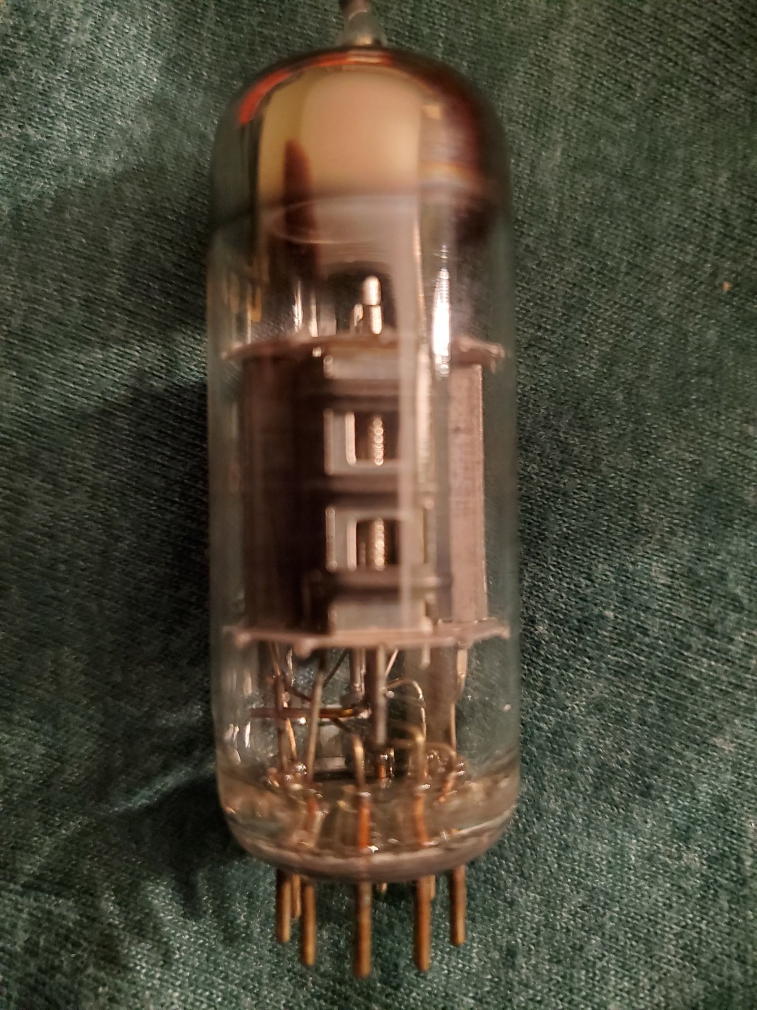

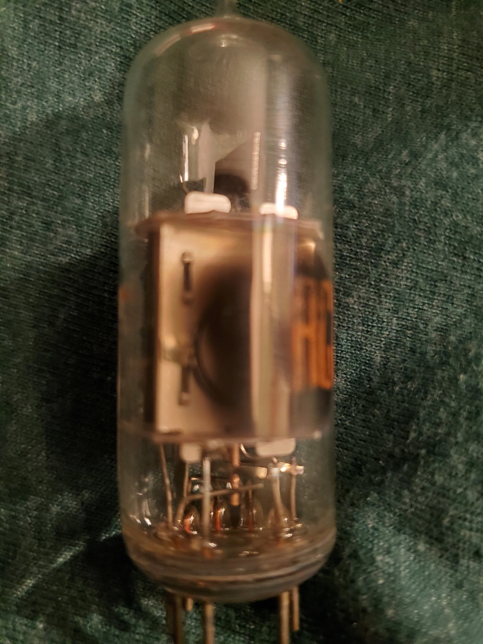

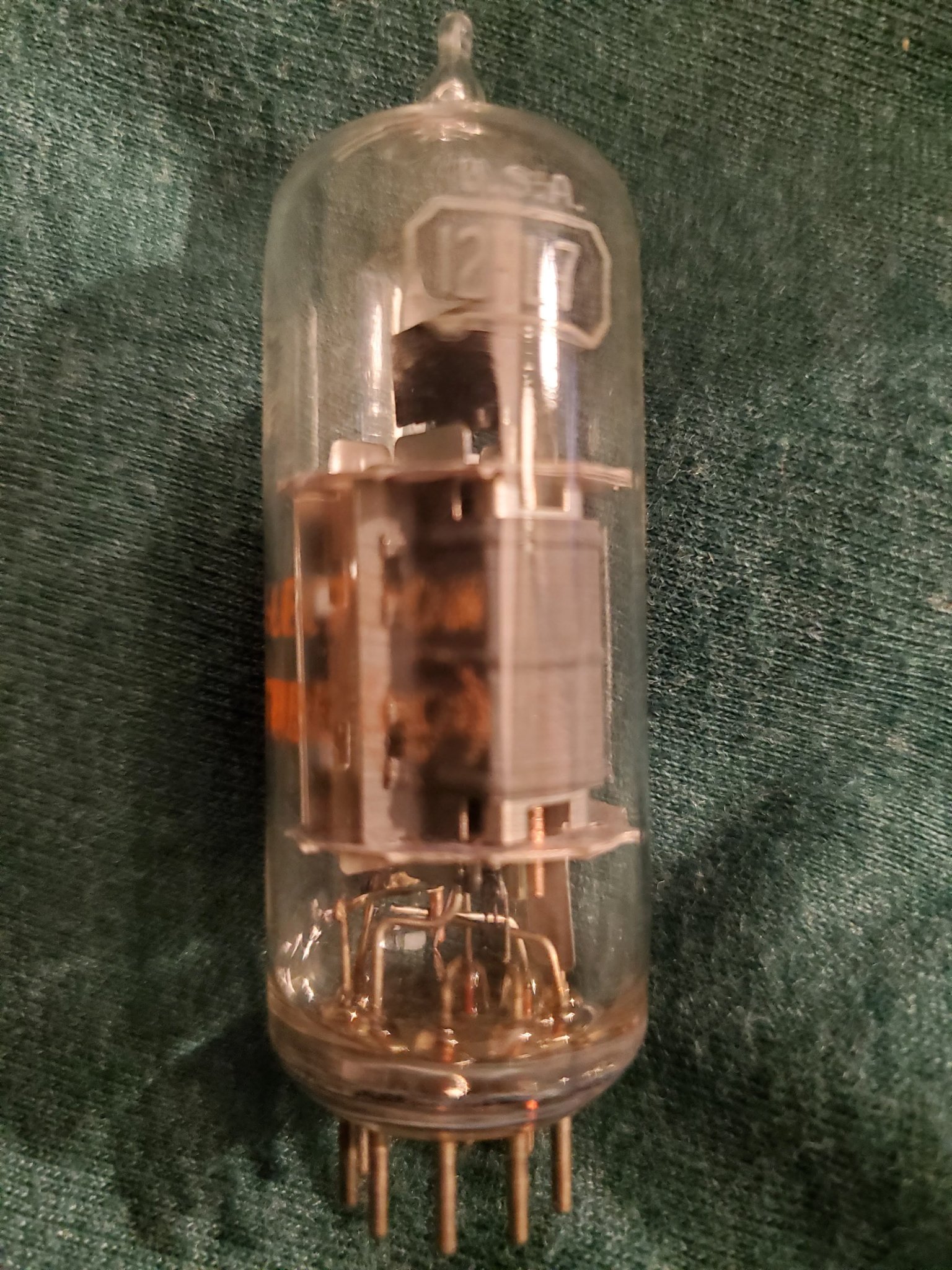

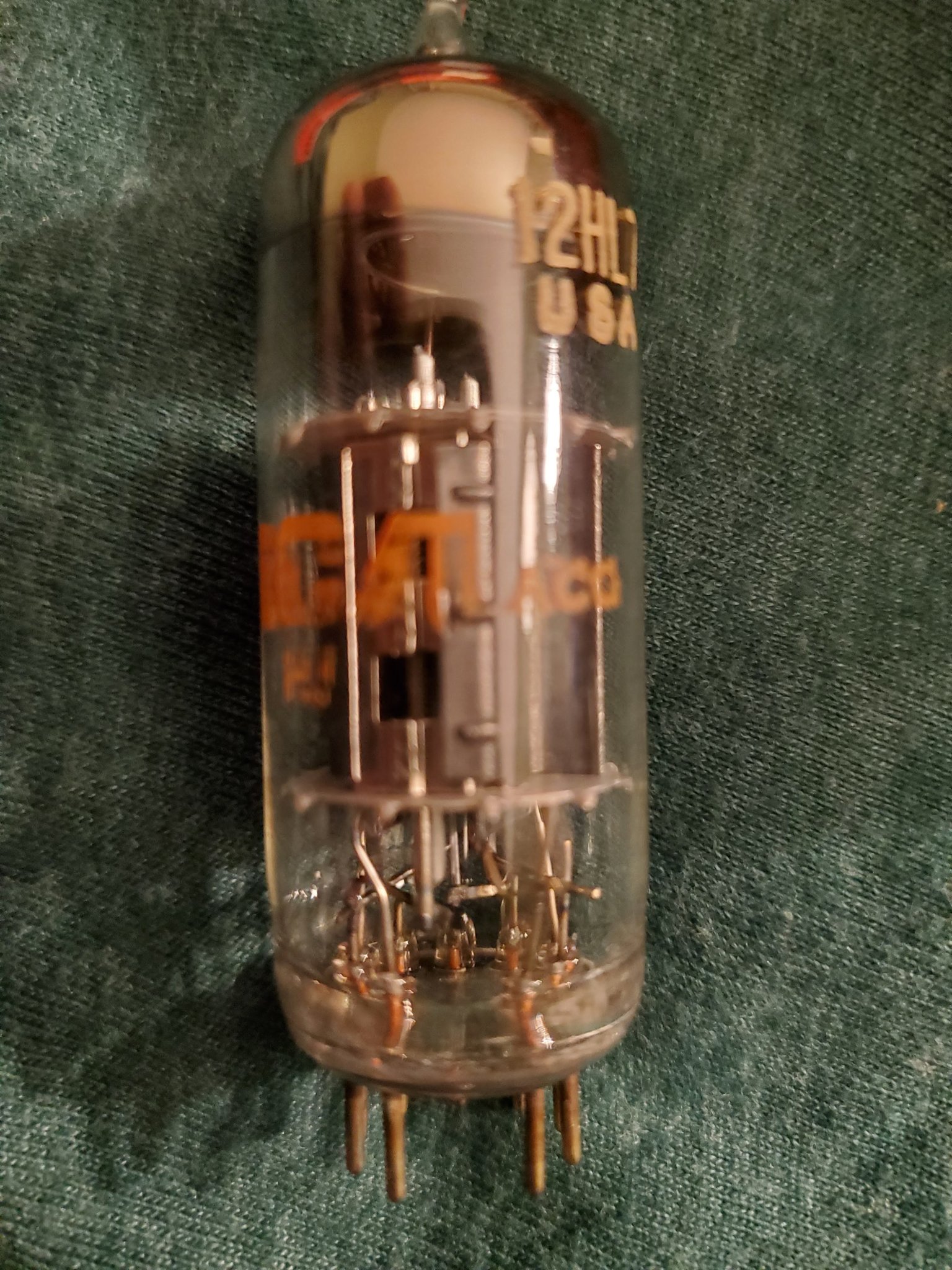

I'm not sure what those 'RCA 12HL7 with small guts' look like. So I took photos of two different RCA 12HL7 I have.
- The first two photos are of a 'clear top' RCA 12HL7 with slightly smaller guts.
- The last two photos are of an RCA with getter flash on the side, and I think it has bigger guts. This tube looks almost exactly like some Sylvania 12HL7 I have.
- I also have a GE 12HL7 with dull gray plate that looks more like the 'bigger guts' RCA 12HL7, but not exactly the same.
Are any of these the RCA 12HL7 'small guts' version you sent back?
Sorry for the blurry photos. I took them in a hurry. I hope they work well enough. If not, please let me know and I'll try harder to post sharper photos. Thanks.

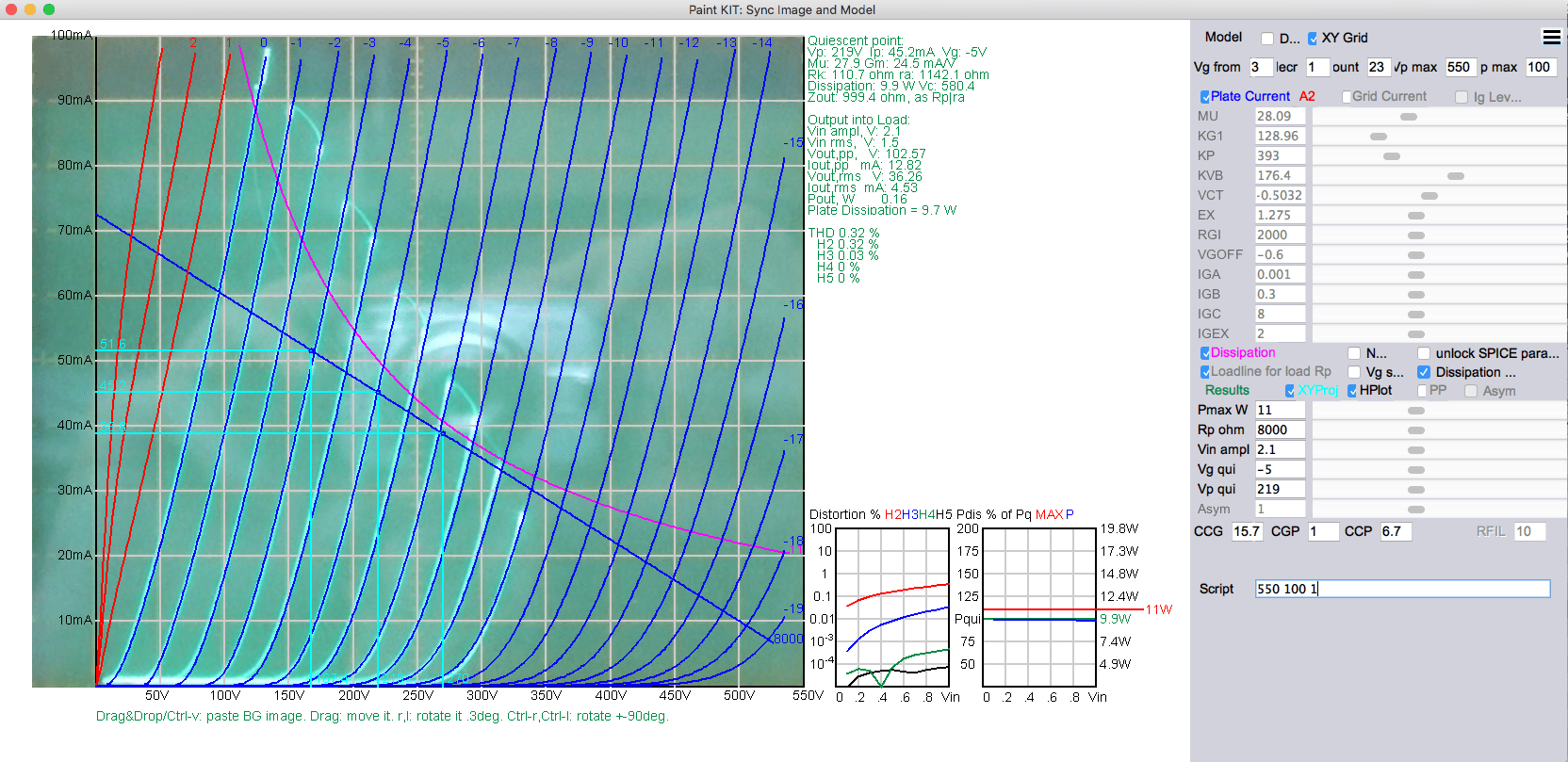

Hi, may be of help. Some spice models in triode mode. One is from measured 12HL7 there in DIY audio forum other is other measurements.Not too long ago, won this lot of 12HL7 on eBay, 89 NOS tubes for $110 plus shipping. Sorry if anyone else was bidding. Now I need to plan something for them. Might start with a little spud headphone amp.

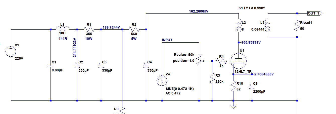

Many thanks to Zoran for the LTspice models. I set them up and ran a simulation of the circuit. It looks like in my (very very simple) circuit, the 12HL7-Triode should run at about 155V at the plate, 2.7V at the cathode (62 ohm Rk. 2200uF Ck), Ip = 43.5mA (Pdiss = 6.7W). I now have three different 12HL7 models, and they're all in the same ballpark. The models work well.
BTW, there are some typos in Zoran's models. The tube type is misspelled as "12LH7" in a few places. Change that to the correct "12HL7" and all is well. Minor quibble.

re: Rongon
The 1st two RCA pics are the small ones, like I sent back. They didn't have as nice of triode curves as the bigger ones, and clearly lower Watts. I also have written in my notes for 12HL7 the mu factor (from just a few samples of big ones) RCA 40, GE 30, and Sylvania 25
Take a look at some 11HM7 pics on Ebay, they look just like the smaller versions.
From u = gm rp and gm = 21000 @ 25 mA
and gm approx. 21000 Sqrt (55/25) at 55 mA = 31148
rp at 55 mA would be approx. 1000000 30/31148 = 963 Ohms

Thanks smoking-amp.
I figure 12HL7-triode or 12GN7A-triode with Ip = 45mA will have rp of about 1100 ohms or so. I figured with an OPT having primary inductance of only 8 to 10 Henries, I'd need that really low rp to get any bass response out of it.
I looked at some 11HM7 on ebay. Yup, they look pretty much identical.
I suspected the 'clear top' RCA 12HL7s were weaklings. I went through quite a few of them. I got them for $1 each, years ago, so I guess I can't complain. Maybe I'll try them at line level, with no more than 3W Pdiss.
I also have some other RCA 12HL7s with bigger innards and the getter flashing on top, along with some Sylvania and a couple of GE. I'll give them a try and see how long they last. Maybe they'll be OK.

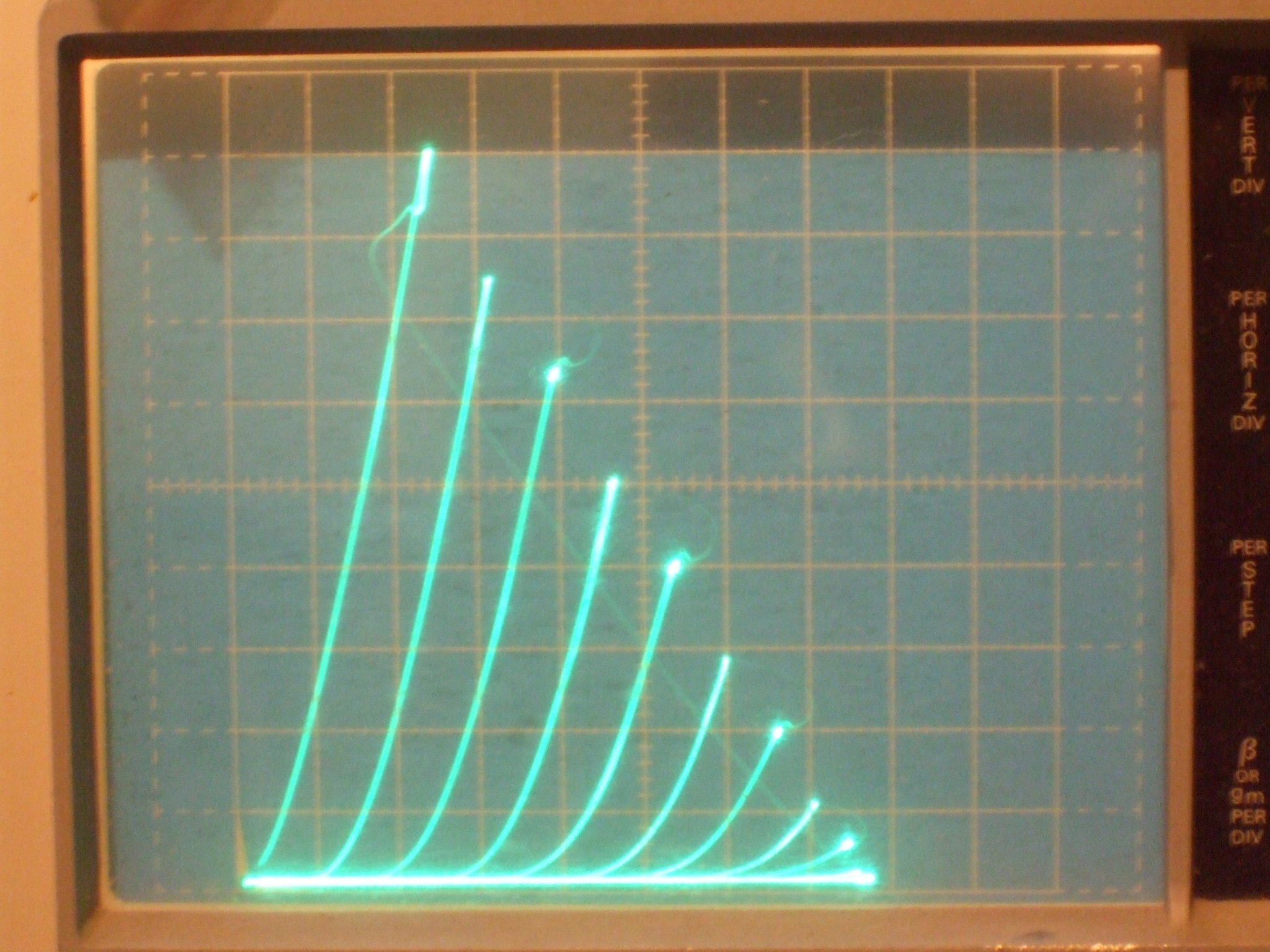

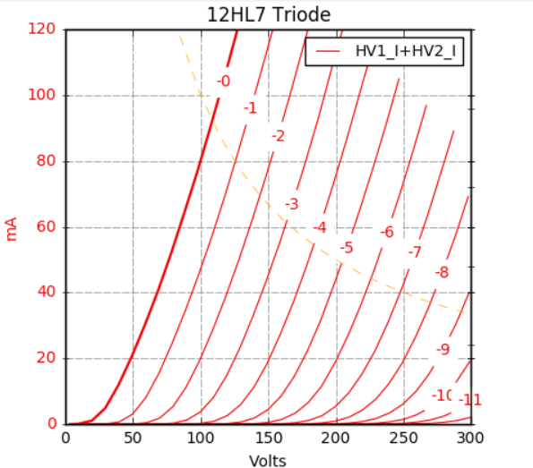

Here are some triode curves for a Zenith 12GN7, 50V/div Horiz., 10mA/div Vert., 2V steps
While looking for the 12GN7, I also came across one of the small RCA 12HL7 tubes I had saved, along with an RCA 11HM7 tube. They look the same.
I'm going to trace these to see how they compare with 12HL7. I also came across some 12HL7 tubes by International that have been marked over with 12GN7 on the box (over the 12HL7 printing, tube has 12HL7 printing too, but doesn't look right ). Will look at these on the tracer too. I wonder what else has been marked 12HL7 (probably at end of tube production)?
I dunno... Those 12GN7A triode curves look pretty good to me. Not as nice and evenly spaced as 12HL7-triode, and steeper bunching down near cutoff, but not bad (I think).

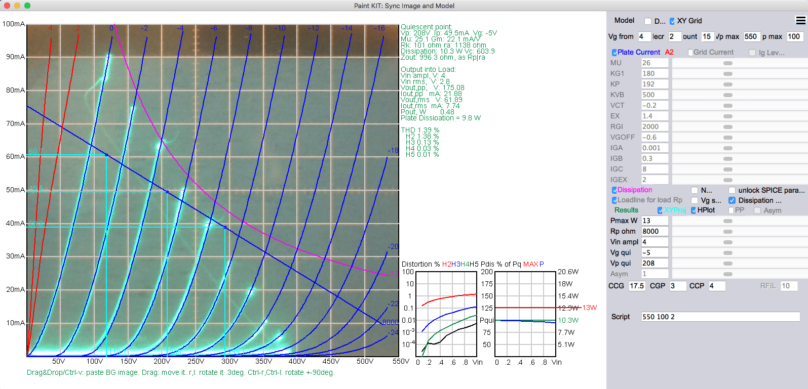

here is a spice model for 12GN7 based on anode chrs posted.
It seems a pretty good in triode mode as driver. Linear too.

I just gave the 12GN7_triode model a spin. Compared to the 12HL7_triode model, it looks like 12GN7 yields about the same gain but at double the distortion. That agrees with what my ears were telling me. I like the sound of 12HL7 better in my simple headphone amp, but I got tired of burning through tubes. I'll need to collect some more 'real' 12HL7s...

But 12HL7 seems to have a less distortion which means that is more linear?
On 12HL7 graph above, 12HL7 is configurated for say 2A3 driver for about 100Vp-p output (4.2Vp-p input)
with THD=0.32%
I think that is good result. And probably can be more tuned with RL value and working point for even less THD?
I did it fast without many analyses...
Yes You can remark the name of the ,inc file and subckt name with ends name too.
It should be the same.
It will be different for different transformers datas...
And define a part name in model pspice part drawing library editor.
line with @refdes form the part name.
I am using Cadence PSpice. Probably in LT spice is similar?
Ri of these tubes in triode mode is pretty the same about 995 ohms.
(Which is good because of les Hy needed in Primary of OT...)
And mju is almost the same 27 X
So the parameters are we can say so close to each other...
Try to find in the datas is the some other parameter differs? like Ua max, Rg max value and so.
