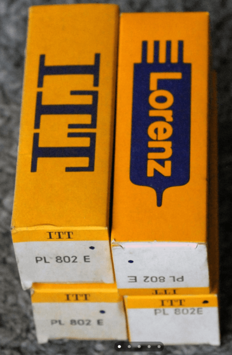

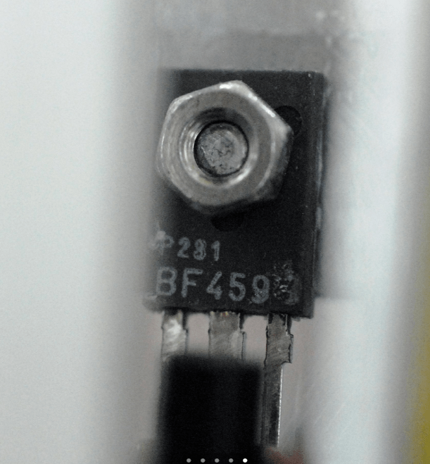

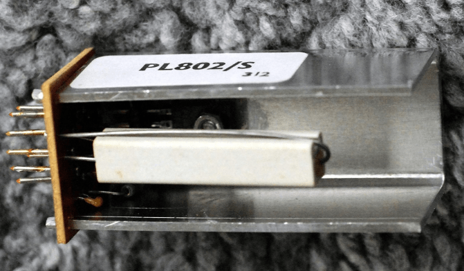

I'd buy these just for display, neat piece of history.There are 4 PL802E for sale on a local auction site, though I struggle to imagine who would want them. Maybe the components are worth more than the 50c that the seller wants for each 'tube'?
View attachment 1203793View attachment 1203794View attachment 1203795
The PL802 substitute was mostly a issue of some popular Philips hybrid color TV chassis such as K70. The solid state replacement was issued by Philips (and third party spare suppliers) in the '80 due to the subpar reliability of the PL802 tube in that chassis: the stock of spare PL802 tubes was out. The replacement was only meant to work on that chassis, it is not a general purpose substitute for PL802. It was possible to use the PFL200 tube with a socket adapter, but this decal tube was even more expensive back then. By the way, the end pentode of PFL200 / EFL200 tube is very good for audio when triode wired. I use it on my headphone amplifier.
I think I have a pair of those SS replacements somewhere. I guess the Noval base PCB could be used to build adapters or something.
Years ago I also bought a bunch of them for cheap, just in the same intention 🙂.

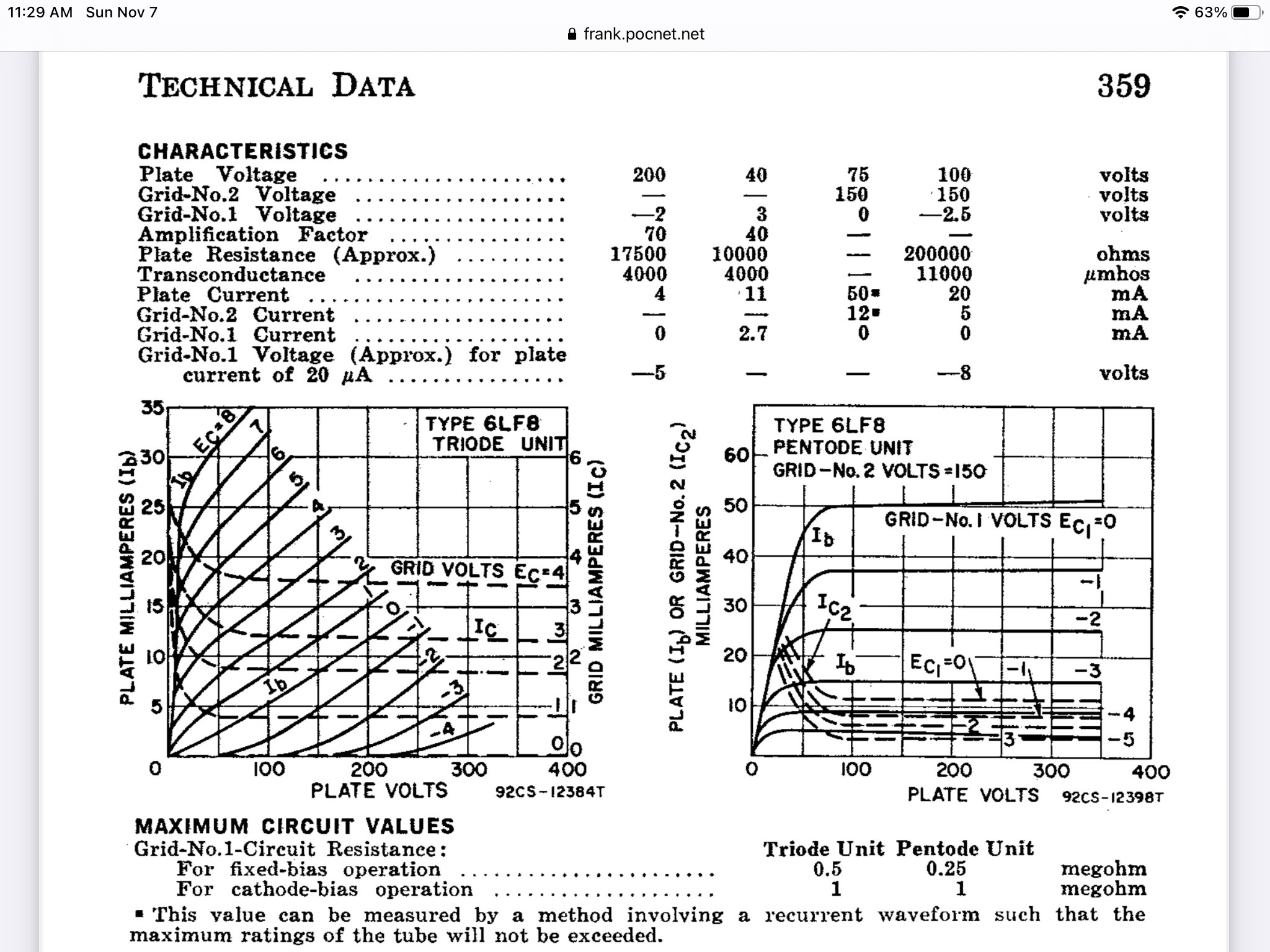

Anyone got a more detailed set of triode curves for the 6LF8 in the low current region? This is the best I could find, and considering this for an input stage, with the pentode as a current source for the LTP splitter. My usual go-to 6JW8 pentode doesn’t like 12 mA of static plate current - it wants to overdissipate the screen. The other alternative is the 6KV8, but it’s pentode is overkill, and I prefer to hang on to them for when I NEED a power pentode. I’d like to compare triode curves, but theres nothing on Frank’s any more detailed below 10 mA than this. Anyone by chance measure it, or have a better data sheet? Looks kinda similar to the 12AT7-oid in the KV8, with a bit less perveance. I’m down for the count for a while due to injury, and my shop is all packed away for the moment and the bench is inaccessible. So the design wheels are spinning up a storm.

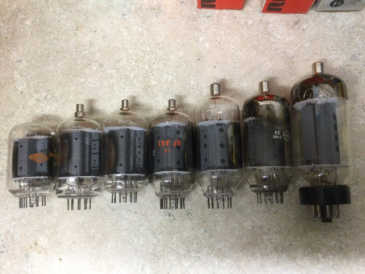

Been looking into the 17-18 watt class of tubes lately, gathering victims for Experiments That May Not End Well, as the Big Stuff is in development. Somebody’s been sandbagging here.
From left to right:
1. 6JN6 (Amphenol), 17.5W
2. 22JU6 (Japan), 17W
3. 6GY5 (GE), 18W
4. 6GY5 (RCA), 18W
5. 21LG6 (RCA), 28W
6. 21LG6 (GE), 28W
7 26LW6 (GE), 40W
Cathode current capacity (not listed here) follows heater power. In anything Id be using them in, they wouldn not be run up against cathode current/screen voltage limits. I’m only looking for half an amp, maybe 600mA or so apiece. What was interesting is that all 5 devices in the middle are the same size. And plate dissipation capacity should follow that. Maybe earlier versions of the 18 watters had the shrunk plates of the stubby JN6, I dont know. But I’m figuring the GY5s to probably take the same wattage as the LG6’s - at least on stuff I have. I have since ordered more. There are even two basic versions of the LG6 and GY5 (RCA and the GE that may be marked anything). You get both types in both places even. And the Made In Japan JU6 uses the same GE style ”28 watt” plate.
I also bought a whole box of the little 11 watt 17BQ6GTs. STILL on the dollar (75 cent) list. Those little things are cute - I thought they’d be bigger. It will be kind of fun making 100 watts out of a quad of tubes about the same size as EL84’s. Math says it stays within ratings.

I also would have thought the same, until I compared 6CB5A (heater power 15.15 W, cathode current rating 240 mA) and 6KG6A (heater power 12.6 W, current 500 mA).Cathode current capacity (not listed here) follows heater power.
Best regards!
Peak current capacity follows heater power more closely than ratings do - but the more modern compactron types often can have more peak current at 2A heater than older octals do at 2.5. Even at the same g2. It’s not 1 for 1, but a general trend up with heater power.
The 26LW6 for me means business. The small caveat is to fudge an appropriate heater supply but silicon is cheap. These tubes are capable of being slam driven. I find these hardy sweep tubes deliver the goods. Generally ex TV tubes have larger cathodes, and can take more current. I prefer them. A 12HG7 12BY7 group though 12V heater for me is a darned good start for a long life setup.
