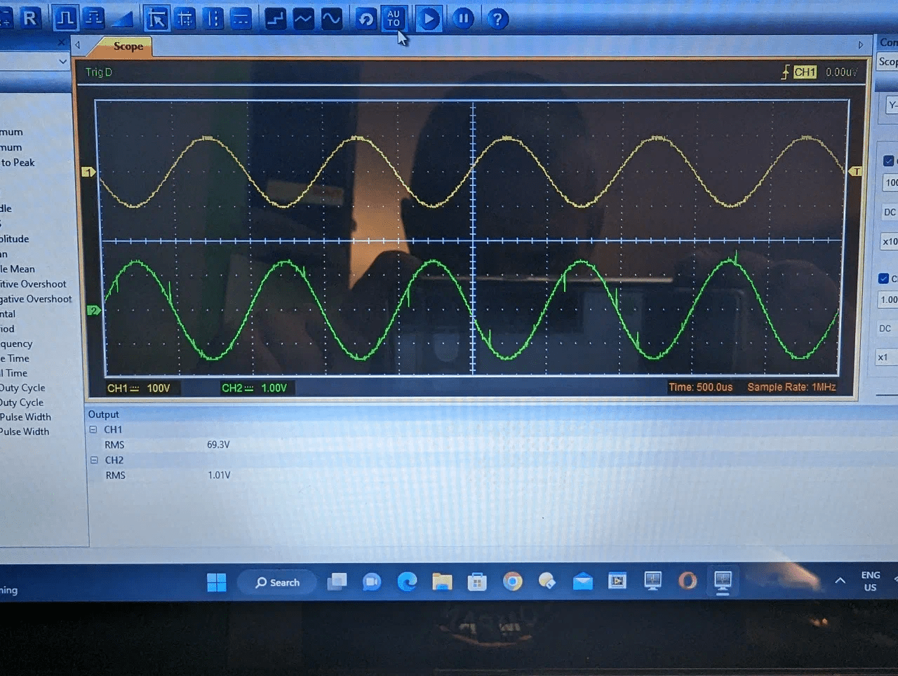

Quick note regarding the 6CW5 and 6P43P-E.
I built a 6CW5 amplifier a while back, and it's great. Pentode connected, regulated screen voltage at about 175 volts with regards to the cathode, plate voltage about 270 with regards to cathode, garter bias, and toroidal outputs. Love it, thread here-
https://www.diyaudio.com/community/threads/6n2p-6cw5-design-with-toroidal-outputs.327541/
Yesterday as a quick function check, I swapped out the 6CW5, and installed a set of 6P43P-E. Immediately found some issues.
For reference, the 6CW5 is dead silent at idle, and during warm up. Global negative feedback without any compensation or extra stability measures used. AC filament wiring.
With the 6P43P-E installed there is immediate hum a second or so after power on, and a noticeable increase in heat. About twenty seconds in an obvious LFO (motorboating) sound is heard. I powered it down and let it cool. After a moment I reinstalled the original 6CW5 tubes and all was normal again.
Clearly in pentode mode the 6P43P-E need some additional measures taken to be stable in the same circuit. I did not try disconnecting the feedback but might another time. Gonna try triode mode and see how they behave.
