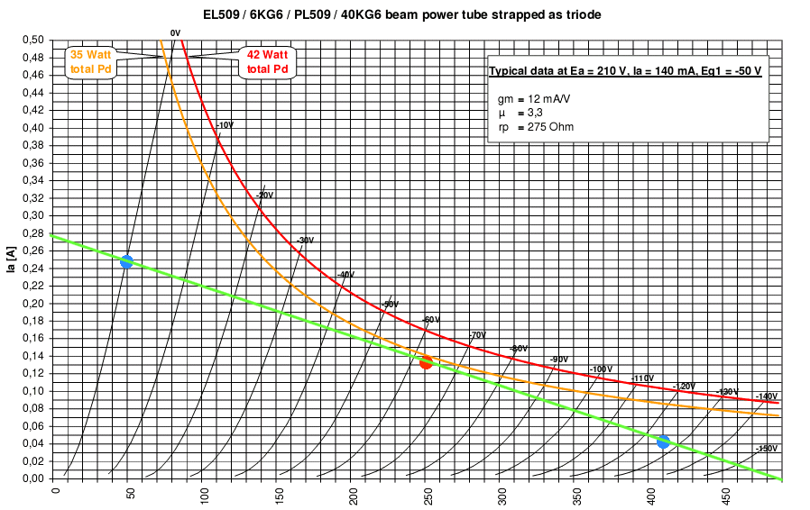

Have a Hammond 370 hx transformer, a choke, 10H/200mA and some Hammond 125FSE output transformers. I watt to build myself a single ended amp with "tv-tubes". 6-8 watts?. Any good ideas, and recomendations? Have Just finished an el 36Se, Who sound great.

Max DC bias seems to be around 90mA, which is quite substantial.
So for near symmetrical bias, something around 8-10W output power will do.
With the 5k impedance you could get a bit more output power (about 10-17W), although with a little less low-end (see Hammond datasheet).
In that case just find a nice tube with a max plate dissipation of around 35-40W
Or with the 2.5k impedance you could get little less power (7-9W or so) but with better low end.
In this case we are limited by the max DC current of the output transformer.
So you won't get much more from a tube with a plate dissipation more than 25W.
So something like a EL34 or similar will work fine around 250-270V or so.
I am sure there are some very nice television tube equivalents that can be used here as well! 🙂
I just don't know them all by heart.
It depends on if you care where the tubes were made and if they use a plate cap or not. US and Euro tubes tend to cost more than Soviet or Chinese tubes.
Personally, I'd probably use 12AV5GA (Octal) or similar, strapped as triodes, running 300V - 320V B+ and connecting a 4R load to Black and White on the secondary (reflected load 1k25) with an idle of 80mA for 24W dissipation and about 10W out.
Other good choices are 12GE5 (Duodecar), 12GT5 (Novar), 12BQ6 (octal with plate cap), etc.
Basically, any sweep tube with a Pd of 24W strapped as a triode will work here.

The A Number One problem with these types is that the most linear part of the characteristic lies well within red plate territory: see, for example: 6BQ6GA. This is why the specs don't mention any audio usage. The HD types work best as Class AB, push-pull pairs. The other problem is the low screen voltage that males using them as pseudotriodes (or in ultralinear) difficult.Have a Hammond 370 hx transformer, a choke, 10H/200mA and some Hammond 125FSE output transformers. I watt to build myself a single ended amp with "tv-tubes". 6-8 watts?. Any good ideas, and recomendations? Have Just finished an el 36Se, Who sound great.
As for pseudotriodes, your best choices are probably the 6AV5 or 6BQ6 since both types are very similar with the only difference between them is a plate top cap (6BQ6). They seem to be able to take over screen voltage without poofing, and the pseudotriode characteristics are quite like the 2A3.
The soviet 6P41S (6П41С) is pretty linear triode-strapped, works pretty well in SE and PSE setups.
The most linear portion of the characteristic of many audio triodes is firmly in red plate territory too.
Vertical deflection pentodes can normally take screen voltages approaching the plate voltage. They may do better trioded. But the biggest ones I know of are 19 watts dissipation, and most of them 12 to 14. Quite a few vertical deflection triodes out there with some pretty damn high perveance, and will get you close to pentode efficiency. Might be maddeningly short of 6-8 watts single ended though, as the typical dissipation limit is 9 or 10 watts. The 4-5 watt level should be easily do-able.
6P45S, 6KG6, EL509........ in triode or 6C4C or 4P1L in parallel, 12/6AV5GA, 6CB5/A
