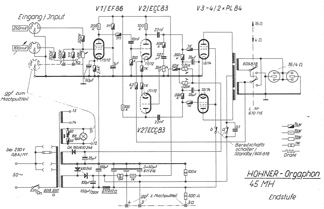

The xCW5's appears to be a family of miracle tubes. In the 1960ies German musical instrument manufacturer Hohner squeezed 45 watts of output power out of just one pair of PL84's/15CW5's in an organ amplifier. Screen supply was 200 V, but plate voltage was higher by far. Sorry, don't know more Hohner Orgaphon 50 details.

That 45 watt organ would need to be running up at 330V, with 4K a-a. It would be running right at the 12 watt rating (at full power). Regulated G2 is always how you get the most watts (and lowest distortion) in pentode.

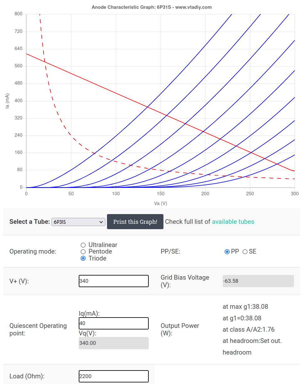

I was impressed getting over 10 WRMS out of a pair of 6P43P in triode until I got 38WRMS in the same circuit using 6P31S as triodes (and a different bias point). So far, I haven't seen a tube that comes close (ok maybe 6P45S or 6P36S but they are much larger tubes). 6DQ6/12AV5/12GE5/12GT5 (and the like) all only make 24WRMS in the circuit.
No idea how long they would output 38 WRMS sine waves without melting, but for music they are great 🙂
Surprisingly, the real world testing shows the same results as VTADIY calculator!
As you can see, I run the tube way out of spec LMAO but J'men câlice! (I don't care but more vulgar).

There's a schematic ready for download at www.radiomuseum.org. It says plate voltage is 460 V at idle or 370 V at full power; screen voltage is 250 V at idle and 220 V fully driven. No regulation at all 😉 . And, of course, no details on the OT.That 45 watt organ would need to be running up at 330V, with 4K a-a. It would be running right at the 12 watt rating (at full power). Regulated G2 is always how you get the most watts (and lowest distortion) in pentode.

Got a link to the exact schematic?There's a schematic ready for download at www.radiomuseum.org. It says plate voltage is 460 V at idle or 370 V at full power; screen voltage is 250 V at idle and 220 V fully driven. No regulation at all 😉 . And, of course, no details on the OT.
Best regards!
They are only overloaded if you believe the datasheet... It was a horizontal sweep tube for B&W sets, the usage of which is a much harsher working condition than an AB audio amp. I find all sweep tubes to have an underrated Pd for audio service.That’s not as severely overloaded as Koda is doing with his little 6P31’s. That little GT form factor isn’t much bigger than a mini 9-pin, and they’ve been known to stuff the same guts in both from time to time.
I generally don’t like to go overloading tubes in terms of current or dissipation - at least not in something I’m going to keep. When they get older and lose emission you notice it more if you’re trying to get every available mA out of them. With $3-5 TV tubes an extra pair (and pair of sockets) isn’t much of a hardship compared to doubling the size of the TRANSFORMERS, which you simply can’t cheat or it runs up against a wall.
They are only "fragile" if the plate cap comes off while it's on (screen melts).
Think it's this guy-Got a link to the exact schematic?
https://www.diyaudio.com/community/threads/what-do-you-think-about-this-tube-schematic.309342/page-3
If so, isn't that output combined for both channels?
Yes, this amplifier features the very same PSU and output section as the Orgaphon 50, but isn't identical completely.
To achieve any schematics from www.radiomuseum.org, you need to search at the website. It isn't possible to provide download links from there, and you're limited at three downloads per day 🙄 .
