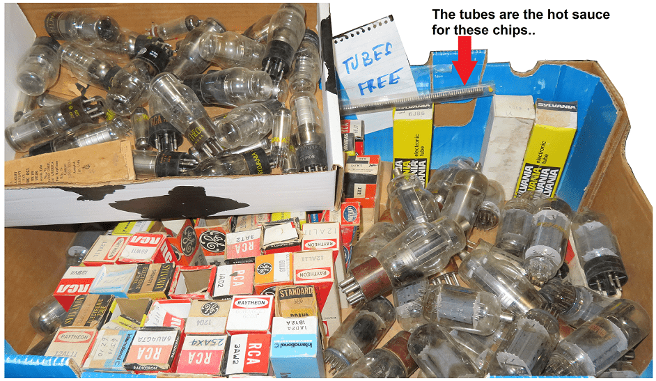

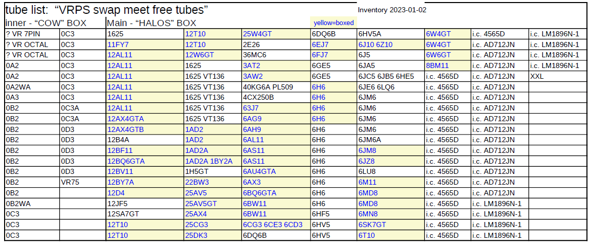

Just thought I'd share some good fortune. At a recent swap meet there was a box labeled "free tubes". naturally I accepted! Most are TV set types but a few are radio or other types.
Bunch of 12AL11s, good sampling of TV types. Also some 6H6s, VR tubes 1625s, and unexpected a surprise tube of op-amp IC chips were in there. This isn't an ad, just a little celebration.
It would be interesting to take that list and define a potential use for each one. I am trying to do that with my collection I have. All tubes are born equal, but some tubes are born more equal than others (I am sorry Mr. ECH81, but that is the way of the world).

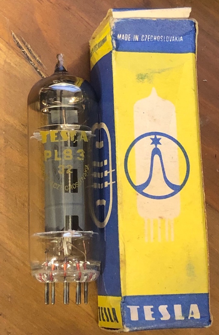

I have 4 x NOS Tesla 'Made in Czechoslovakia' to try next.
Also got some 6P15P = SV83

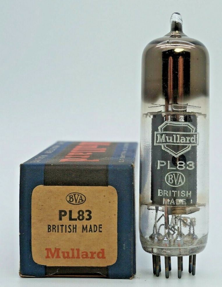

I ordered 2 x NOS Mullard PL83 for £5 each yesterday, can also get NOS Mullard EL83 for £7 each.

I've just tried the 4 Tesla PL83s and got them to match close enough for a guitar amp.
The 10 x 6P15P are another story...
