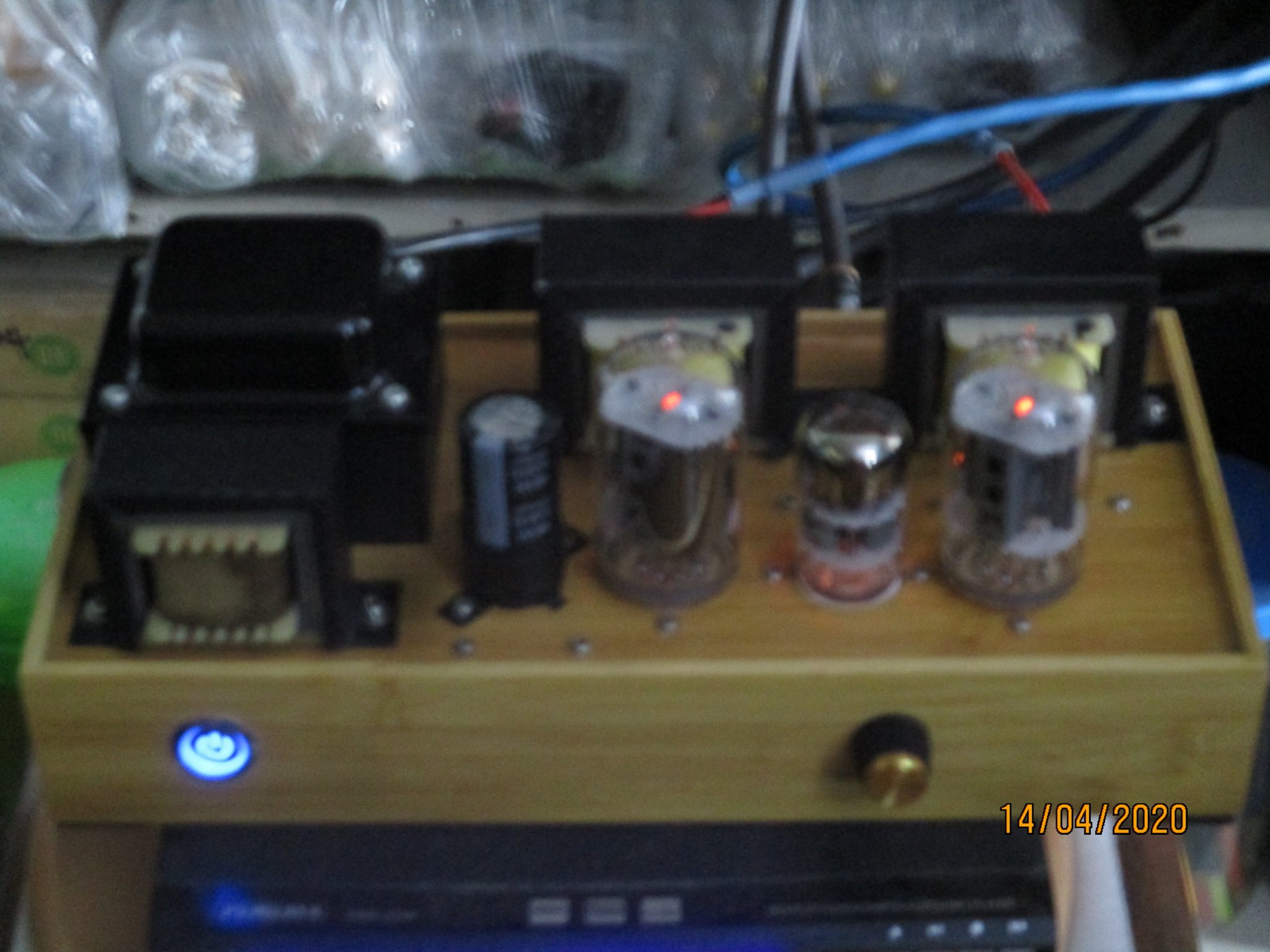

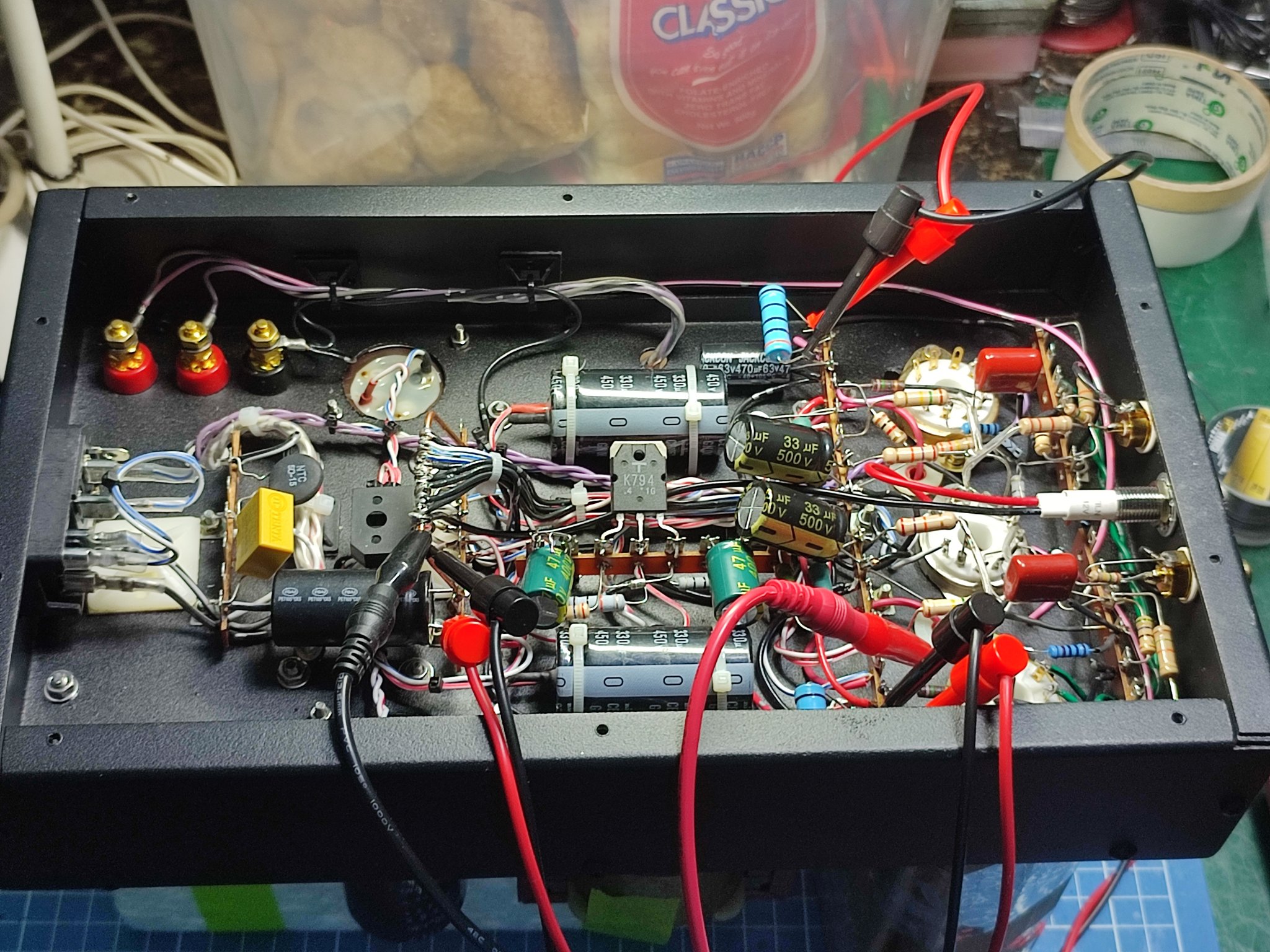

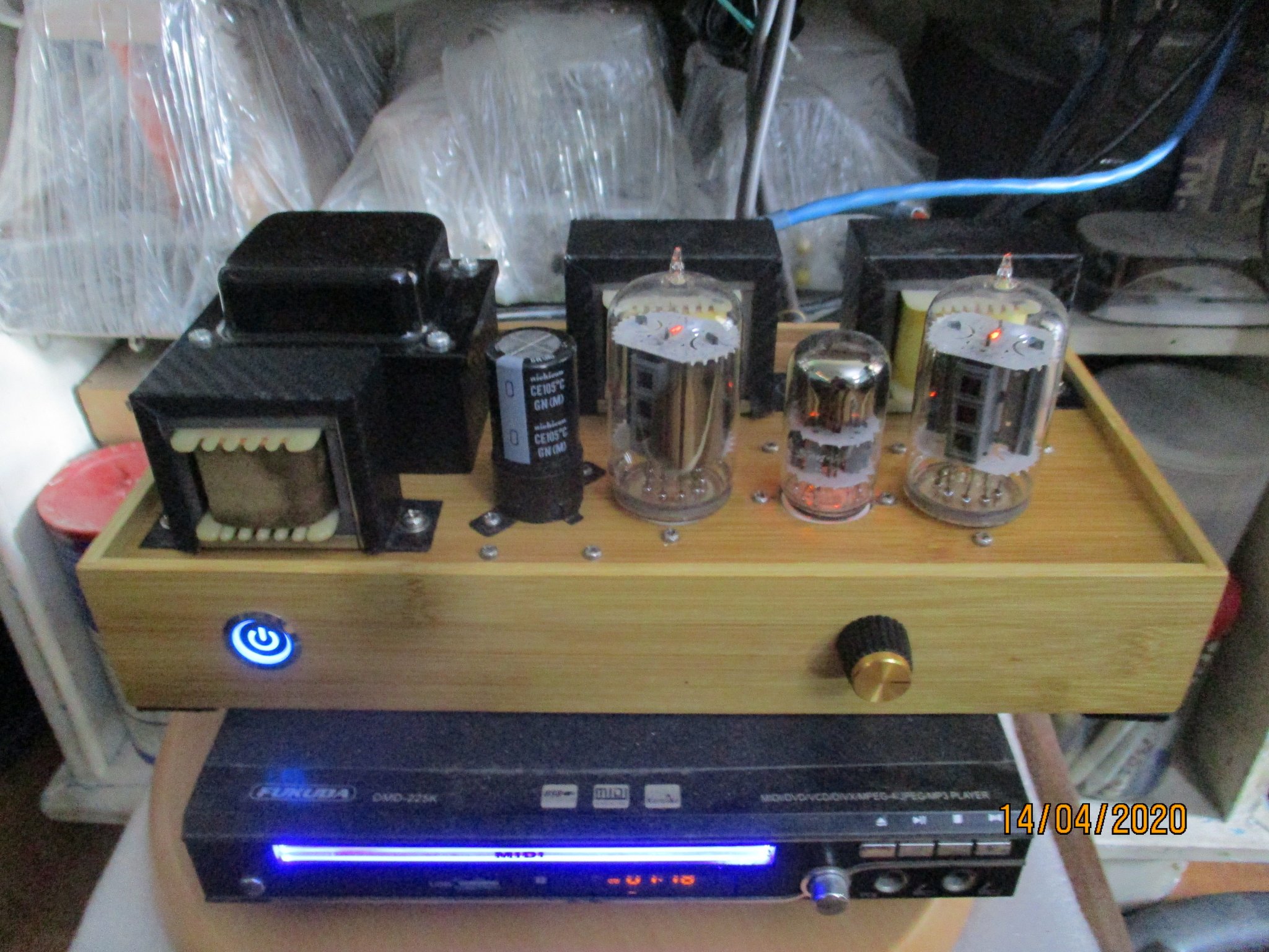

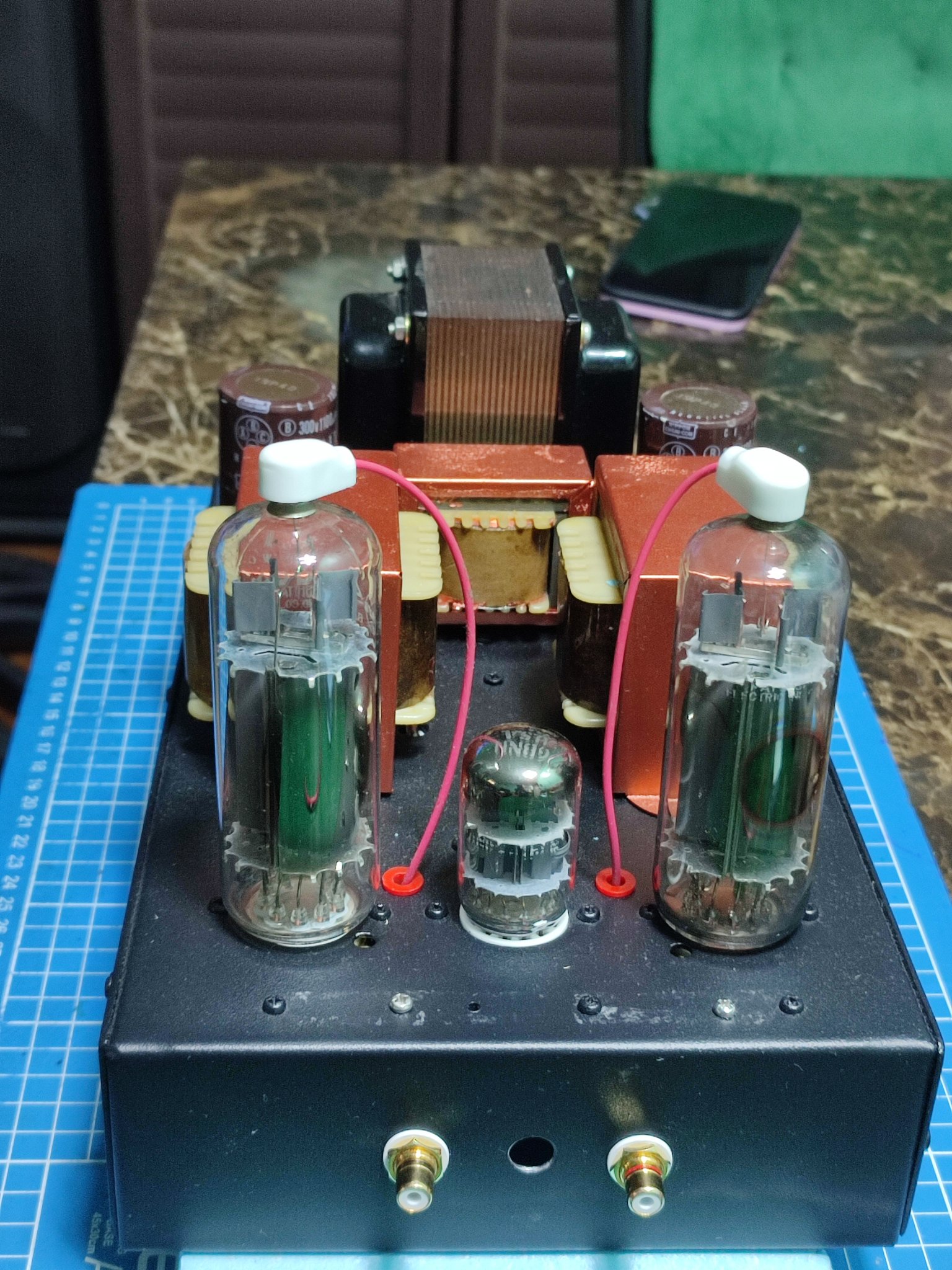

tv tubes rock!!! Happy New Year to all tube lovers out there...
here are two of my SEP's, single ended pentodes, no global negative feedback used..
output tubes were 12gt5 and 40kg6 aby driven by 6bn11 all in pentode modes, screens are regulated using CCS and Mosfet voltage followers...

Fully agree that they rock!tv tubes rock!!! Happy New Year to all tube lovers out there...
Can you tell about the output impedance and frequency response of these amplifiers?
Pentodes, no GNFB imply high output impedance, SE OPTs have lower inductance (than a PP), so I am trying to see how much power one gets at say 20Hz. Or is there some local feedback?
Many thanks!
Erik
Many thanks!
Erik
plate to grid circuit feedback used 200k -150k resistors...i do not have a setup to measure those...

Thanks for the details! That is pentode power with low plate impedance due to local feedback (as in triode wired pentodes). Winner indeedplate to grid circuit feedback used 200k -150k resistors...i do not have a setup to measure those...
