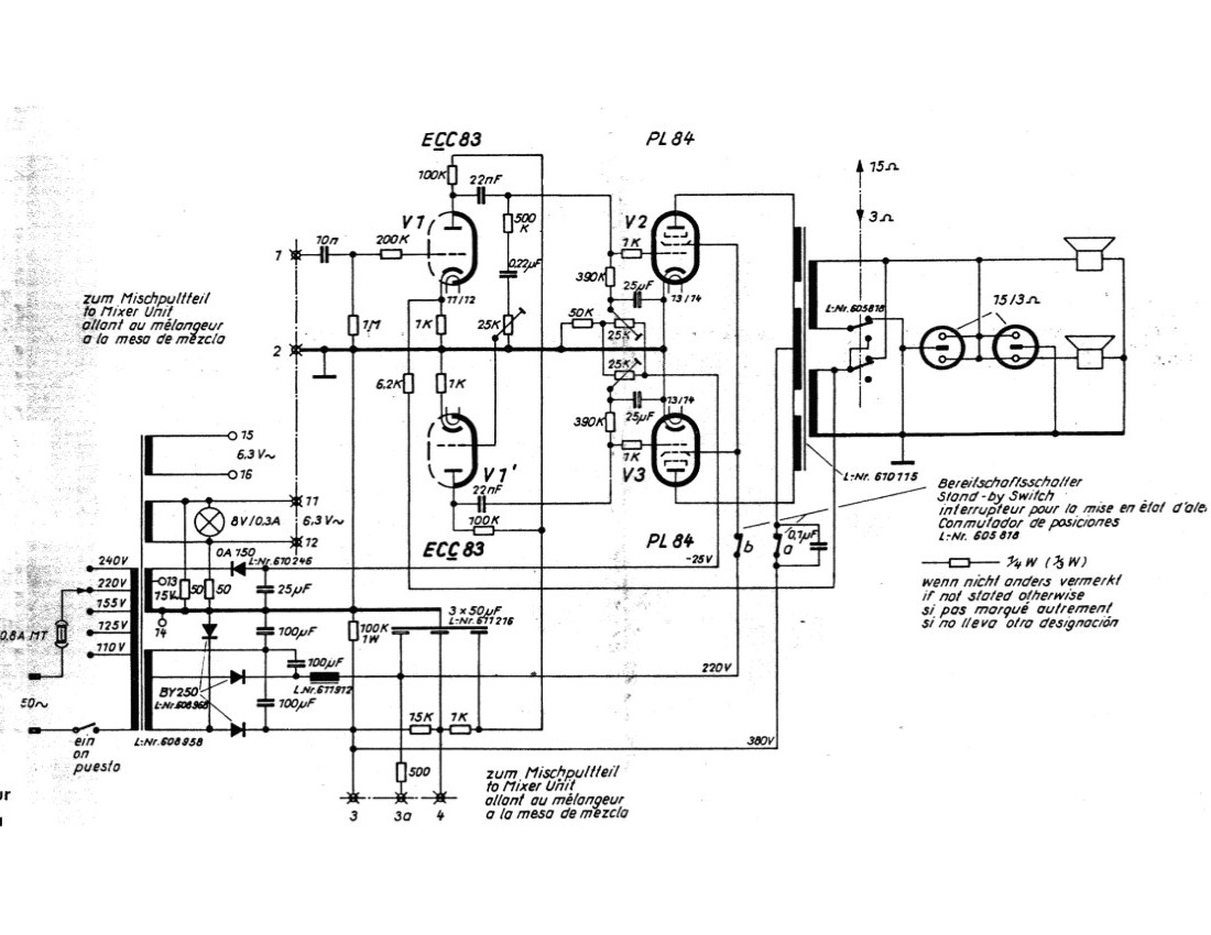

I had several "Hohner-Orgaphon 45MH" amplifiers with me in the service workshop and had the opportunity to measure the actual power output. The voltage from the rectifier was somewhat unstable, which can be attributed to the relatively high internal resistance of the HV rectifier and the (too) small capacity of the electrolytic capacitors in the doubler. Because of this, the undistorted power was much lower than declared, i.e. the supply voltage would drop ~25-30V at maximum excitation compared to the state without excitation. With continuous sine wave excitation, the output power was between ~36-40W (depending on the frequency) before clipping occurred. I used new and paired output tubes PL84 (EI-Niš), and the optimally adjusted quiescent current was ~15-16mA for each output tube.
The "Hohner-Orgaphon 41MH" amplifier had a slightly higher output power, despite the fact that the factory name suggested that it was a weaker amplifier. I had the opportunity to service and measure only one example of this type of amplifier, but it mostly gave ~40-44W before the appearance of clipping. Analysis of the rectifier connection of the MH41 model shows the difference compared to the MH45 model, where it can be seen that the MH41 G2 model has a slightly higher supply voltage (220V without excitation signal) compared to the G2 voltage of the MH45 (200V without excitation signal). I also adjusted the quiescent current to ~15-16mA per electron, but due to the higher supply voltage of G2, the negative value of the bias voltage of G1 had to be higher. Despite the fact that these output power data are significantly different from the PL84 electronics manufacturer's data, they worked stably and for a long time in these amplifiers and without any traces of overheating even at the amplifier's maximum power.

Hi Davorin,
did you measure the OT's transformation ratio and the PT's secondary voltages, too?

How are the PL84 heaters being supplied in that circuit? Is there a separate transformer or a winding that is not marked?
The secret looks to be the low current through the tube, but it is operating in uncharted territory compared to the graphs in the tube data. How do they sound?

With both types of amplifiers (MH45 and MH41), the output transformer has a primary impedance of Raa=5.5kOhms, which I obtained mathematically from the transmission ratio of 1:43. More precisely, it is ~5550 Ohms, because I applied a sinusoidal voltage of 7Veff (100Hz) to the speaker output of 3 Ohms, and I got ~301Veff on the PL84 anodes. The speaker was disconnected at the same time. The HOHNER company also used the widespread (in Europe) and cheap PCL805 tube in its "Orgaphone MH24" amplifier, which was used in the vertical deflection of black-and-white TVs, and also in some series of color TVs.Hi Davorin,

Thank you, Davorin, for your extremely unseful informations
As said above, the Hohner company was very clever with using common (in those days) TV tubes. Btw, they also sold a 130 watts Orgaphon amplifier with a pair of PL519's as finals. Custos!
Yes, the PCL805 originally was derivated from the PCL85 and intended for frame deflection service in B/W TV's. It was some surprise for me when I found it in an old Koerting 837/997 colour TV set. Anyway, this set featured a 90° deflection angle CRT. When 110° CRT's became common here, a more powerful tube was developed, the PL508. Even this tube found use in a Hohner amplifier, the Champion (no, not the accordions of the same name), with four PL508's as finals.
Do you also know the Orgaphon PT's exact secondary voltages? Otherwise I'd need to re-engineer them from the DC voltages after the rectifier/doubler.

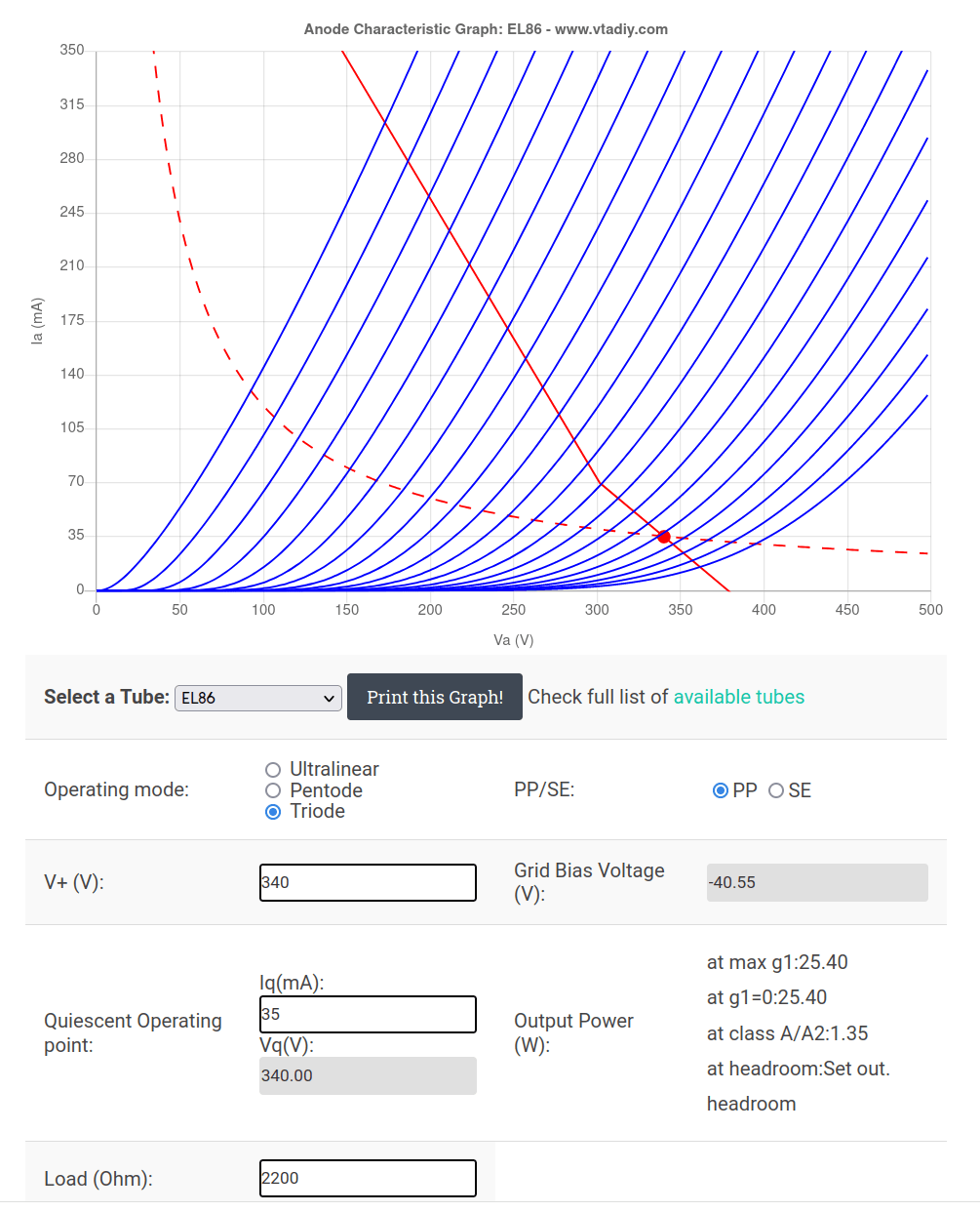

Davorin, thank you so much for your essential first-hand account of this very interesting amplifier! Looking at the math the output does in fact line up, and these are very much a baby sweep tube it looks like even more now. Now I'm getting curious as to if the 6P43P-E would survive at these operating points.
Very interesting to see that this amplifier is so similar to how I have my 6CW5 set up, the main differences for me are the 4100~ ohm equivalent output transformer I'm using, and about 50-60 volt lower screen and plate supply. I'm gettting 20-25 watts out of mine. Crazy how bumping it up that much can make such a large difference in output.
Playing with this calculator (thanks Koda!) confirms everything too. Gonna do some more comparisons on it and see what I get.
https://www.vtadiy.com/loadline-calculators/power-stage-calculator/
