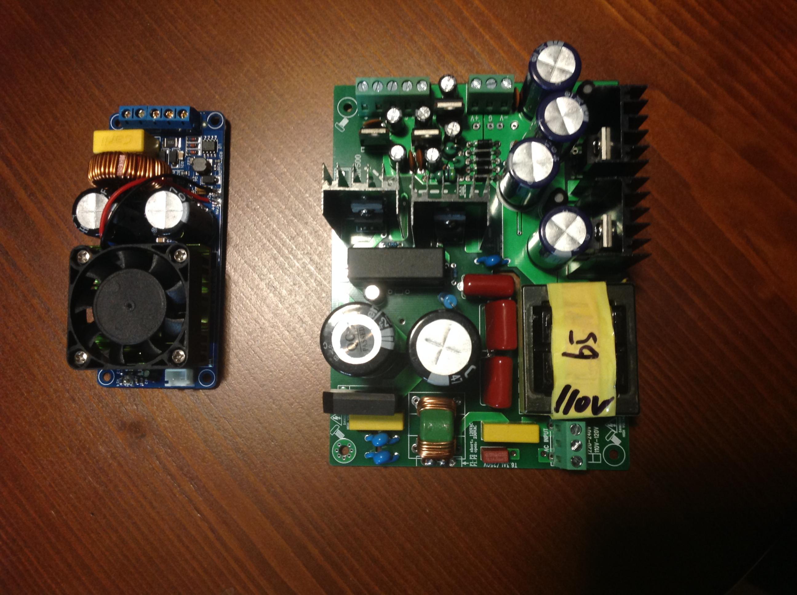

500 Watt amp for $16.02USD
Well... here you go... $16.02 USD for the amp, $34.95 USD for the +/- 65VDC power supply.
IRS2092S 500W Mono Channel Digital Amplifier Class D HIFI Power Amp Board- US$16.02 online shopping | NewFrog.com 😀
I'm looking to build a 500 watt per channel stereo tube amp. You don't need 500 watts of plate dissipation for that.

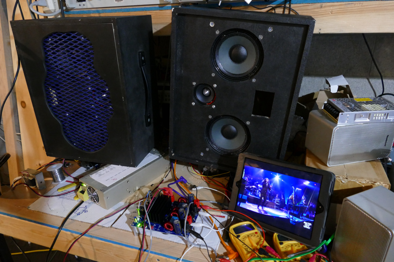

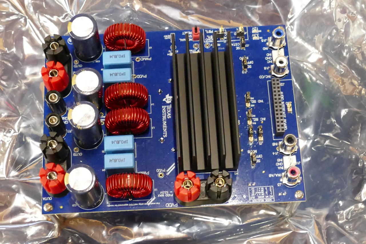

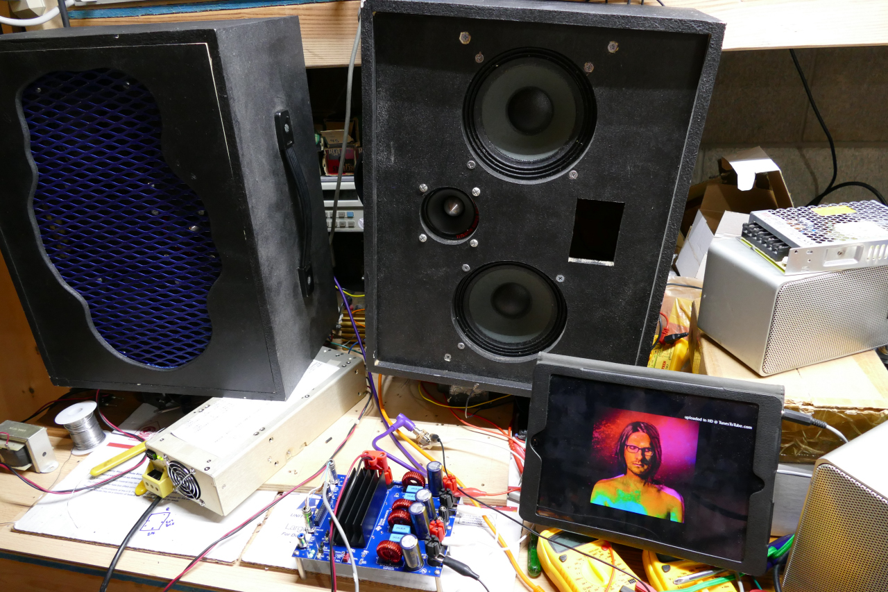

Well, I already have one of these:
TI Class D EVM Board 50% Promotion
And I have successfully used it to rattle the drivers loose in both of my test speaker cabinets. It might find itself feeding a pair of big subwoofers some day, or maybe a tiny but LOUD guitar amp.
It sounded pretty wicked feeding these same speakers when driven by a small PC running TH3. Having learned to play the guitar on the surf music from the 60's, I'm a sucker for the reverb laden surf guitar sound it emulates. I never could make the real thing with my DIY tube amp skill set and budget in 1965.
Somehow "600 watts from a single chip and small SMPS power supply" just doesn't sound the same as "BIG A$$ kilowatt tube amp." 🙂

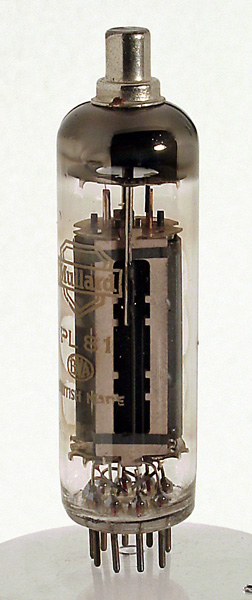

I remember replacing a PCL81 in a TV where the thing had run so hot that the glass envelope had collapsed around the anode. The PCL81 had ceramic supports that made the internal structure almost cylindrical.
That good ole PL 81 is an apt valve for audio in PP mode. It easily can deliver 20 watt per pair in class AB.

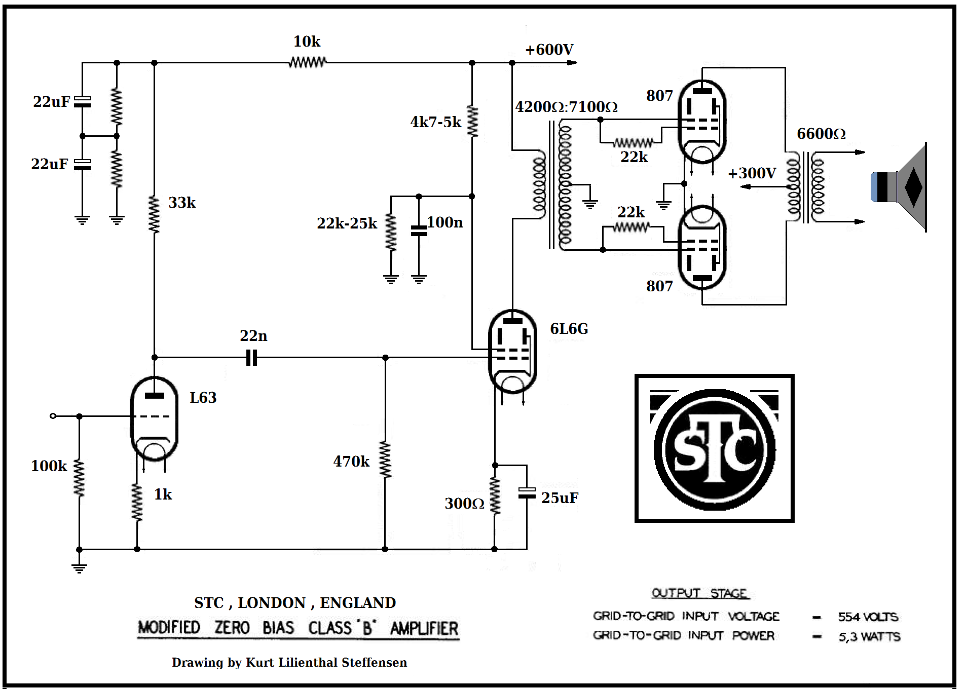

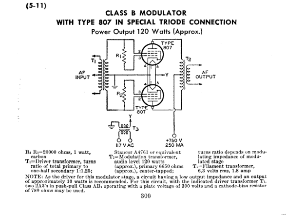

Yes, this has been drawn from a STC 807 application note that pops up from time to time.
Best regards!
Best regards!
The attached is from the RCA Transmitting Tube Technical Manual TT-5. I think this circuit was discussed in the "ruminations" tread. As I recall, the upshot of the discussion was that the 807 wasn't a good choice for crazy drive due to the G2/G1 mu of 8 (being too high for practical crazy drive). I know someone who tried this, as a modulator, with 807's and had no luck with it, whereas screen grid driven sweep tubes, with G1 grounded, worked well for him.
