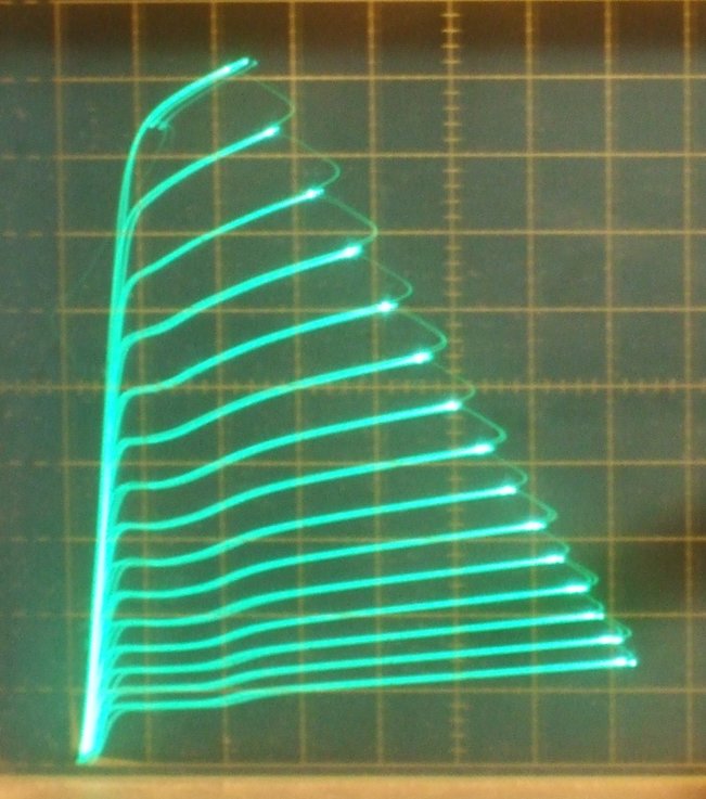

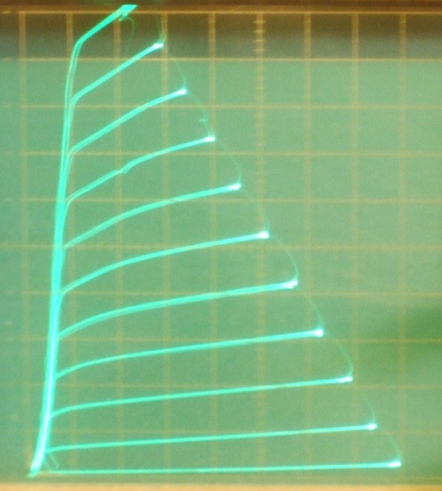

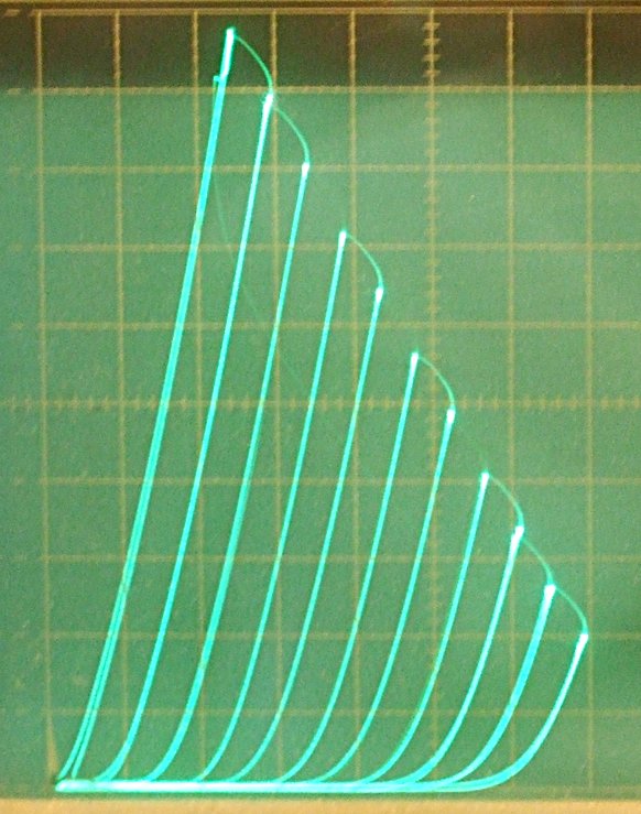

That 38HE7 pentode curve set above (curve 5 ) looked like it had slightly more screen current kinks than I recalled being typical, so I checked a few more tubes. The others weren't that obvious on kinks, so I traced a good one. (probably some grid1 / grid2 mis-alignment in the original 38HE7 tube traced)
Below is a more typical pentode curve set for 38HE7. Looks more like the 42KN6 curves now too. Using 117V on grid2 to get the vertical current span of the bigger tubes (versus 76V for the 42KN6), so the screen current kinks are a little wider than the 42KN6. (when parallel'd, the 38HE7 screen V would only need to be 76V to match the vertical current span of the 42KN6 traced above)
38HE7 in pentode
38HE7 in pentode

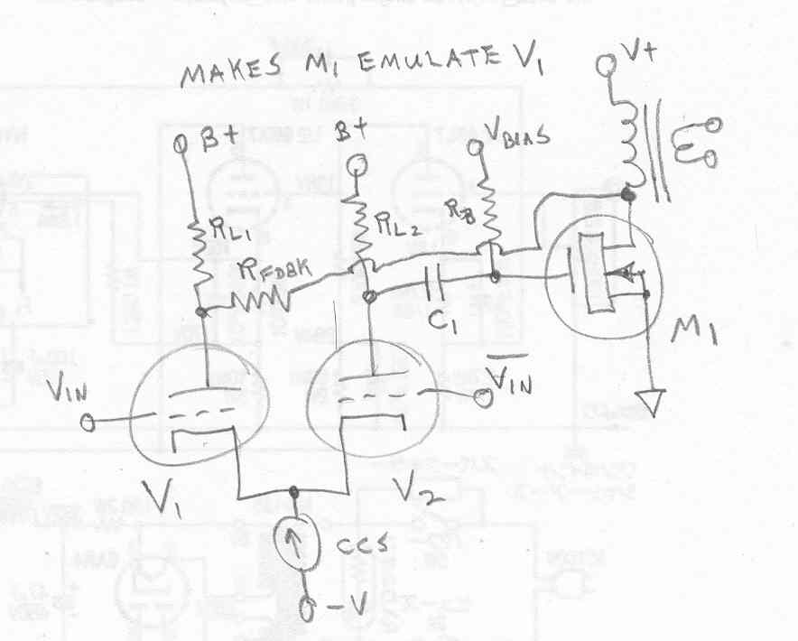

Those 10 Watt+ frame grid tubes (12HL7, 12GN7, 12HG7) could be used in some unique driver circuits due to the high quality triode between grid1 and grid2 or because of the high gm.
High gm:
Triode emulation via reverse N Fdbk thru a triode, enforced by a high gm stage (essentially a one tube Op Amp.). A Japanese site has been big on variations of this. This allows control of a big TV Sweep such that it exactly emulates an "emulant" triode. (V1 is the triode emulant below, V2 would best be a high gm tube, so pentode best, and M1 would be the power TV Sweep tube.)
a) rough emulation idea
b) $4 perfect DHP in triode mode to emulate (who needs 300Bs! )
c) or just use another 12HL7 etc in the diff stage as the triode emulant

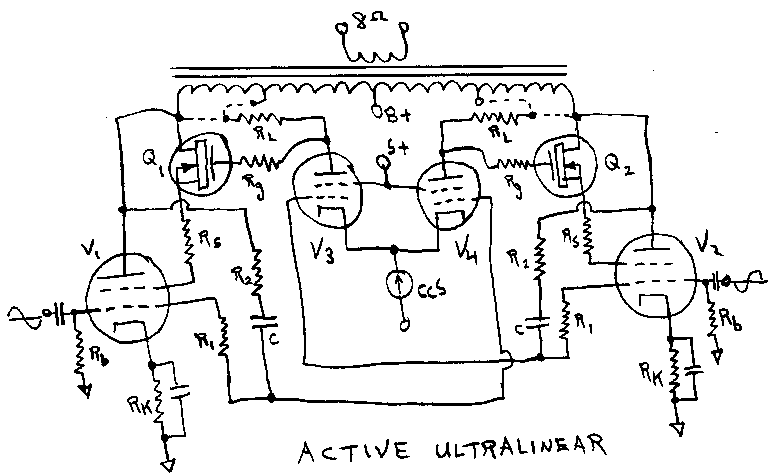

Internal quality triode:
Jan Veiset pioneered a P-P pentode driver design where the local N Fdbks (crossed for phasing) come back to the driver pentode screen grids. By adjusting the amount of N Fdbk, the voltages on the screen grids can be made to operate at some constant % of the driver plate voltages, so they draw a constant % of plate current. Making the screens look like nice constant resistive loads for the N Fdbk R dividers. (otherwise Mosfet followers would be needed for the screen grids)
With a pentode driver containing a high quality triode (g2, g1) this would have the effect of making the output power tube emulate the internal driver triode directly. (similar to the emulation scheme above, except with N Fdbk sent through the internal triode in reverse, so high gm drive and "triode" emulant all in the same tube here. )
If the N Fdbks came back from CFB OT taps (instead of plates or UL taps), then they would not need to be crossed for phase, so could work for an emulated SET output design.
However, you don't really need 10 Watt+ driver tubes for these fancy driver schemes unless a whole bank of TV Sweeps follow them. Some 4 or 5 Watt frame grid 9DX base tubes would work just fine too. 6LY8, 6JT8, 6LQ8 and 6KV8 have very nice triode mode curves (of the frame grid pentode) for example. And these include an extra triode for the amplifier front end as well. Most 9DX base tubes are on the $1 list. Some 20+ 9DX types to roll through if you are into that.

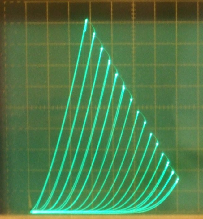

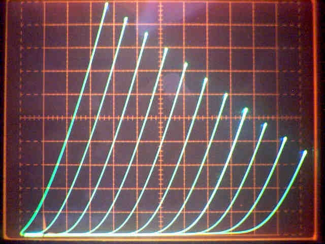

Here are some triode mode curves for the 9DX base pentodes: 6LQ8 and 6HZ8.
6LQ8: 50V/div Horiz., 10 mA/div Vert., 0.5V steps (frame grid, about 50 Mu)
6HZ8: 50V/div Horiz., 10 mA/div Vert., 1 V steps (non frame grid, about 25 Mu)
You will have a tough time finding "real" triodes this good!

Keep in mind that getting a good triode curve does not guarantee reliable operation in triode mode over extended time. Some sweep tubes tend toward bias run-away in triode mode after long hours. But if you keep the B+ reasonable, they probably will work OK in triode mode. Usually 300V or 330V datasheet screen grid ratings for these. (versus some TV sweeps with just 250V ratings) These tubes were intended for low screen V (150V typical) in practical operation, so no need to push the B+ up too high anyway.
Good triode curves also mean low distortion pentode curves, due to the grid not being too close to the cathode. These can work great for the pentode driver scheme with N Fdbk to the screen grid.
Some of the other 9DX tubes need to be curve traced yet to see how good they are. I've just cherry picked the most likely ones so far. 6HZ8 was a real surprise, big enough to replace a 6BM8 for low power, low cost, two tube P-P amplifiers.
