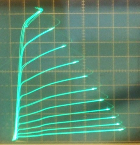

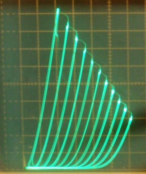

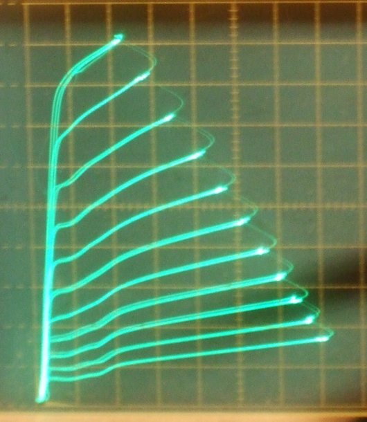

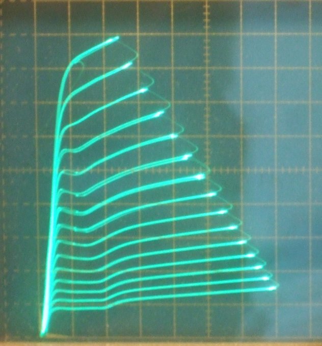

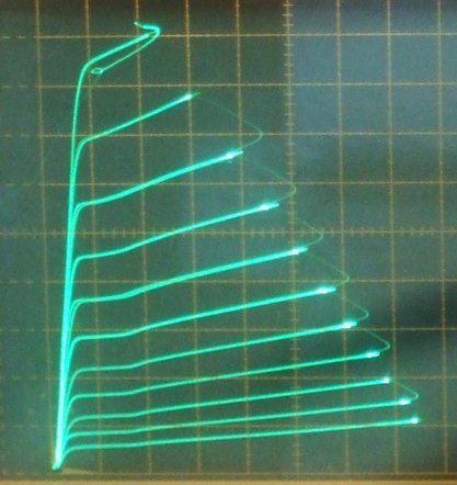

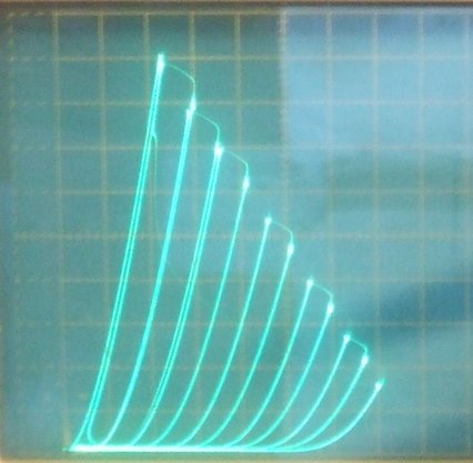

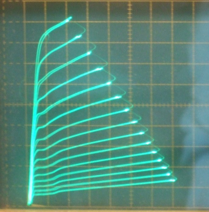

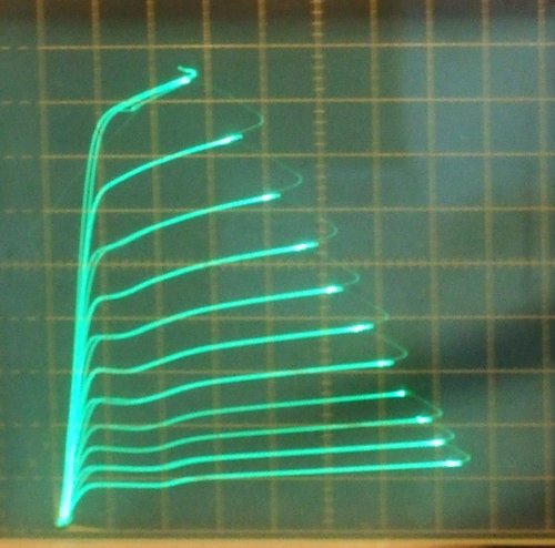

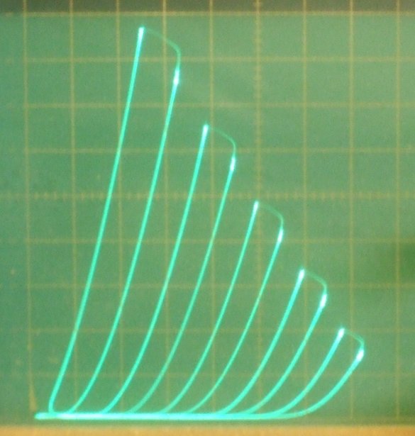

smoking-amp, looking at the datasheets for the 6HJ5 and 38HE7 the curves are similar. Would you care to comment in that it appears you have traced both?
The 6HJ5 is most closely related to the earlier 6DQ5 tube. Some small improvements in screen current kinks for the 6HJ5. Then 6LG6A was a later upgrade to the 6DQ5, smaller kinks, low screen current, lower heater power. (but the increased gm1 makes it a little less linear in pentode or triode mode, OK with some local N Fdbk of course)
38/12/6HE7 appears closest to a 21/6HB5A tube as far as a single tube match-up of curves. Obviously not the same Pdiss though (10 Watt vs. 18 Watt). However, I found that paralleling 2X 38HE7 gives curves that exactly match with the older style 42KN6 (30 Watt Pdiss) which had two small pentodes in parallel inside. (the later single section 42/6KN6 used 33 Watt 6KD6 guts according to an RCA memo)
The 38HE7 has a datasheet pentode Pdiss rating of 10 Watts, but an obviously bigger tube section is used inside. The internal damper diode (a 6BZ3 apparently) puts out 7.5 Watts of heater power and up to 6.5 Watts of diode plate diss. Since many 38HE7 tubes have the pentode-only heater connections on pins 10 and 12, it can often be run without the damper diode (21V heater for pentode). I had estimated about 15 Watts Pdiss. allowed for the pentode a while back, which then fit perfectly with 1/2 the 30 Watt Pdiss of the early style 42KN6. (which George commented that it sounded better than the new 42KN6 version)
On dissection, the 38HE7 pentode has a slightly finer wire pitch on grid1 than the 21/6HB5A has. And the triode curves for 38HE7 are somewhat better (less roll-over) than the 21HB5A too.
Some curves:
1) 6HJ5 in pentode
2) 6HJ5 in triode mode
3) 6DQ5 in pentode
4) 6DQ5 in triode mode
5) 38HE7 in pentode (a higher 125V required on grid2 to get the same vertical current span as the bigger tubes, so bigger kinks here)
6) 38HE7 in triode mode
7) 21HB5A in pentode
8) 21HB5A in triode mode
9) 42KN6 (old double style) in pentode
10) 21LG6A in pentode
note:
the 42KN6 and 38HE7 pentode pics here are not quite directly comparable, since the 38HE7 had 125V on g2 and the 42KN6 had 76V on g2 in order to get the same vertical current span. (so kinks are smaller on the 42KN6 plot) Also 2V g1 steps on the 38HE7 and 1V steps on the 42KN6. With two 38HE7 paralleled they match up exactly.
Most TV Sweep tubes look fairly similar anyway, mostly variation of gm1 mainly, and some variance of the screen current kinks. Also some difference in Rp slope to the pentode curves. The triode curves give the best indication of native (no Fdbk) linearity.
Reliable operation in triode mode (for TV Sweeps) is not guaranteed by these curves, as some may develop bias run-away with high grid 2 voltages over time.
