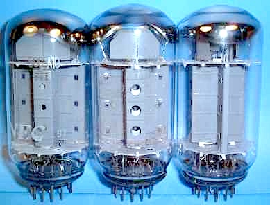

50C-A10
With an internal Mu of 8 and 30 Watt Pdiss, it would seem to be in the 6L6GC - 6550 - KT88 class. From the pics below
from: Japanese Triode
it would seem that it is a beam pentode with mica insulators, that has been triode strapped internally. A Mu of 8 would space the screen grid out further from the grid1 than in a typical low Mu (3 to 4) TV Sweep tube. How far the grid posts are from each other on the Mica would likely be the key to long tube life in triode mode. I see 450 V B+ stated as the max, same as a 6L6GC screen grid rating.
Another factor could be whether the tube was back filled with something fully getter-able (like N2) before it was finally evacuated. Residual Argon (inert, non getter-able, 1% in air) is probably responsible for damaging the Mica insulators over time by ion bombardment in many tubes.
Might be interesting to compare the 50C-A10 triode curves with a triode connected 6550.

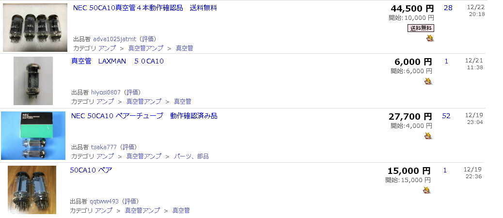

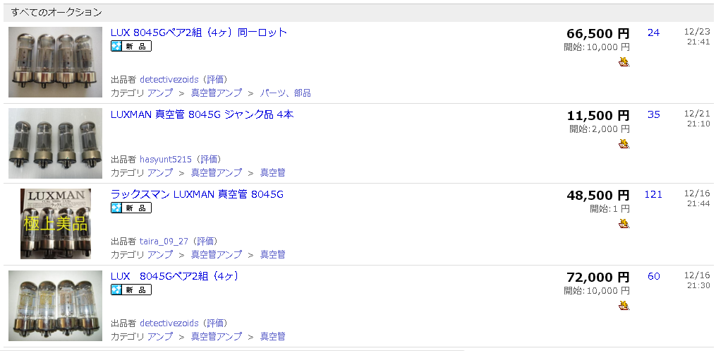

Several of my friends have Lux Amps SQ 38 using 50C-A 10 the Japanese made tubes are very expensive.
I modified a LUX 3045 amp using the 8045 with KT88's but you lose a lot of power the Lux 3045 has PCB's you would use in transistor radio!! the money men ruined this amp . Shuguang sells 50c -A10 not cheap and may not be very good. Has any one tried them?
I think the 8045 and 50C-10 is close to impossible to find, they bring lots of money on EPay.

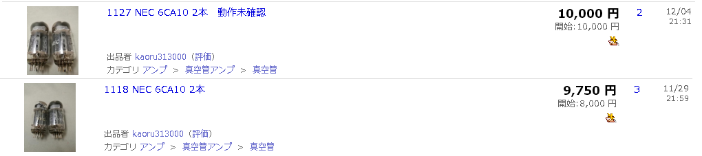

i have both of those tubes...what kind of money is there?
a quad of 8045, a quad of 6CA10, and a pair of 50CA10....
It's not Chinese, these are the auction prices in Japan, just divide the price on the right by 110 to get the dollar equivalent. Basically, each tube is about $60~$100 - most are second hand, not new (except for a few).
