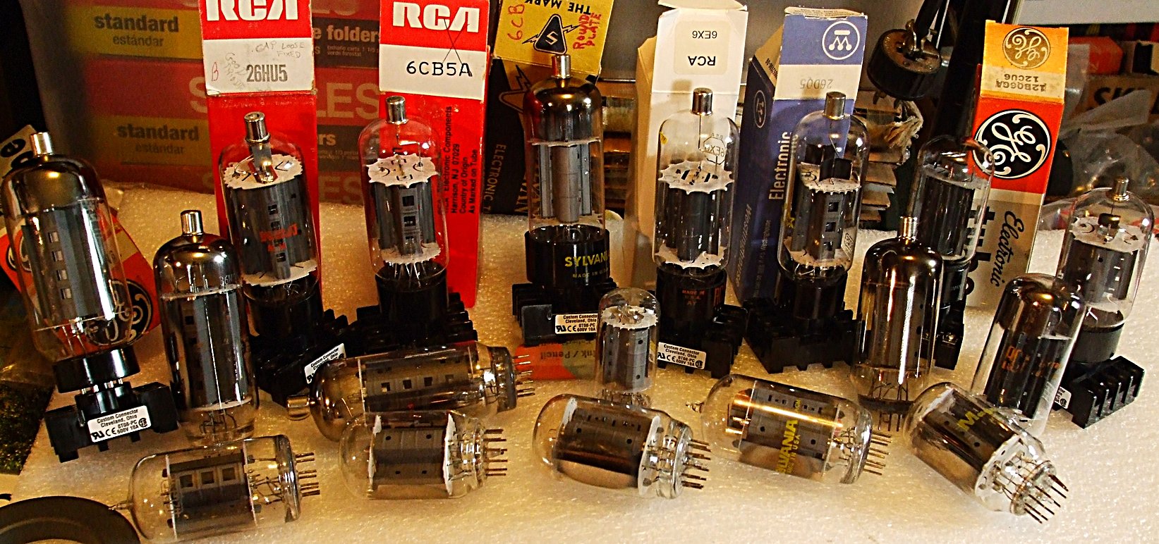

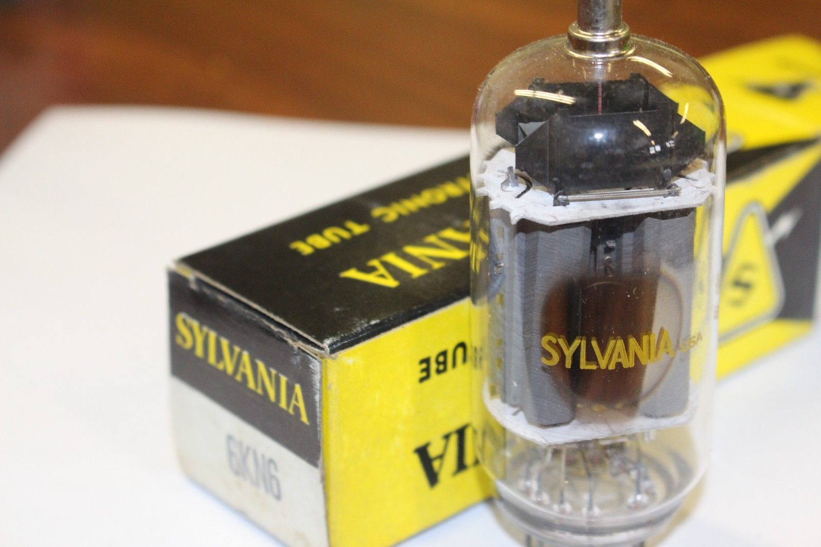

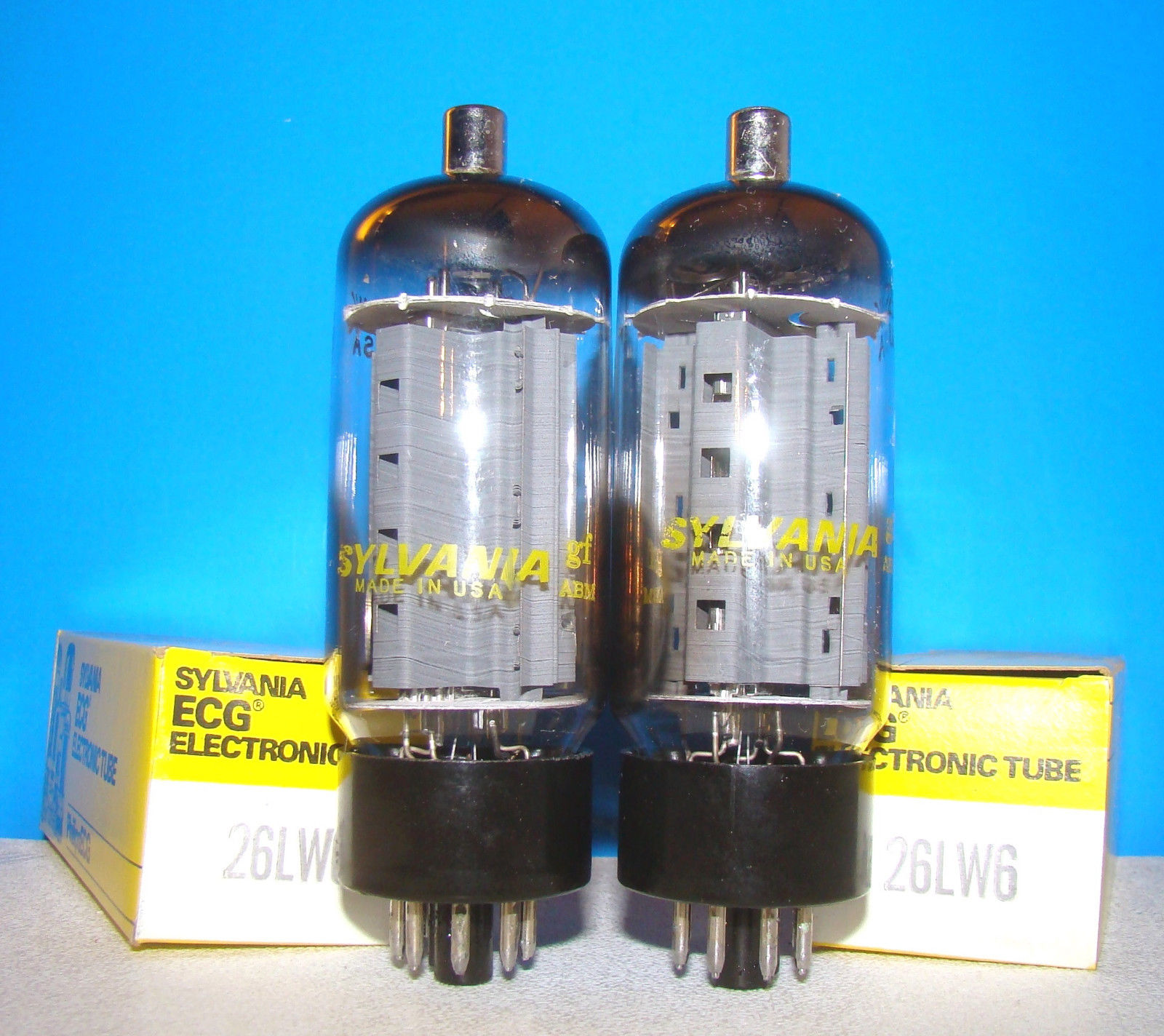

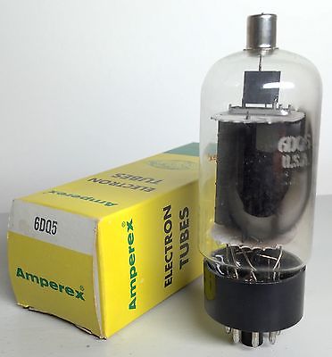

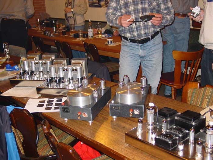

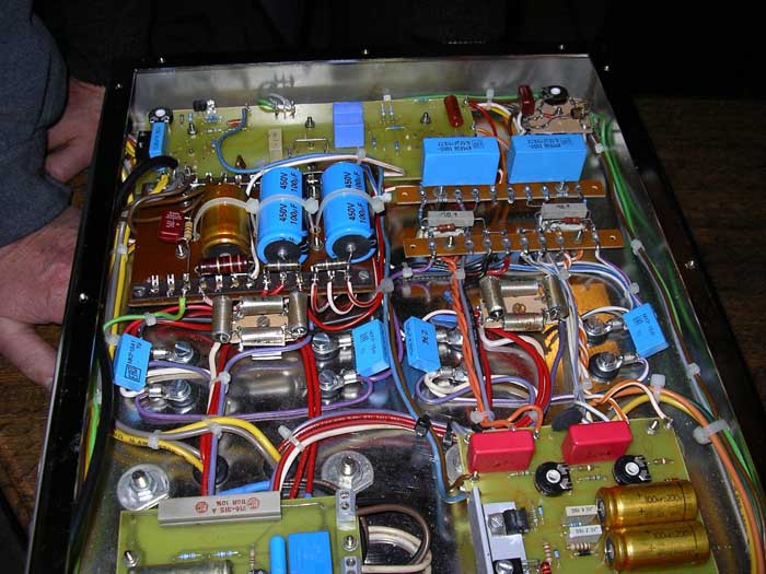

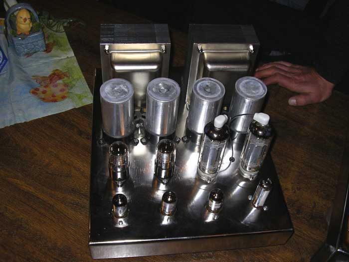

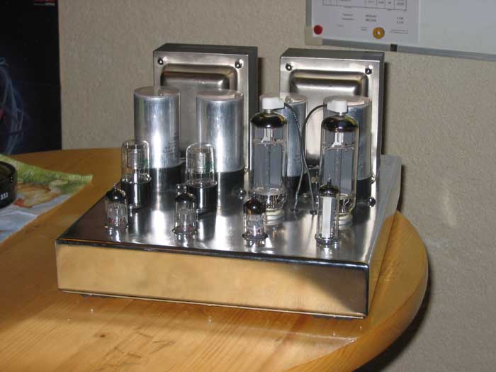

Btw, here are some pics of a set of rather powerful monophonic amplifiers I've built about 15 years ago. They make use of typical European sweep tubes.
Best regards!
Btw, on the 1st pic you see both mono amplifiers next to the left edge. In the lower right corner there's another amp of mine using PL519's. I've built this one very similar to a tehcnical bulletin that I've found at Svetlana's web site.
The 2nd pic sadly doesn't show any amp at all. Thiy simply was me about 13 years ago.

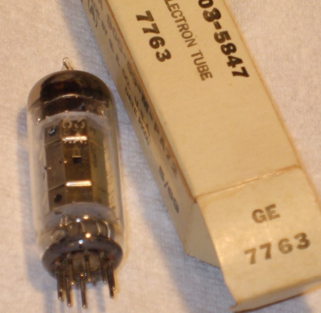

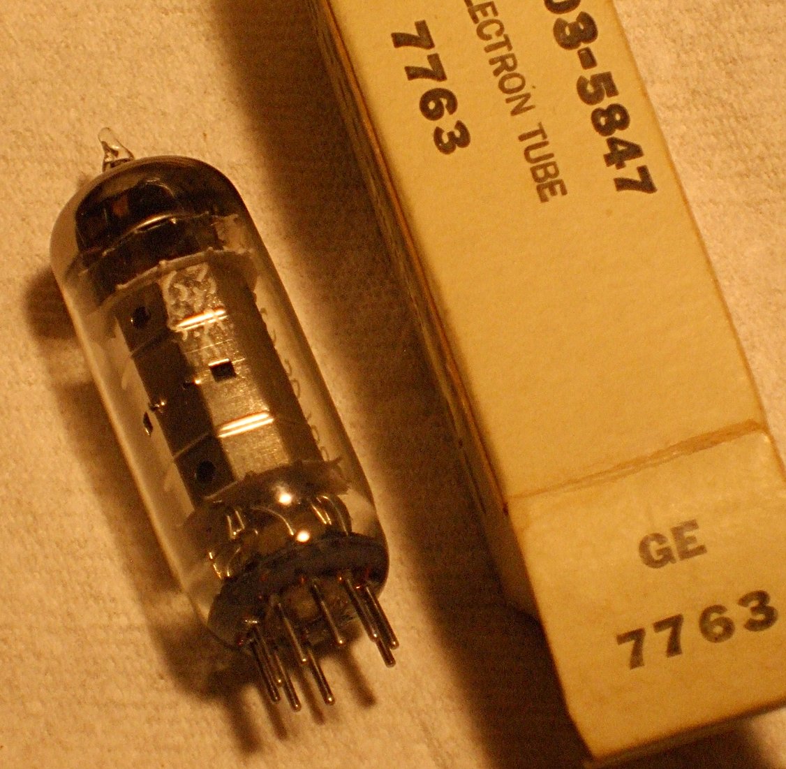

I just got in one of the rarest (and probably most useless...) tubes ever. The GE 7763 tube. Been searching for it for 15 years, this was the 1st time Google found something on it, and it was on Ebay. It's a beam deflection tube (BDT) with high (pentode like) gain. As far as I know, only evaluation prototypes were ever sent out by GE, but it came in a Mil spec box, so maybe some radio ended up using it. Could do the same function now with a $5 6JH8 TV tube and some JFET cascodes above the plates, but this was back in the 60s when it came out. If transistors hadn't come out, this would likely have been widely used in the IF strip of FM and AM radios and TVs. Hams used the 6JH8 for SSB generation. (single side band)
I'm trying to work out some way to curve trace some (differential) plate curves for it (like 6JH8 has on its datasheet). Likely hi-Z xfmr input and output. Once I succeed in that, I'll send it off to some tube museum I guess. Although, it could be used as the high gain differential front end to an all BDT (bank of 20 or so of 6JH8, 3 Watts + 3 Watts per tube) one of a kind amplifier. These BDT tubes are quite linear. I got a box of 6JH8 back in the Sale days.
http://tubedata.milbert.com/sheets/201/7/7763.pdf
http://tubedata.milbert.com/sheets/093/6/6JH8.pdf
The 6JH8 functionally looks like two low Mu (6) triodes above a CCS tail. The 7763 functionally looks like two pentodes above a CCS tail.
