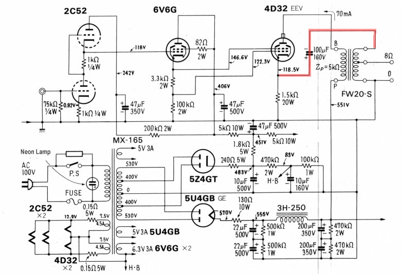

The "Twin/Crazy drive" thing came from an old RCA Ham Tips article. (no idea if there are earlier references) The J. H. Owens article (May-June, 1947 RCA Ham Tips), called it "special triode". See .pdf below.
It had a resistor between grid2 and grid1 of an 807 modulator tube. It shows graphs of the increased gm achieved but no mention of increased linearity. Tony found a more recent amplifier, initially, using a 4D32 with this setup, and further searching found an amplifier with a 12G-B7 in this mode. None of these mention anything about increased linearity. Only after the configuration was put onto a curve tracer did it become apparent that the R connection could be optimized for increased linearity besides increased gm. Further testing with the curve tracer made it apparent that a bottom 2nd resistor, grid1 to cathode, was helpful, and also that the initial drive signal needs to go negative to cathode somewhat, to overcome plate voltage effect for full turn-off. Vneg = 2 x (B+) x 1/(gm1 x Rp)
The auto-biasing Rk in the two cited amplifiers helps with this for class A SE operation.
http://n4trb.com/AmateurRadio/RCA_Ham_Tips/issues/rcahamtips0702.pdf

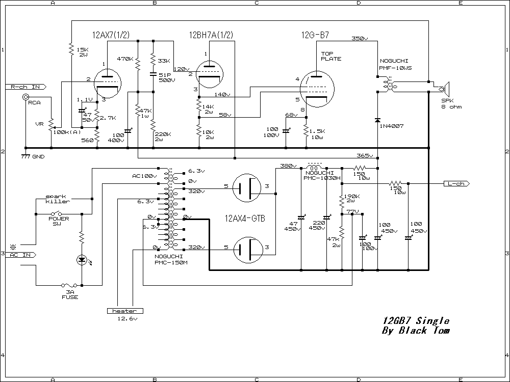

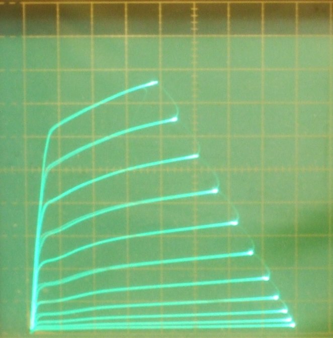

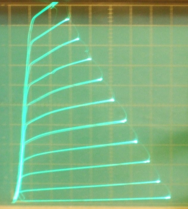

A frame grid 1 might be of concern possibly. I have tried the frame grid 12HL7 with Crazy/Twin drive on the curve tracer successfully. (for a few minutes at least) The saving grace there is that the consequent high gm1 only needs a tiny positive excursion to do its job. (and resulting total tube gm linearity was excellent)
a) 12HL7 Crazy/Twin
b) 12HL7 g1 drive

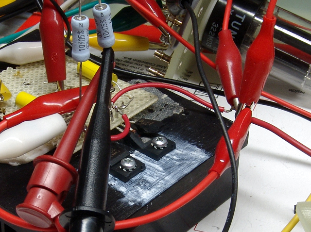

Driving G2 positive while the plate gets pulled to zero makes G2 very hot since it eats most of the cathode current. On the next half cycle that hot grid is at zero volts while the plate is somewhere north of 1KV....tube arc, parts explode, game over!

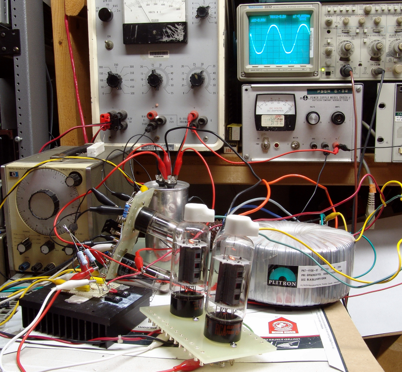

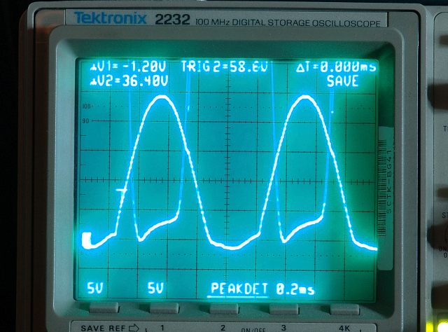

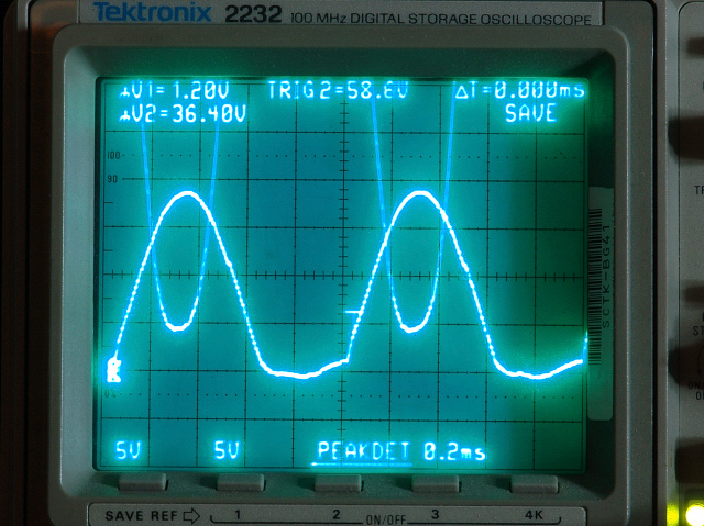

Two scope pictures. 50 volts per division, 0 volts is the second horizontal line from the bottom. This is a screen driven 6CB5 push pull amp with 550 volts B+, and a 3300 ohm OPT.
The first picture shows the amp being driven to a clean 80 watts out. The plate voltage (rounded trace) being pulled down to about 50 volts. The screen voltage is the flat bottomed trace. It swings from zero volts to about 180 volts. The amp runs fine at this level.
The second picture shows the amp being driven to a clipped 130 watts out. The plate voltage (distorted trace) being pulled down to 0 volts, settling to about 30 volts before heading toward 1200 volts. The screen voltage is the flat bottomed trace. It swings from zero volts to about 230 volts. The amp exploded but this trace was still in the scope's memory.
The third picture shows the test amp before blowing up, running at some mild mannered power level.
The fourth picture shows a mosfet with most of its case gone.
Dual drive began as a method to eliminate these kinds of events. This may never happen in "normal" use, but I have never been "normal" and any amp I build must be able to survive me plugging my guitar into it, and "setting the controls for the heart of the sun."

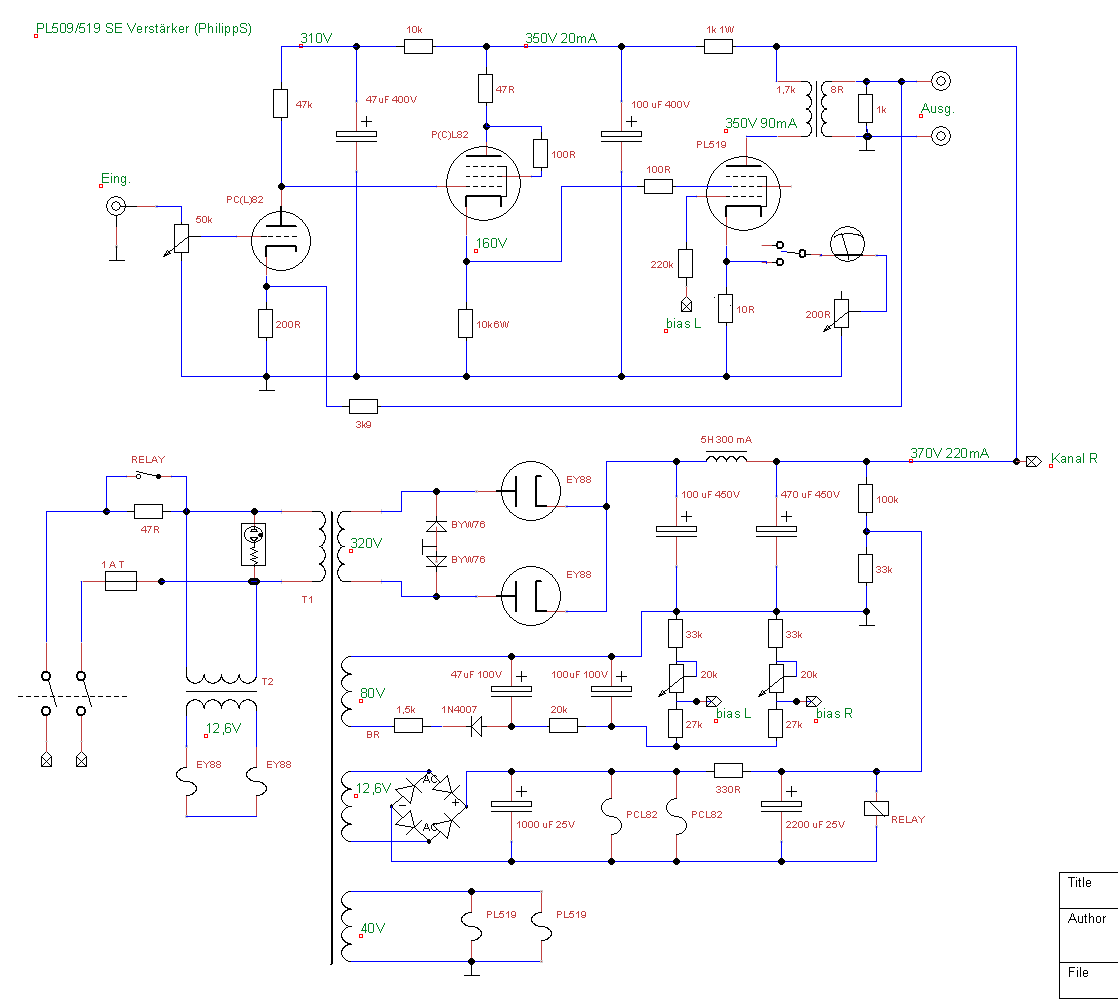

Hello Folks,
I just like to share my recent amplifier.
It uses television tubes throughout.
The circuit is inspired by the Synola 509 design and uses screen-driven PL519 (40KG6A) with fixed bias on g1.
I changed the preamp and driver tubes to PCL82 (16A8) and employed EY88 rectifiers. The output transformers are the ones originally designed for the Synola amplifier by Reinhöfer Electronic (1.7k primary).
The amp sounds very good, delivers about 10 Wpc.
I might want to try converting it to crazy drive just to see the difference.
Philipp
There's really no need to DC heat the PCL82. About 15 years ago I've built a similar stereo amplifier, featuring PL519's and PCL82's (as your's), PY82's as two way rectifiers and EAM86's as VU indicators. I've connected the heaters of one PCL82, one PY82 and one EAM86 in series, to feed them form the same 40 Vac windings that supply the PL's heaters. No hum at all.
Best regards!

Mickeystan built a P-P Crazy/Twin Drive amplifier here:
Those Magnificent Television Tubes
Oh, the 4D32 Amp.
I don't see why it couldn't be converted to P-P. Only thing is the CFB in that design is really making for excessive drive voltage requirements at grid 2. Not sure how much the CFB helps if one already has the stage gm linearized. (maybe it is mainly for lowering the output Z, since Twin/Crazy drive alone is high output impedance)
The CFB may be a small percentage there, since it is being played off against g2 drive voltage, so not having a lot of N Fdbk effect. Just making the drive V situation worse. The driver distortion may go up faster than the CFB brings down the output stage distortion.
One -WILL- have to address the output impedance in some way, since the Twin/Crazy Drive is high output Z by itself. Getting sufficient CFB to do much Z lowering though will incinerate the driver stage when combined with grid 2 drive requirements. Like a total cathode follower output stage running on grid 2!!! Suggest some other (global) approach. Or "Schade" back to the driver cathode.
Oh, the 4D32 Amp.
I don't see why it couldn't be converted to P-P. Only thing is the CFB in that design is really making for excessive drive voltage requirements. Not sure how much the CFB helps if one already has the stage gm linearized. The CFB may be a small percentage there, since it is being played off against g2 drive voltage, so not having a lot of N Fdbk effect. Just making the drive V situation worse.

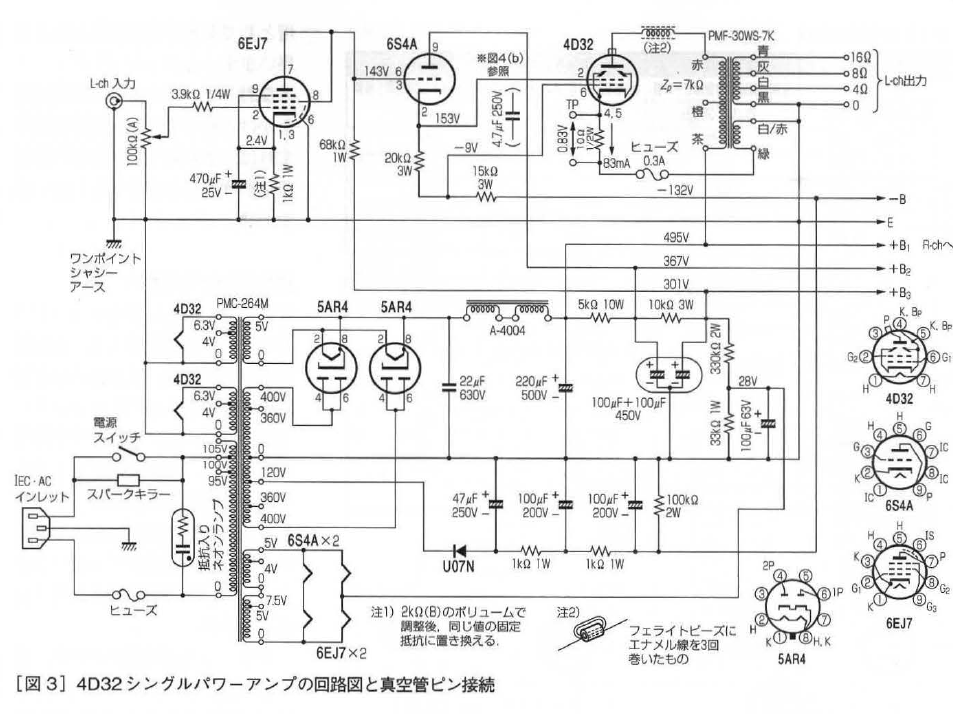

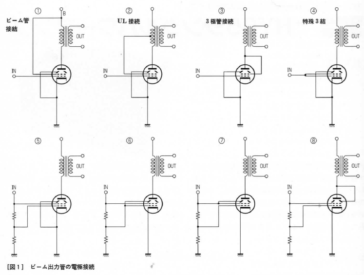

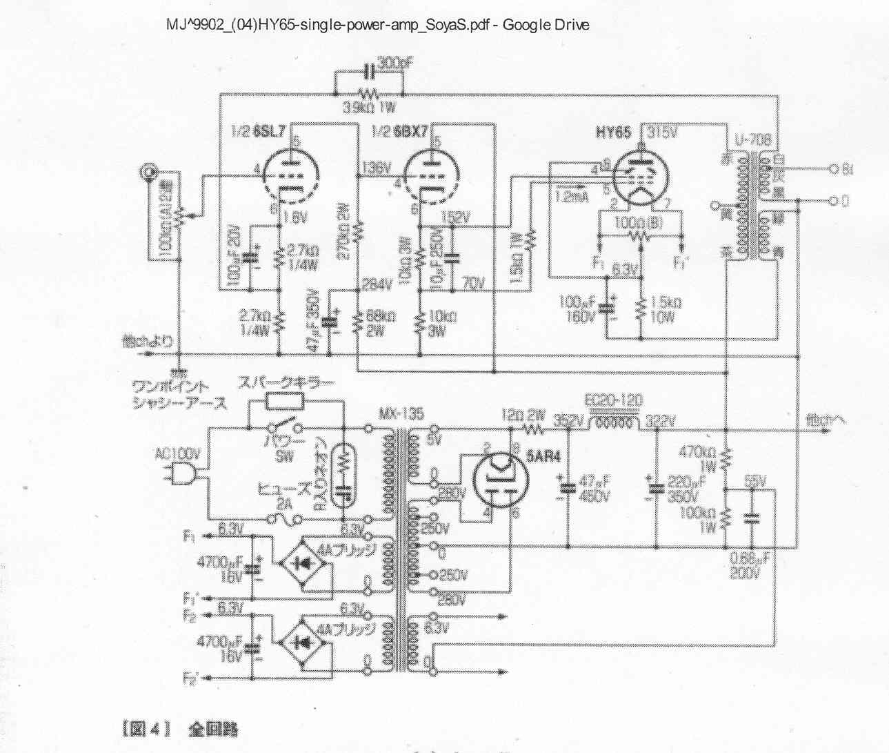

Any luck finding the missing page in the Susumu MJ 1999/2 article?
While browsing through the MJ archive, I came across the "HY65 CF Direct Coupled G1 G2 Simultaneous Drive Ampliifier" by Soya Susumu, which looks like the "Crazy Drive" scheme from smoking-amp, unfortunately, page 121 is missing from the article, thus leaving out an important part - the Ep-Ip characteristic of the HY65 with both G1 G2 driven. Would anyone know how to get a copy of the missing page?
Here is the link to the article: MJ^9902_(04)HY65-single-power-amp_SoyaS.pdf - Google Drive
Looks like all the schematics using the Twin/Crazy drive scheme in the article end up with a big capacitor between grid 2 and grid 1, which won't work for linearization. (and would be dangerous for grid1 !!)
