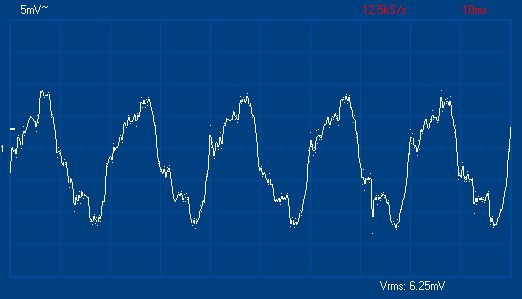

oshifis said:Hi Sándor,
I recommend the following:
1.) Disconnect the DAC from the tubes. If the hum is still there, it is in the tube stage. If not, there is a ground loop with the DAC.
2.) One end of the filament should be grounded.
3.) Inter-stage shielded wire is not always a good idea. Try twisted wire from UTP Ethernet cable.
4.) I would not put the AC socket so dangerously close to the analog stage.
5.) A good test is to disconnect the AC power from the three transformers one-by-one with a temporary switch (with caution, shock hazard!) for a few seconds, and see if the hum ceases.
1) Disconnecting the DAC does not help. The hum is generated by the output stage.
2) I have tied the filament to ground both directly at one end, and with two 120 ohm resistors and center tap. No change. During the short time immediatly after having disconnected the E88CC filament, the hum is still there. Then it strongly increases and short after the signal (of course) vanishes.
3) I use a shielded wire to connect the anodes, in the center of the board, to the output connectors at the left and right ends of the board. I have not tried with a twisted pair. Do you think it is a worthy mod?
4) During tests AC power was directly connected near that blue transformer (please see picture)
5) In the analog stage there is only one transformer. Those devices below the output stage board, that look like transformers, are the two anode chokes.
Andypairo said:Hi,
do you have access to a scope?
If so give a look at the hum waveform and see if it is related to the PSU ripple.
Please look at the attached image taken from a Velleman PCS500 DSO (H=10mS/div V=5mV/div). The level of the signal is 6.25mV RMS and it is clearly related to the 50Hz power line.

HUM PROBLEM SOLVED!!!
I have rotated the two anode chokes (right channel 90 degrees and left channel about 45 degrees) and the hum is almost disappeared.
What is the cause of this strange behaviour?
Is there a way to shield the chokes (or supply transformer and choke) so that the hum level is independent from the orientation of the chokes?
