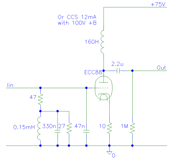

Hi all,
I'm finally completing my DAC using the "ultimate" tube out suggested by Thorsten.
I have a doubt about the L in the sinc correction network, is a cored inductor suitable or do I need a air-cored one?
Could someone suggest a part number?
I repost the schematic:

Konnichiwa,
I use barel cored, panasoni ELC Series Chokes. No part number handy.

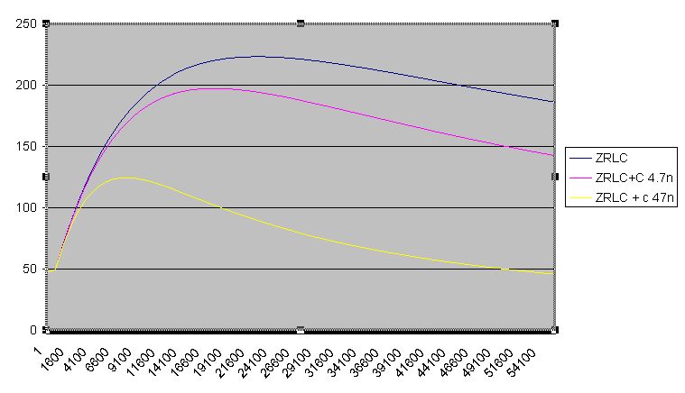

RLC question
Hi Thorsten,
as always you have been very helpful.
But to pull your leg further I have another question.
The 47 nF specified for the capacitor that goes paralleled to the R+RLC network shows, at a quick simulation of the impedance, something wrong.
Did I miss to see the decimal point? With a 4,7 nF the impedance seems more reasonable for a anti-sinc filter...
PS the overall impedance of the network seems a tad high for the specified compliance of the TDA1541A. Did you find this value to be a good compromise between useful signal amplitude and linearity of the current sources?
Cheers
Andrea

Re: RLC question
Konnichiwa,
I think you are right. I need to check.
Yes.
Sayonara

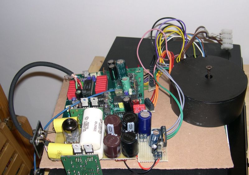

Sings sweetly...
Hi all,
I completed my tube stage and it really sings.
The only difference from Thorsten's indications is the plate voltage, that is somewhat lower than the 70-75V expected.
Upping the current to 15mA/tube I get to 60-65V, not really a problem but worth mentioning.
Here is a pic of it (most of the components of the I/V stage are wired P2P on the underside of the board)

Re: Sings sweetly...
Konnichiwa,
My numbers are for a "bogey" 6DJ8, the 6922 and 7308 et al will differ enough to throw the numbers out a little. The Choke loaded version would simply let the circuit find it's own right current.
