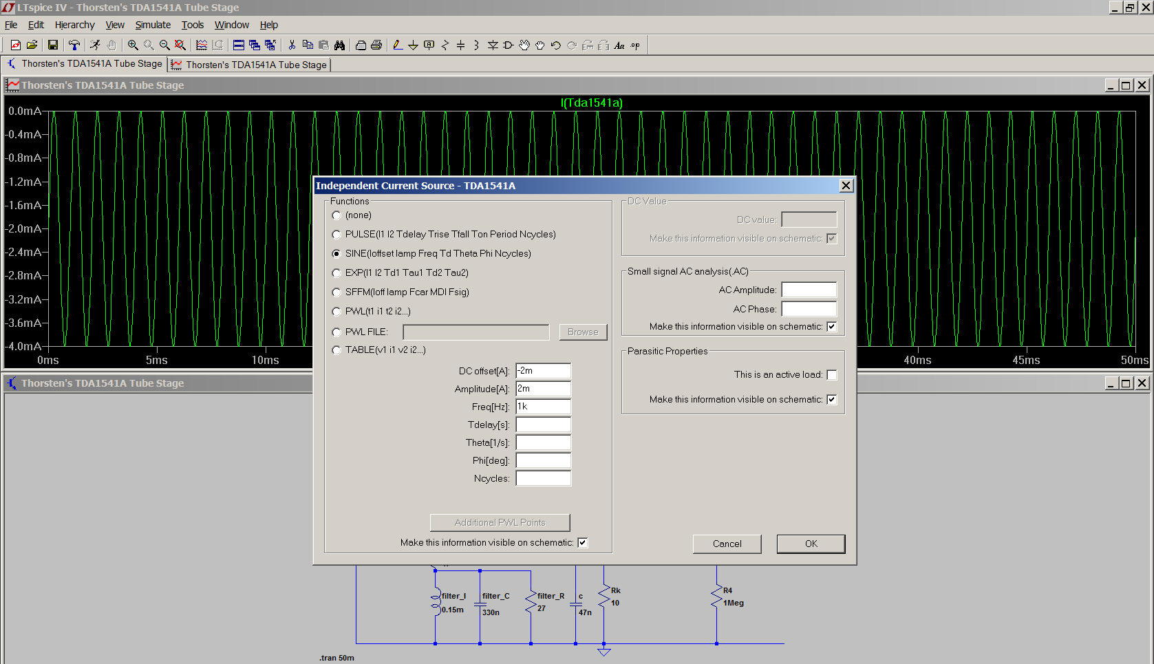

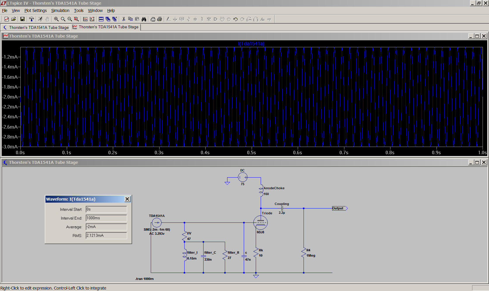

Thanks to kevinkr who shared his tube libraries and also guided me towards LTSpice, I did my first LTSpice simulation using Thorsten's tube stage from post #1.
However, I am rather confused that why 😕 I am getting 14v PP and the output.
Here is the screen shot and LTSpice file, kindly take a look (zip folder has LTSpice file) and guide me what I am doing wrong. I suspect something is off with units.

First put some extra viewpoints on to measure also the input to the tube.
I would suggest that either your stimulus is wrong (maybe you mistook peak for RMS when entering numbers?) or the 6DJ8 Model is wrong.
Placing the extra viewpoints will make clear which it is.
In theory real 6DJ8's have a Mu of around 30 and with 4mA Peak-Peak and 47 Ohm we get 0.188V Peak-Peak, multiplied by the gain of 30 it gives 5.64V Peak-Peak or 1.994V RMS...

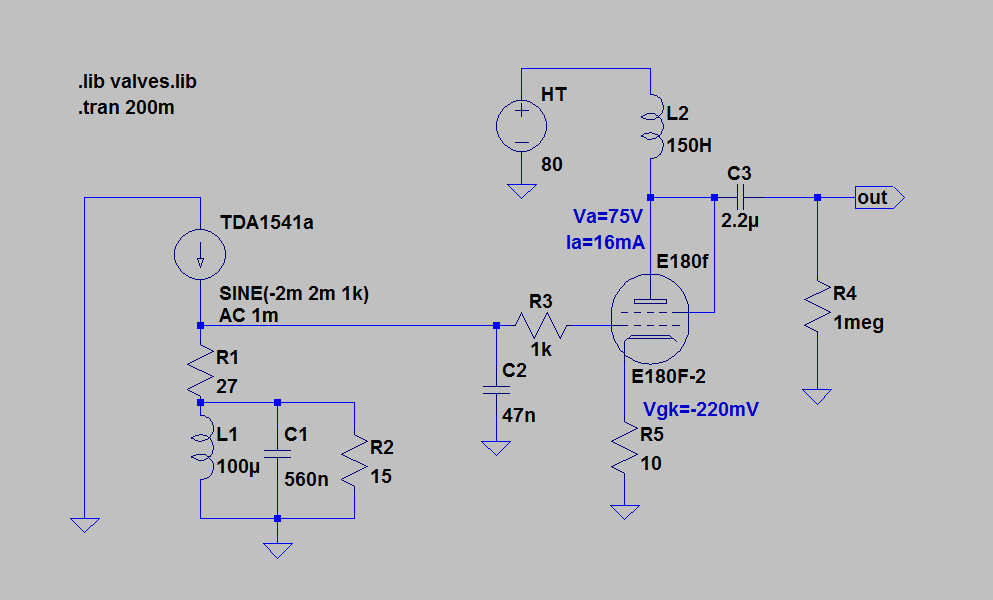

For fun you could try using the E180F triode connected and with the I/V circuit scaled to give you the desired output. For 2V out the I/V resistor becomes 27R and the LCR for the anti-sinc filter scale suitably. The E180F will have lower noise than the 6922 and NOS E180F are not difficult to get and do not quite carry the same silly pricetags as NOS 6922 style tubes.
Based on the Mullard Triode curves the operation will be 75V/12mA, gain is around 50 if CCS or Choke loaded. Output impedance will be around 2.5K.

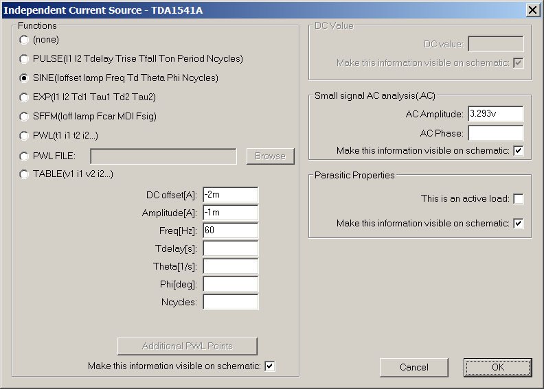

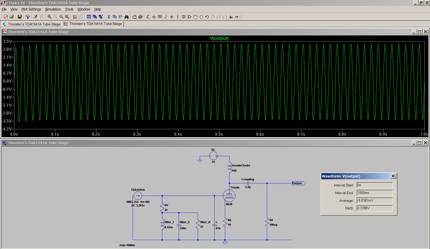

Thanks Thorsten.
Here are the pictures of new results for which I used DC offset of -2mA, Amplitude of -1mA (in LTSpice Amplitude is defined as "the undamped amplitude of the sinusoid; i.e., the peak value measured from zero no DC offset value"). Here is my understanding. -2m DC offset represent digital silence and thus the output of TDA1541A modulates around -2mA instead of 0mA. Thus -4mA Peak to Peak becomes -2mA Peak to Peak (-4mA less -2mA DC offset) and becomes -1mA peak to be used in LTSpice as defined by LTSpice definition of amplitude. Am I correct or just misjudging.
Using these value in LTSpice, I get DC operating point of -94.002mV on grid of 6DJ8 and 2.3398V at output.
I don't use LT Spice, but something sounds still wrong.
The DC offset is now right, but the Peak value should be 2mA, in other words a full scale sinewave covers 0mA to -4mA.
What is the AC input voltage to the 6922?
Ciao T

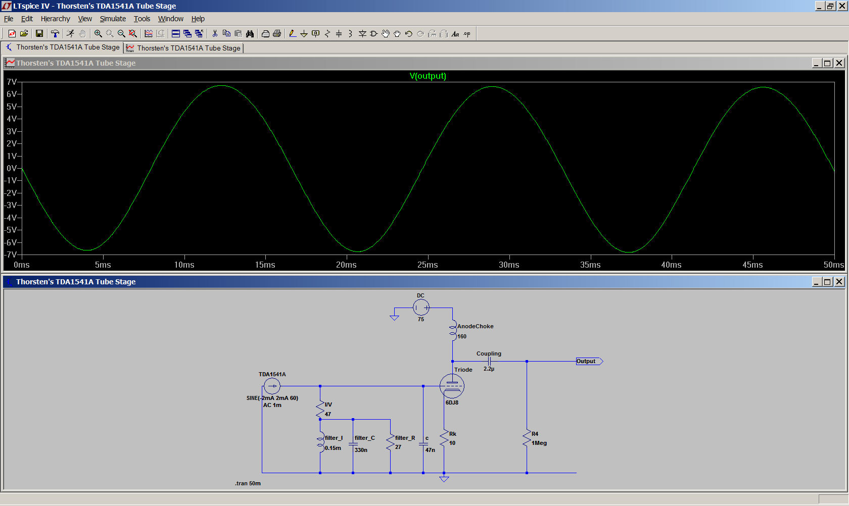

L=160H
No series resistance!
Typical resistance are 200-400 ohm.
With 300R resistance output RMS 2.7V.

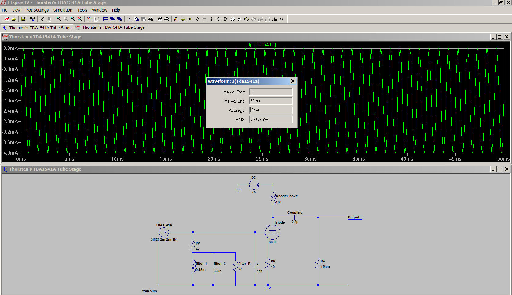

Thanks and Thanks to Thorsten too. I added 300 Ohm to inductor but same results. I think Thorsten is right, my source is not correct and I am doing a great unknown (at least to me) blunder in LTSpice.
Please see the first screen shot. With -2mA DA offset and 2mA peak, the Peak to Peak current is 4mA, however, as it can bee seen in second screen shot that strangely the RMS is very high at 2.4494mA instead of 1.414mA.
Can someone please help me fix whatever is going on in LTSpice?
What is the P-P voltage directly at the I/V Circuit, before the tube?
Ciao T

Hi Thorsten,
Many thanks. See attached simulation. Seems ok with a gain of about 34.74dB and producing an output of 2Vrms. Left bias point to -0.22V where the gm is quite high. will you reduce the bias? Anode current is 16mA with 75V - at least that is what you get with the spice model around.
What is the role of C2 here?
Also added a grid stopper as well.
If everything is ok, will replace the anode choke with a gyrator...
Ale
Sounds all on da money.
Ultra-ultrasonic rolloff. Scale the same way as the Cap for the LCR.
Try keeping it at 100 Ohm or less (I often use 10R AB or Xicon Carbon Composition resistors), otherwise you add too much noise. If you feel adventurous use only ferrite beads directly on the tube pins.
Ciao T

Fantastic, thanks Thorsten. Will reduce C2 and change grid stopper. May try ferrite beads though...

C2 must be increased as we reduce the I/V resistance.
The simple circuits do not necessarily provide good results.
Ciao T

....What is the P-P voltage directly at the I/V Circuit, before the tube?....
Thanks Thorsten. I am sorry for letting your helping hand hang in the air, I was involved in a small accident. Will post in fews days.
