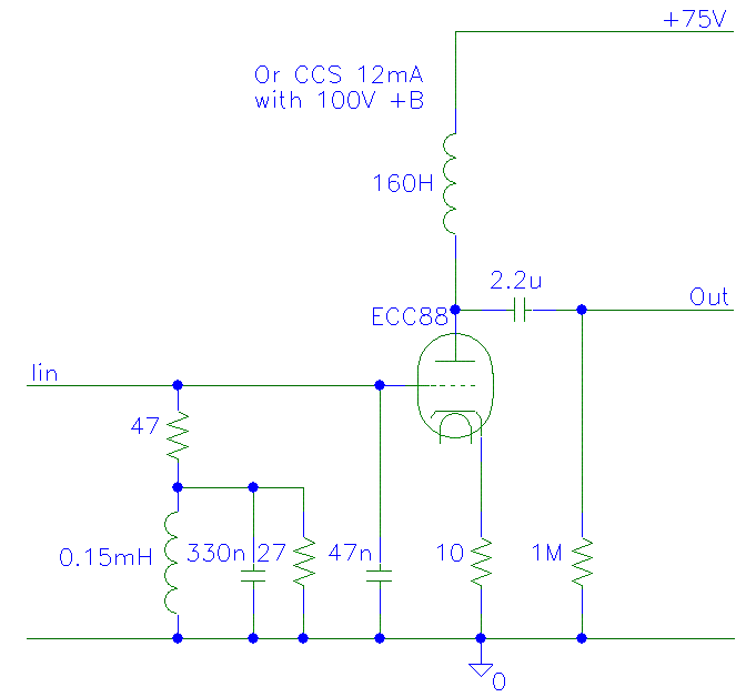

hi this design sparks my interest. it will be my first tube project should i try it. what kind of power supply circuit do you recommend?
Start with the known-good basics
Damper diodes or tube rectifier into CLC (aka Pi) filter. And run AC heaters.
if you can't find an inductor use a resistor dropping at least 20V.
Hexfreds if you must use hard rectification;
You can mess around with other architectures later.

KISS
Noise and simplicity.
Rectifying AC creates noise which may get from the heater to the cathode. Batteries have their own problems.
If the valve has good heater noise rejection; then there's no point in going away from AC. Which is conveniently the simplest thing to build.
Given that we're talking about low level signals we want to minimise the noise sources.
Why ac heaters?
