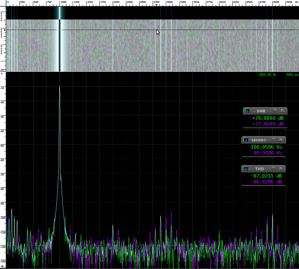

True, here are real measurements :
The original I/V & Tube gainstage at the start of this thread was designed to have a low enough output impedance (around 2.5KOhm) to not cause any major issues, unless the Power/Pre/Integrated Amplifiers input impedance is below 10KOhm. No buffer stage is used.
Oh well, I was talking about I/V conversion using Op-Amp. The super common grid has the same output impedance (2.2kΩ which is the plate resistance).

I have seen worse, but you seem to have lot of spuria in these FFT's and you cut the FFT off at 5KHz.

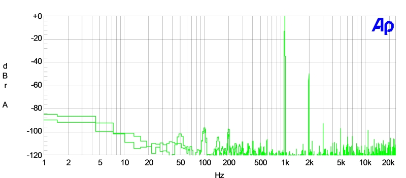

Attached one of mine, TDA1541, passive I/V and open loop tube gainstage at 0dbfs, this is without oversampling or other digital filtering, 44.1KHz sample rate.
It can be seen there is "much" 2nd HD (about as much as most speaker drivers produce at 1 Watt input power), but all higher harmonics are < -90dB. The 2nd HD falls quite quickly with lowering level...

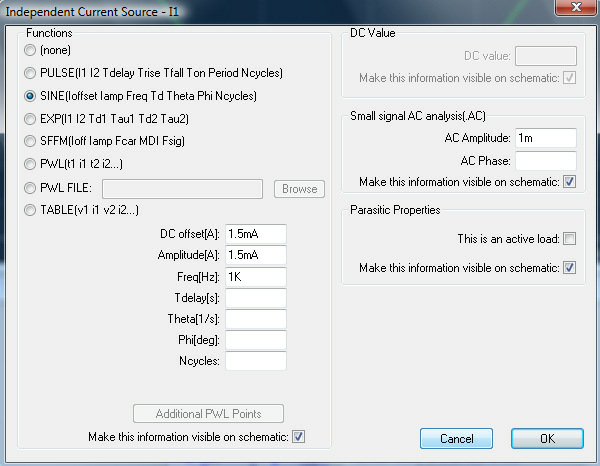

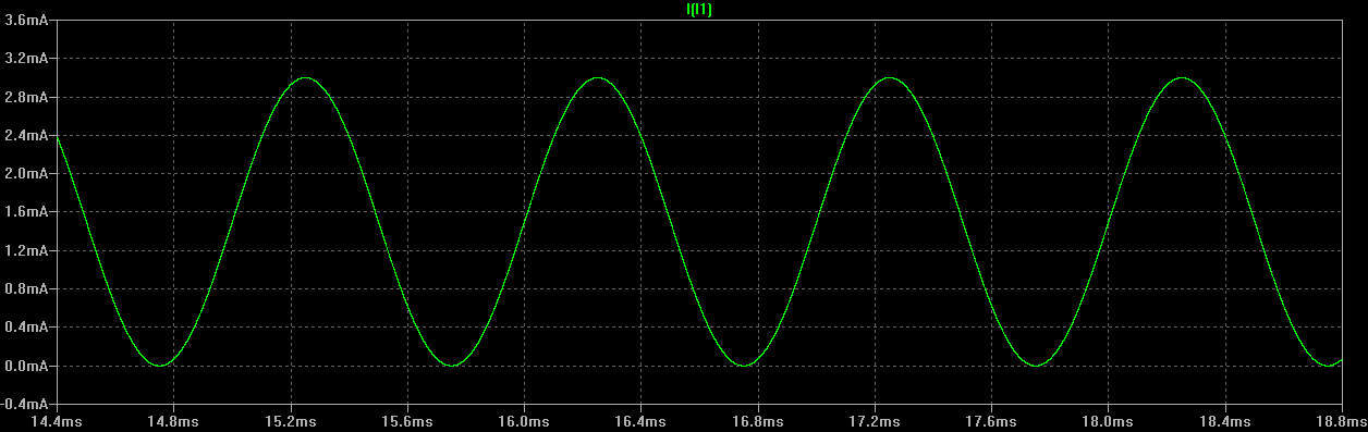

Wow! euro21, that you so much🙂, you are the Man. Can you please share that you just ran the simulation on my insistence or you have actually built it?
I have downloaded LTSpice and will be experimenting with it. Can you explain what does the SINE (1.5mA 1.5mA 1k) means at the bottom of the screen shot. My guess is 1k sine wave from 1.5mA current source?

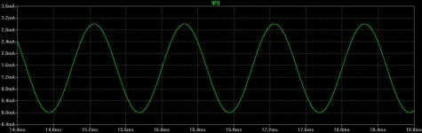

This is only the simulation.
The current source represents 1541a, 1.5mA offset, and 1.5mA amplitude sine (1KHz).
That's interesting to see how an open-loop circuit produces high level of H2 whereas high feedback schematic will cancel them and only produce low levels of H3 and H5.

The TDA1541 is rated as having a -4mA (peak-peak) output nominal, with digital silence hence at -2mA. The tolerance range is given as 3.4 to 4.6 mA, however in my experience the spread is considerably smaller in reality.
To model the TDA1541 use a -2mA offset and a 2mA peak (1.4mA RMS) AC current source.

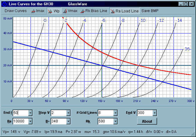

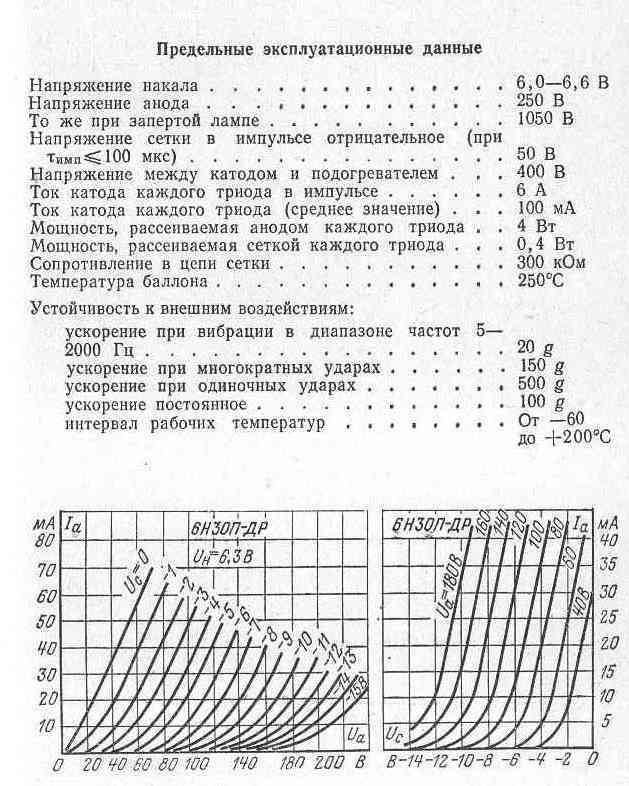

My data sheets for the 6N30 show around 70mA anode current at 70V and 0V on the grid. I doubt this circuit can work well outside a simulator, with over 5W Anode dissipation per section.
Little overdissipated tube. 🙂
Anode dissipation limit is 4W/sections. Fool-proof safe range up to 80-85%.
English version:
Glass Tube 6N30PDR

For fun you could try using the E180F triode connected and with the I/V circuit scaled to give you the desired output. For 2V out the I/V resistor becomes 27R and the LCR for the anti-sinc filter scale suitably. The E180F will have lower noise than the 6922 and NOS E180F are not difficult to get and do not quite carry the same silly pricetags as NOS 6922 style tubes.
Based on the Mullard Triode curves the operation will be 75V/12mA, gain is around 50 if CCS or Choke loaded. Output impedance will be around 2.5K.
So the Tango TC-160/15W Choke will be usable as Anode Load choke, otherwise Magnequest may have a suitable item or a CCS (IXYS 10M450 preferred) can be used. It is important to orient the chokes for lowest Hum.
