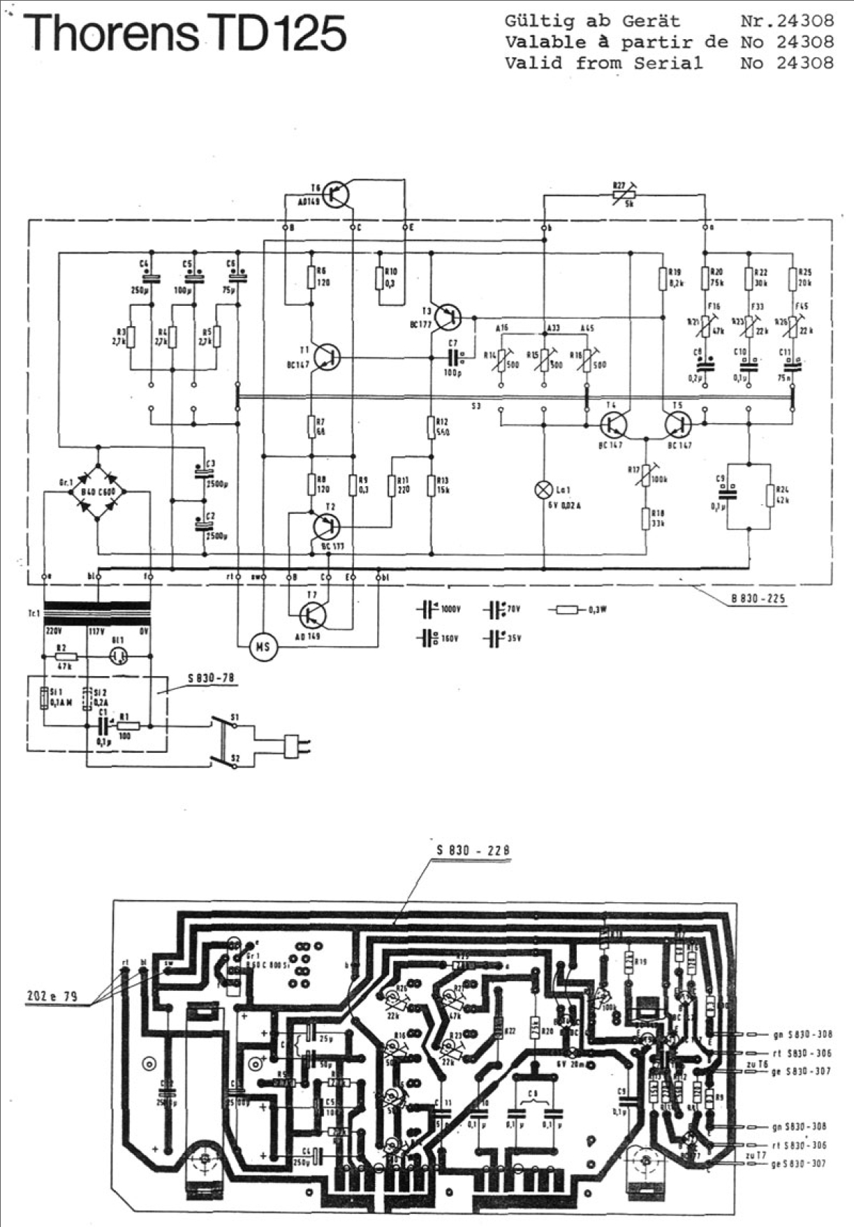

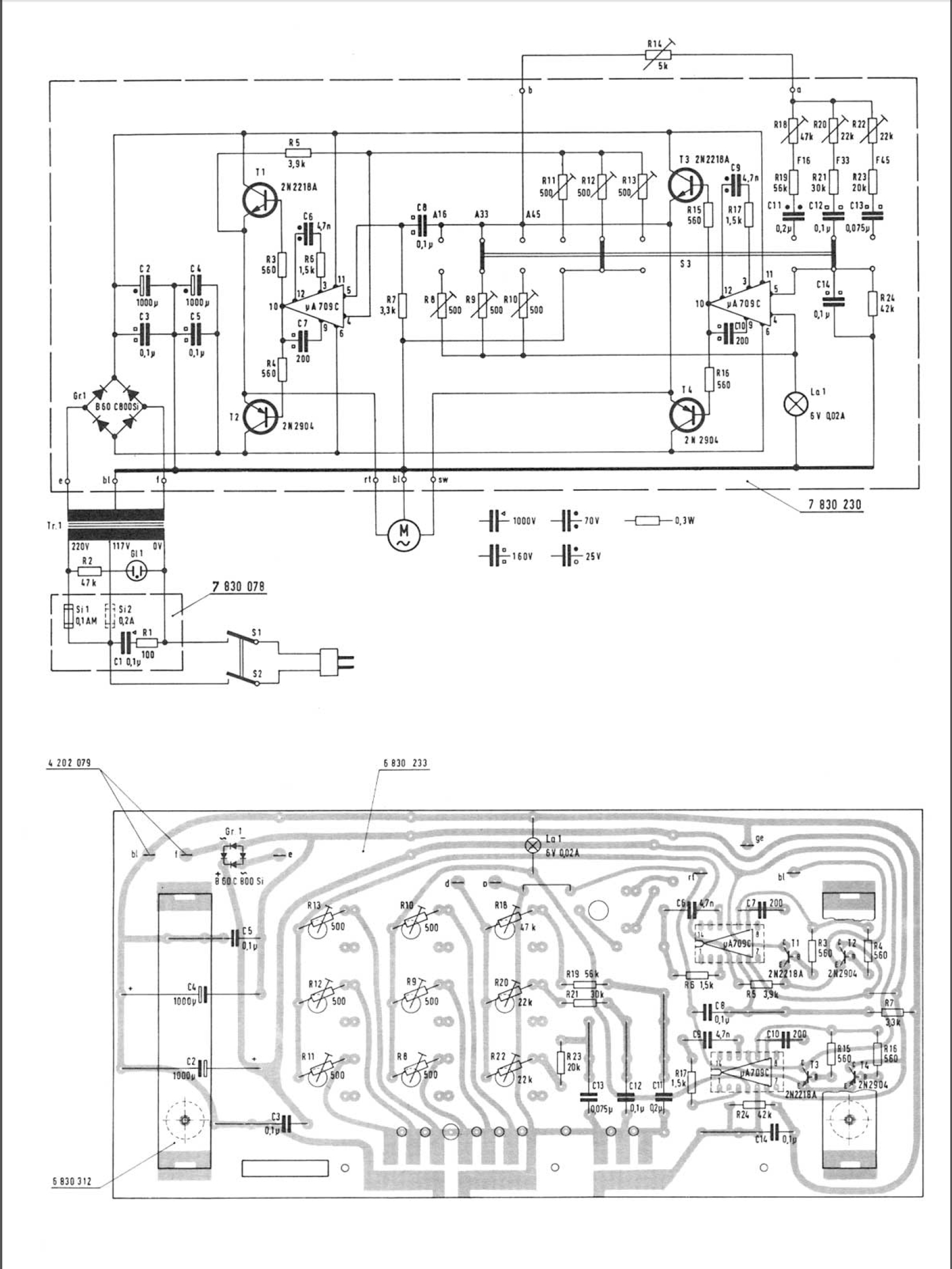

Dear gurus, I have a working PCB of the thorens 125 MKII turntable and a working motor of the MKI. PCBs as well as the motors of mk1 and mk2 are not the same. But is it possible to modify PCB of the MK2 to work well with the mk1 motor?
Here the photos of the both PCBs.
Defference in the motors
MK1 seem to be a 12V version motor
Coils resistance is
11.8Ohm red-black
9.3Ohm blue-black
MK2 seem to is a 16V version motor
Coils resistance is
29Ohm red-black
27.3Ohm blue-black
Here the difference in the trimpots to correct the speeds:
Connect meter (dmm) to test points ge and rt (phase 1) and adjust:
45rpm set R10 for 6V (R18 for 8V on the MK1)
33rpm set R9 for 5V (R16 for 5V on the MK1)
16rpm set R8 for 3.2V (R15 for 2.5V on the MK1)
connect meter to test points ge and bl (phase 2) and adjust:
45rpm set R13 for 6V (no pahse 2 ont the mk1 pcb)
33rpm set R12 for 5V (no pahse 2 ont the mk1 pcb)
16rpm set R11 for 3.2V (no pahse 2 ont the mk1 pcb)
Speed adjust:
set pitch control to centre position and adjust:
45rpm set R18 for stationary display on strobe ring (on the mk1 R29)
33rpm set R20 for stationary display on strobe ring (on the mk1 R28)
16rpm set R22 for stationary display on strobe ring (on the mk1 R27)
What could I do on the PCB mk2 to make a correct work with the mk1 motor?

All this was many thousands of posts back in time for me...... and without re-reading it all I can't remember a lot of the detail and what test you gear you had. I think you had a scope though ?
The second board seems to drive the motor from a bridged amplifier.
First question. What is the original motor doing when wired to the new board ? Is it rotating ?
Without seeing one for real I can only guess at things to suggest. You could try driving the motor from just the right hand amplifier and connecting the Rt lead via a cap to the positive rail (as in the other board).
Ultimately it may not be possible without a lot of research and work.
You need to see what the amplitude of the drive signal is from each board. Are they similar ?

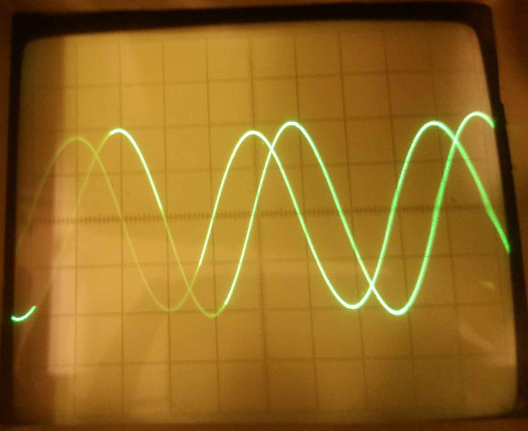

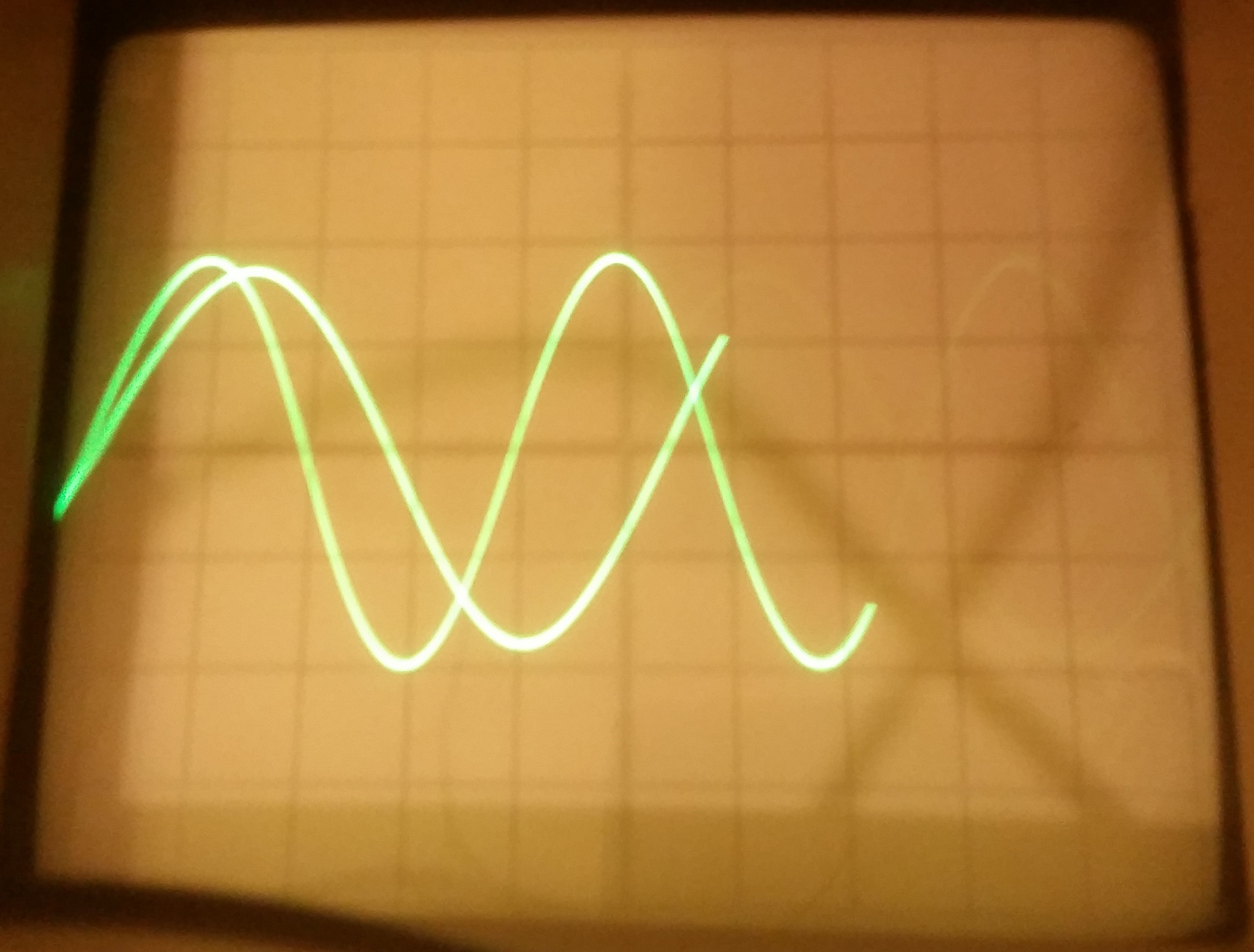

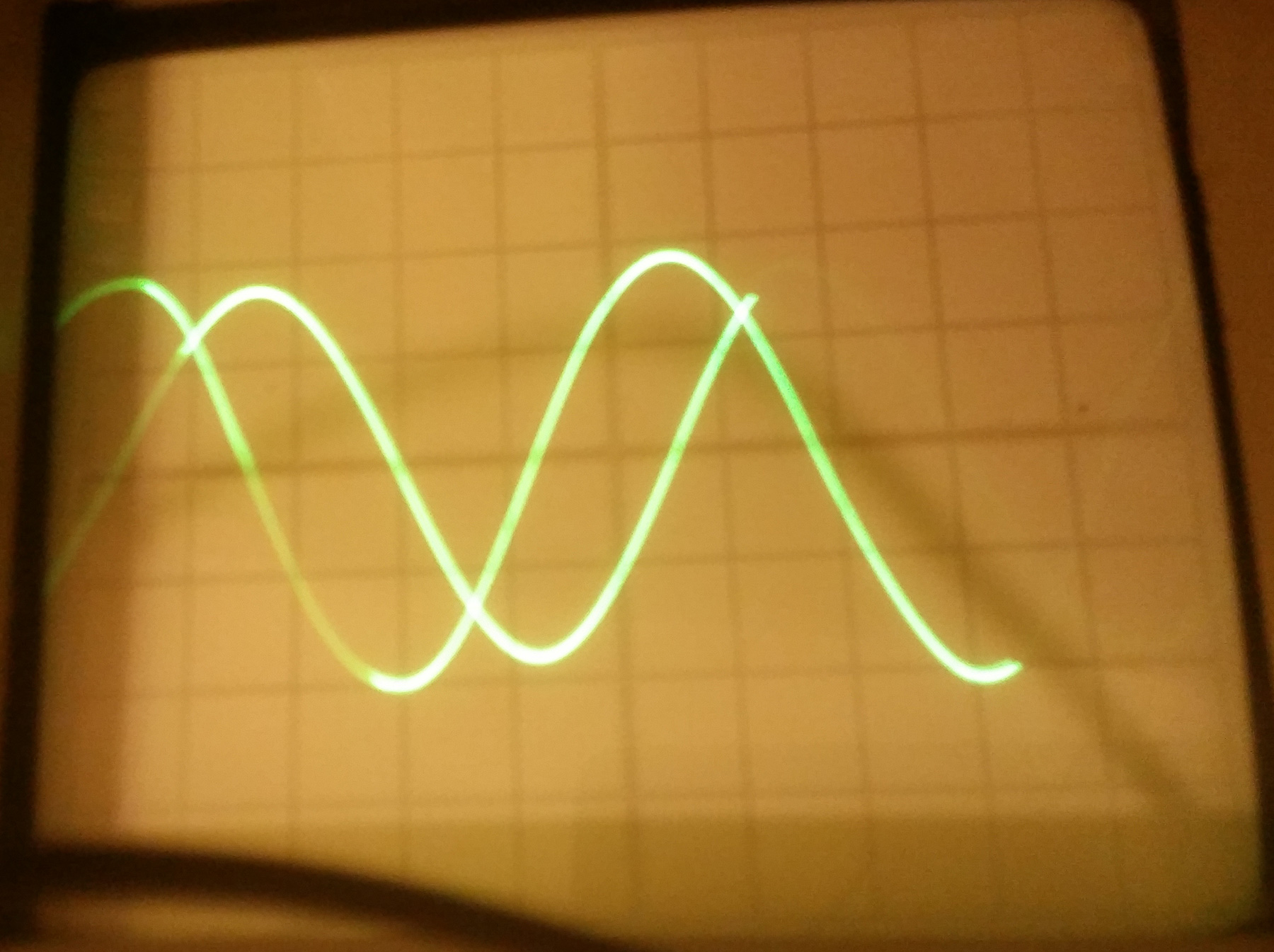

Measurement was done on the 33rpm where was the same 5v voltage on the pots.
So on the working decks amplitudes are the same but the frequencies are different!
The height is the voltage amplitude. So both are similar.
The width is the frequency, so the wider one is running at a slower speed.
Because the amplitudes are similar, I think the first thing is to try and couple the MK1 motor in a similar way to the original MK1 board which means connecting it via a suitable value electrolytic cap to the positive rail. Then see if it spins up OK.
Disclaimer 😉 you are going to have to decide whether the MK2 board can deliver the current required with those smaller transistors. So be careful and take it slowly. No guarantees with any of this and you are going to have to do a lot of experimenting yourself to see what works and what does not.
