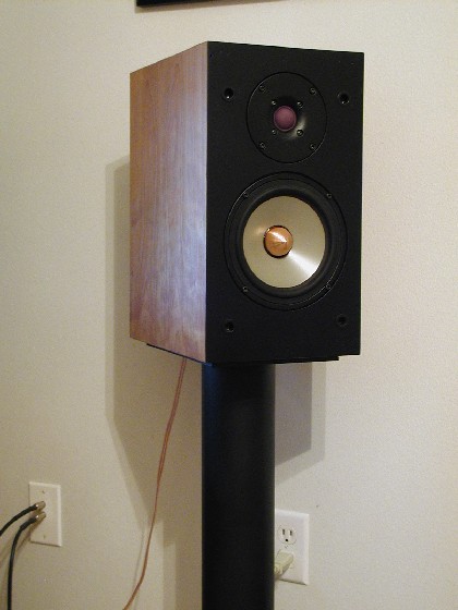

nbaula, here is a photo of my 1/2 odin.

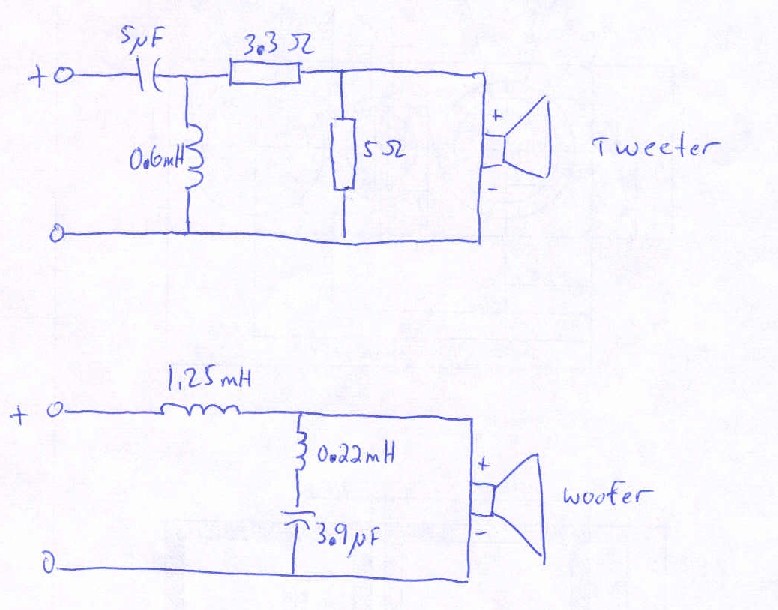

Would you post the XO of the 1/2 Odin, and some data about the cabinet?
If not here, please send me a mail! I'm very much interested because I have 4 ODIN loudspeakers now, and I want to modify 2 to THORs, 1 ODIN to remain as a central speaker and I'll need 2 more 1/2 ODINs or THORs as surround speaker for a home theatre set.
My address is: tutekov@hotmail.com
I would appriciate your comments on the sound of the 1/2 ODINs. I use Madisound XOs in my own ODINs.

Asen, I will go thru my stuff and find the documentation I have on the 1/2 odin. I am very pleased with the speakers. I can listen for hours to them as they are not fatigueing. The bass response is very impressive. I have a sub that I dont even use anymore except if watching a movie. The speakers are very smooth and are laid back sounding. I have not heard anything I have liked better since I have had these. When I get my information together I will post it.
Mike

Asen, here is the detail on my speaker, I hope it is legible.
Volume internal 14 litres
material 3/4 MDF
w=8.5"
h=13"
d=11"
vent to rear 2" pvc 8" long
acoustic foam sheet 1" thick on all interior walls except front.
I have the correct internal volume but I made walls 1.5 inch MDF and also changed the dimensions some.
Mike
