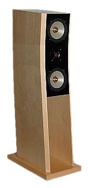

thor vs odin
Here is a picture of my Thor.

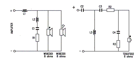

Yes, Thor can be modified into bi-wire.
This is very simple indeed. When you attach your xover components, do not connect the treble with the mid\bass. Instead of one wire you will have two wires, which you connect to two pair of binding posts.
Christer

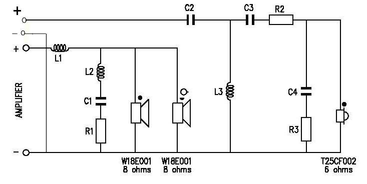

Re: bi-wire THOR
tomchaoda said:
ChriSKa:
Is this what you mean? (Sorry I am new guy in this area!)
Thomas
What I meant, but didn't quite explain, is that you make two xovers. One for treble and one for mid\bass. This way you'll have the possibility two make them bi-wire. I can send you a picture, but I'm at work, and I'll have to draw first 🙂
Christer

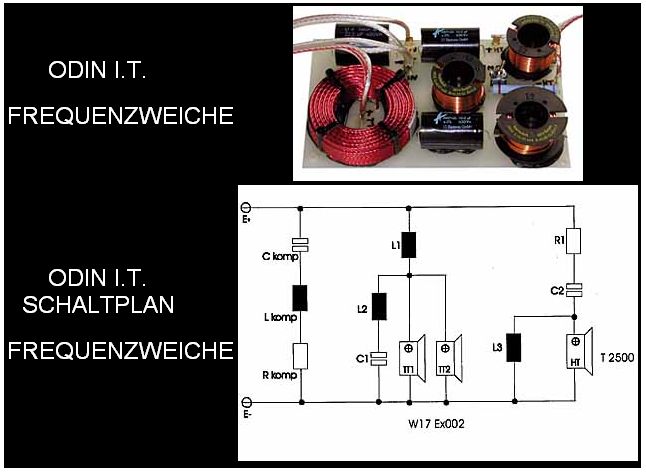

Experience ODIN - german Intertechnik version
Regarding the refined version of the ODIN , with special designed enclosures, this speaker seamed wonderful to me. I had the older version with Seas W17EX002 and without the Millenium tweeter. (look at the network).
I want to add, that this speaker sounded not as good with a big japanese amp, as it would do with a fine valve. The trebles had been to loud with that japanese FET AMP, and in first step u thought , i had to filter the tweeter 1-2db less.
But first i tried my valve SE AMP 2*1W 😉 and that showed me how really good that speaker was. -
The highs had been really good and the speaker played loud and deep. (I used and impedance filter for the valcve amp).
So my advise-use SE twice 🙂
greets
kai, ger

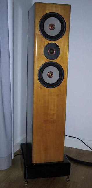

My impression of the Thor speakers
I built a set of Thor speakers using the Madisound speaker cabinets.
They are probably the best sounding speakers I have heard.
Inicially the speakers sounded a little constipated, but after a couple weeks the speakers loosened up (broke in) and just blew me away.
I often times find myself thinking "Wow, these sound damn good... Amazing...".
The bass is clean and extreamly tight. The room is a huge factor for the bass. I had to do a bit of speaker placement tweaking to obtain the desired results.
It would be virtually impossible for me to give these up. I did alot of in home trials of speakers and NONE compared to these.
A definite thumbs up from me!
Check out Madisound. They carry the full kit. I am happy with their kit, and more importantly their service!
Good luck!
Gav
