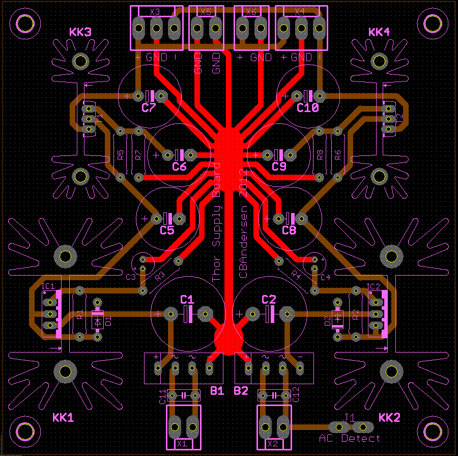

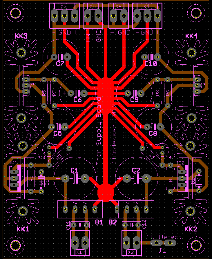

This is my final supply design.
Going back to the LM317/LM337 design + cap multiplier after some more simulation. It just works better.
2 star ground points, first star ground handle the rectifiers, B1/B2 as well as the first caps, C1/C2. The rectified AC current in these components is not something you would want to pollute your ground connection with so these currents should be resolved locally. This first star is connected to the main star ground point where all other grounds lead to.
On the picture that main star ground point might look huge but in reality it is only 14mm x 6mm so it is just exactly the size needed to get all grounds hooked up to it with decent size tracks.
This is the supply design that will be going into production once I get the last few issues sorted out, mainly silkscreen and tidying up the layout.
I think you should group the negatives at X4 and the positives at X3.
All the outputs will be closer to the output caps and less loss through
the traces. Otherwise, I like the layout quite well.
Maybe the main ground trace could be a little thicker in the middle.
A few extra centimeters does not matter much, besides, there are 2200uF on each rail on the Thor amp boards so it is a non issue.

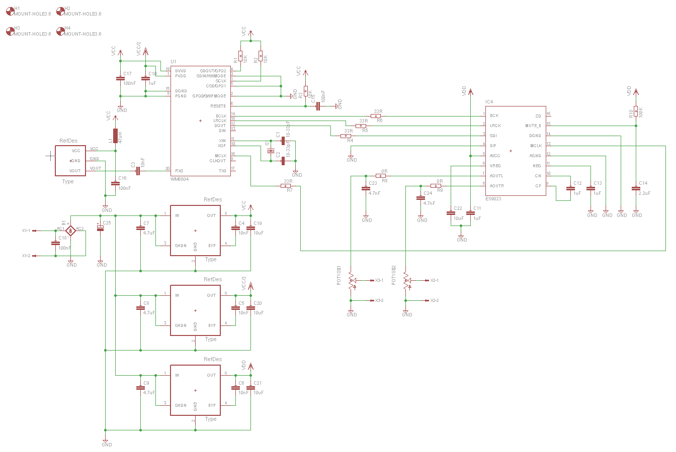

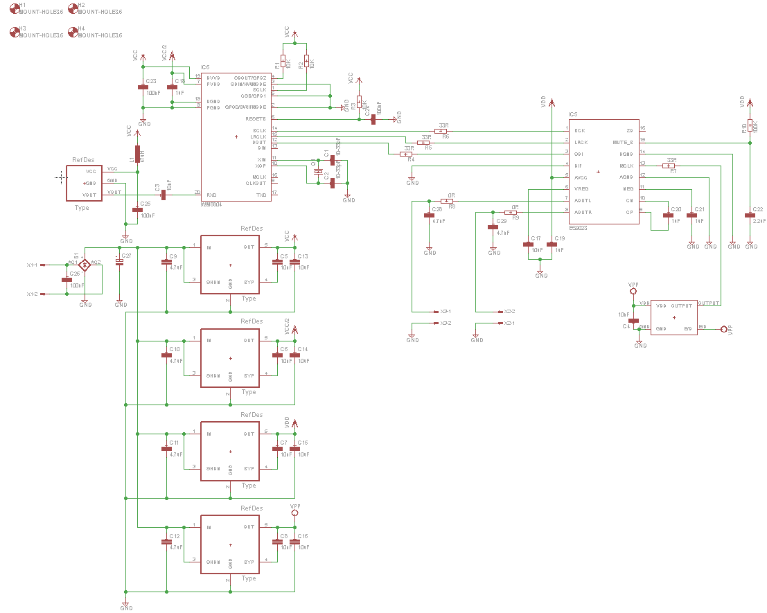

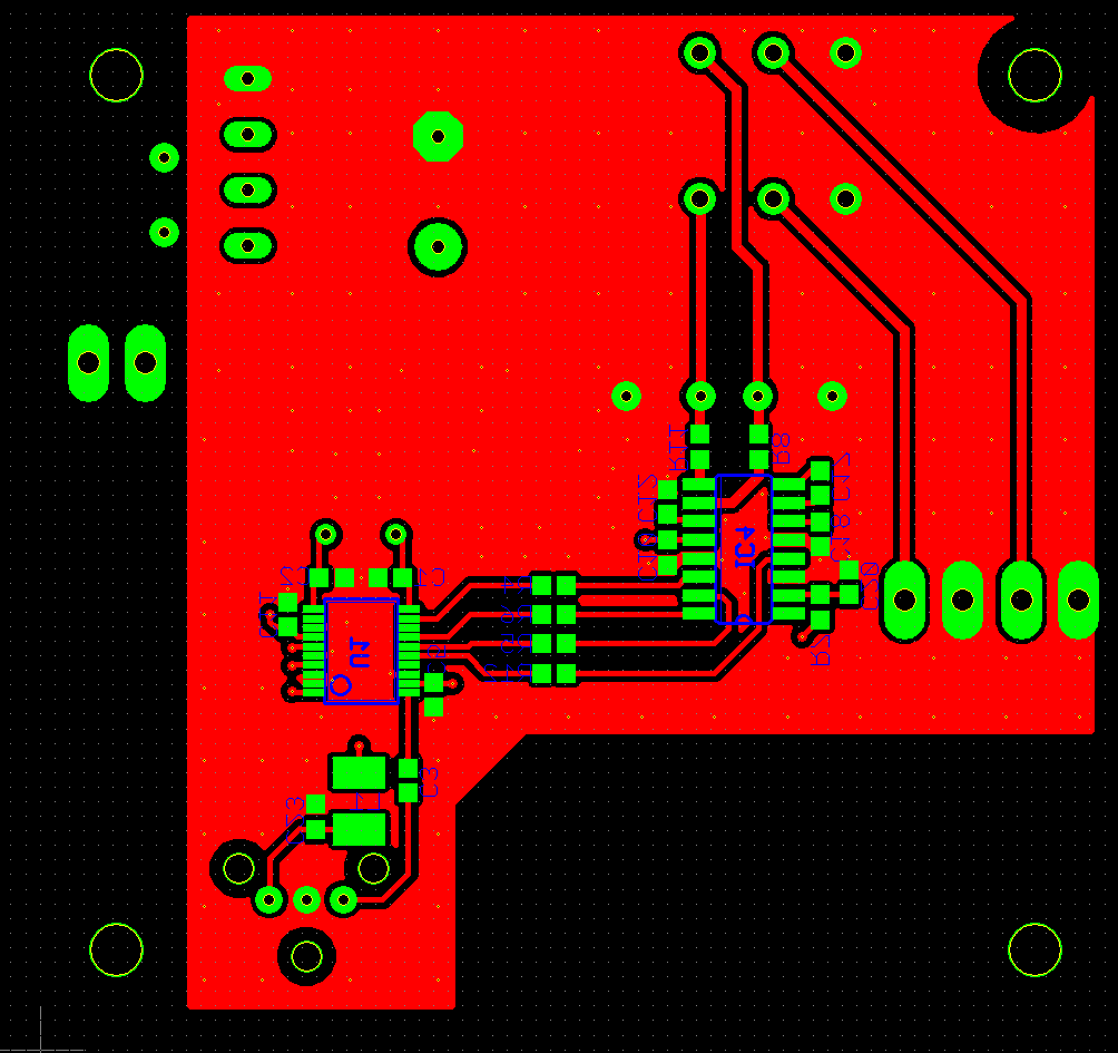

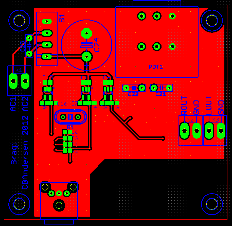

I made a little board with a WM8804 SPDIF receiver, ESS9023 DAC, volume pot, 3.3V regulators, onboard rectifier.
Needed something better than what a crappy onboard soundcard can deliver.
I'm not pretending this is a highend DAC setup but anything is better than what I get from onboard sound from my computer.
Toslink input only, should support atleast up to 24/96, depending on the toslink input bandwidth and general quality.
Gerber top and bottom.

Interesting ... Can you attach a schematic diagram?

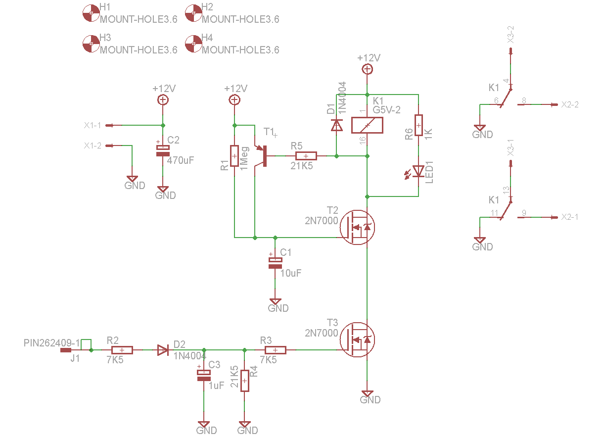

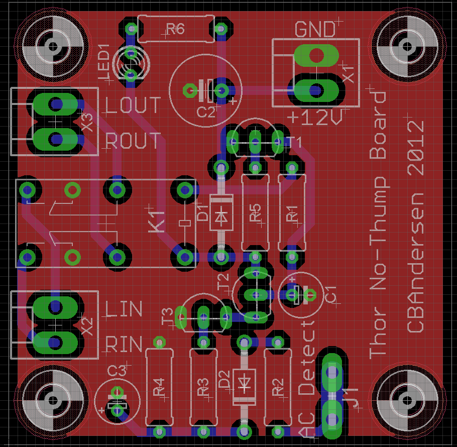

Got my No-Thump boards yesterday and today I assembled a board and tested it. Came as no surprise that it worked, 10 Sec delay before the relay is on.
However, I made a little error. T1 is a BC557 transistor and for some reason I chose a TO-92 EBC transistor as my model. BC557 is usually CBE which meant I had to rotate it 180 degrees before my board worked. Took a liltte while before I realized it. But a few measurements and the problem was found.
Luckily it doesn't affect the No-thump board performance, only consequence is visual, with the transistor being turned 180 degrees compared to the silkscreen.
Compared to the schematic attached below there is a small change. R1 with a value of 1Meg only gives 2 Sec. turn on delay, what I used was a 5M1 resistor for the 10 Sec. delay metioned a few lines above.
