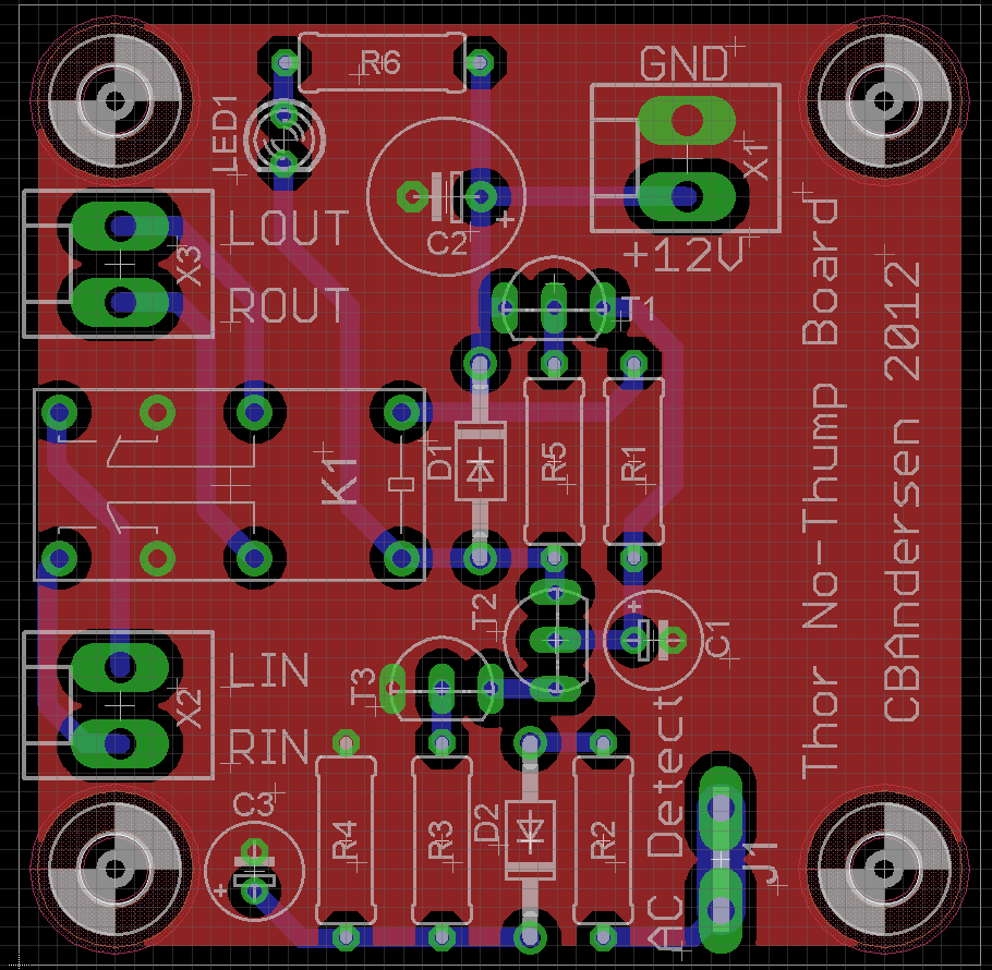

Ordered the No-Thump boards.
Attached is the PCB Layout.

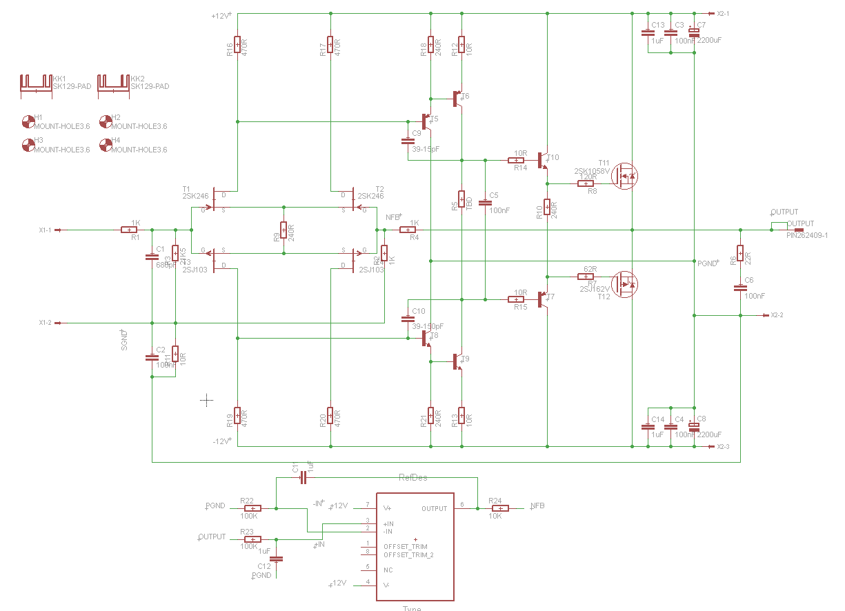

Below info is for those who are interested in a pair of PCB's :
First of all, there will be no BOM with a complete list of components from Mouser, Digikey, Farnell or similar. What I supply is the schematic as attached and a component list generated from Eagle which I have attached as well. So you do have to go out and spend some time and effort sourcing all the components yourself. However, if there is any question about component choice I will ofcourse be answering those. :)
There will be no handhelding, so a minimum of experience with electronics is required, including soldering(there is a small SMD OPAMP and a few 0603 resistors and caps). Also, you will need a DMM to do the matching of the input JFET's and setting the correct output stage bias.
Payment will be by Paypal.
Price will be $20 USD for a pair of boards + $10 USD packaging, handling,shipping.
If you are still interested send me a PM with :
Diyaudio.com Screen name
Real Name
Shipping adress
3 pairs of boards should be spoken for already so 2 pairs left.
  • Partslist.txt

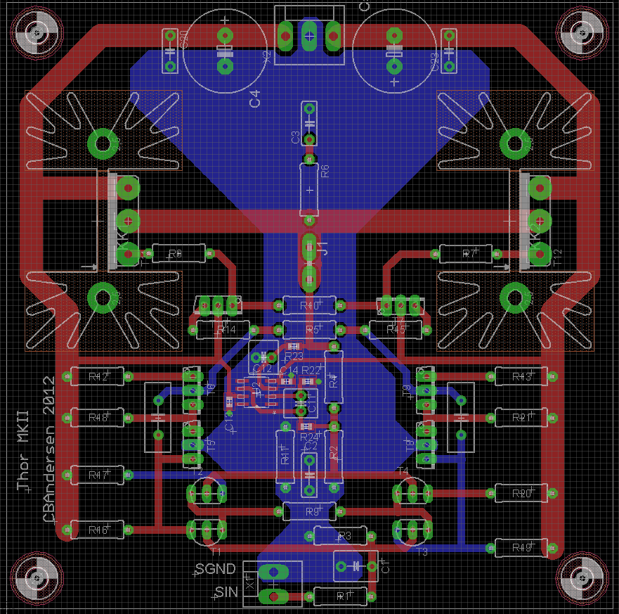

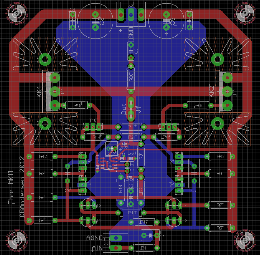

I'm working on a revision to the layout in a possible Thor MKII PCB.
Made more room for the compensation caps, moved some components around, most noticable is the heatsinks and output Laterals FET's. Overall the layout is cleaner and more streamlined than the first.
Price would be $25USD for a pair of boards. All depends on how it goes with my remaining boards.
Attached is the layout.
Regarding building the Thor amp with the current amp boards, the 100nF cap across bias resistor R5 should be omitted, it is not needed, was a TBD component that managed to stay in the design all through the design phase, layout phase and manufacturing of boards.

Same performance, better layout. Slighty larger board, on the order of less than 1mm in width and length as well as the mounting holes moved slightly. This is due to the first board being in imperial, while I used metric for MKII.
Old boards are 99 x 99mm while MKII are 100 x 100mm.
