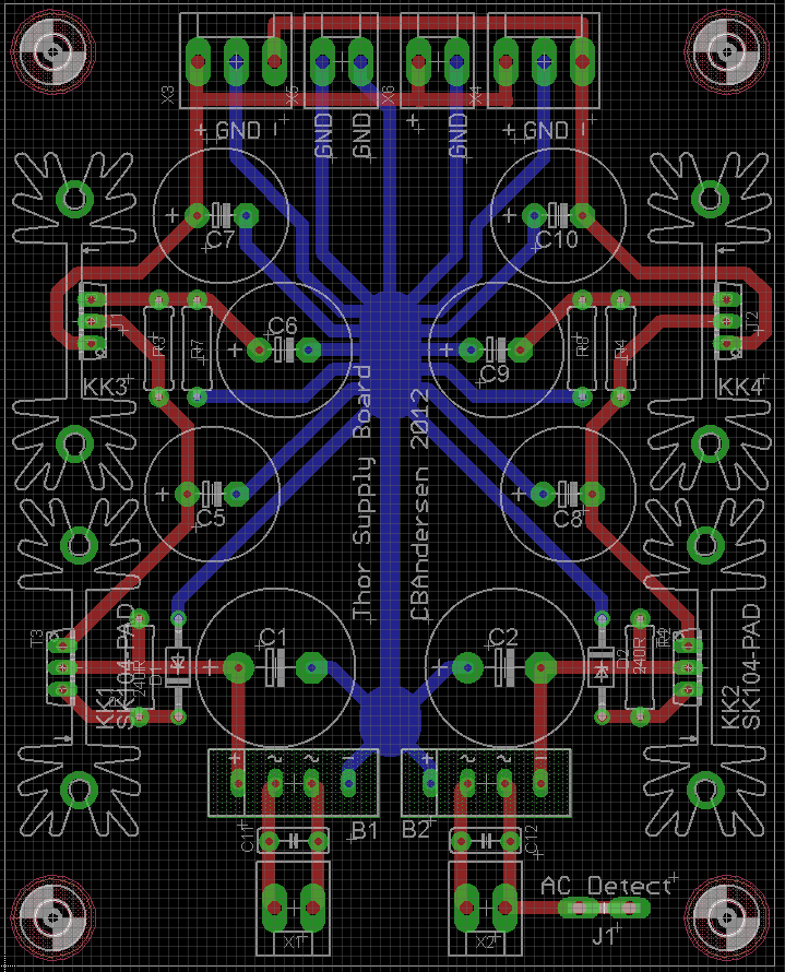

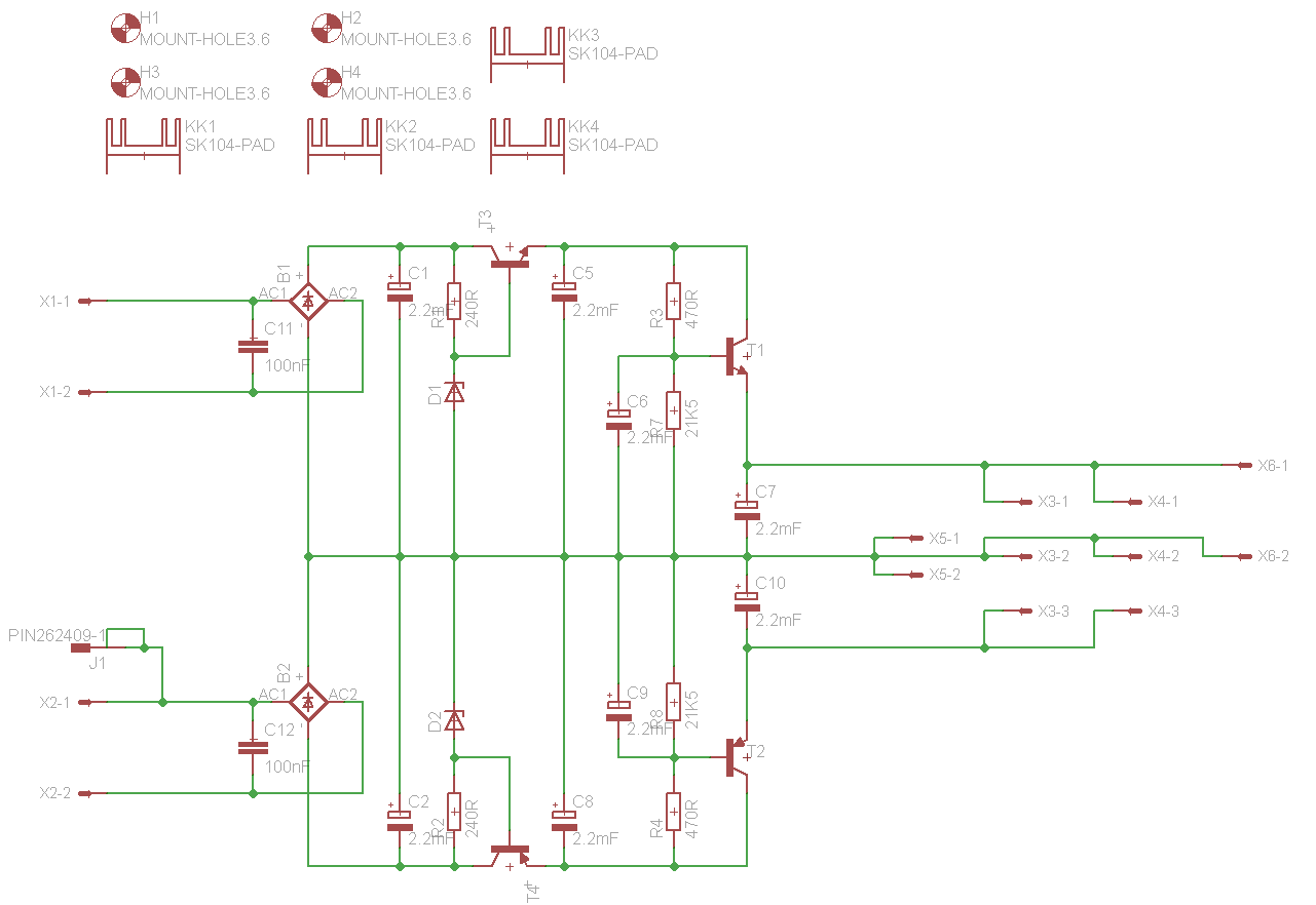

Thor Supply CapMultiplier board in progress.
Some component values still not decided as well as the transistors in the capmultiplier but I have a few ideas.
The Cap Multiplier part of the supply circuit will be using a star ground to minimize hum.

You should just make a polygon and fill that whole area up.
Thats more like a spider than a star 😉
Haha, yea, it looks like a spider. 😀
However, I'm not sure a ground plane is a good idea for a cap multiplier.
What info I could find suggets a star ground layout for cap multipliers or atleast using something star-like.
But then again that was with nothing else than the cap multiplier connected after rectification, with LM317/LM337 as preregulation it might not be needed.

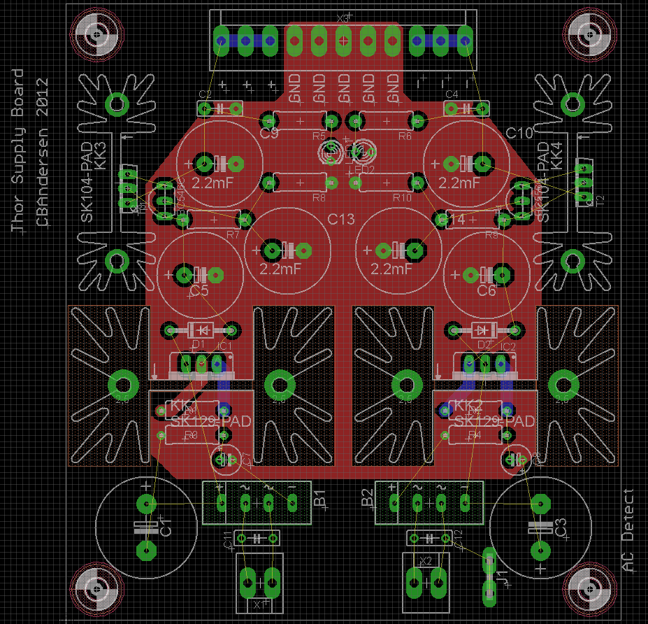

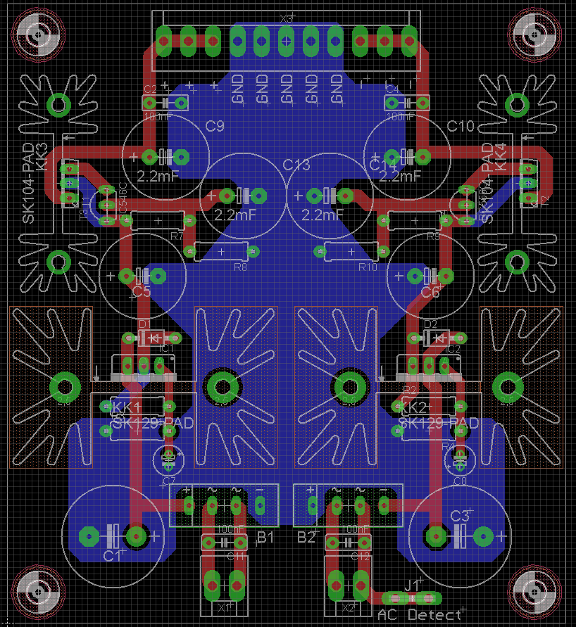

Well, think I'm going with a ground plane.
Supply board should be done soon, just have to do a little more simulation and finding the correct transistors and resistor values.
Board should be ordered, mounted and tested some time in the beginning of april if all goes well.

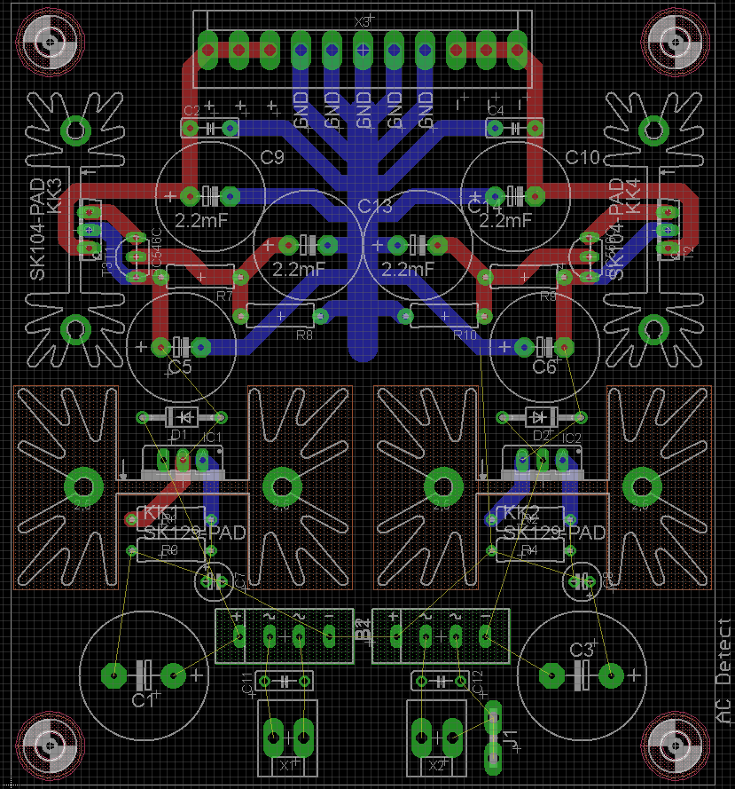

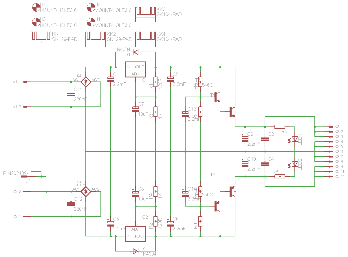

Did some re-thinking and subsequent re-designing of my supply.
Zener voltage reference with pass transistor follow by a cap multiplier using a 4A, 750 Hfe darlington transistor.
Ripple below 1 mV p-p in simulation at full load.
Starground with dual stars.
