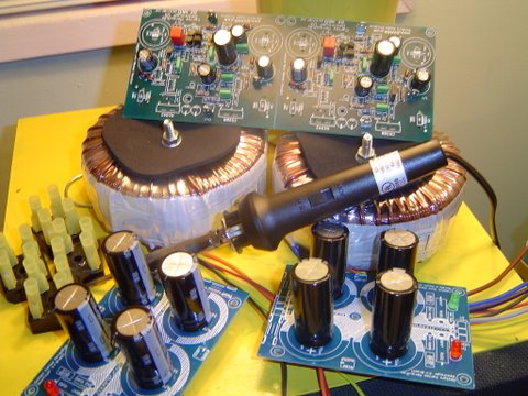

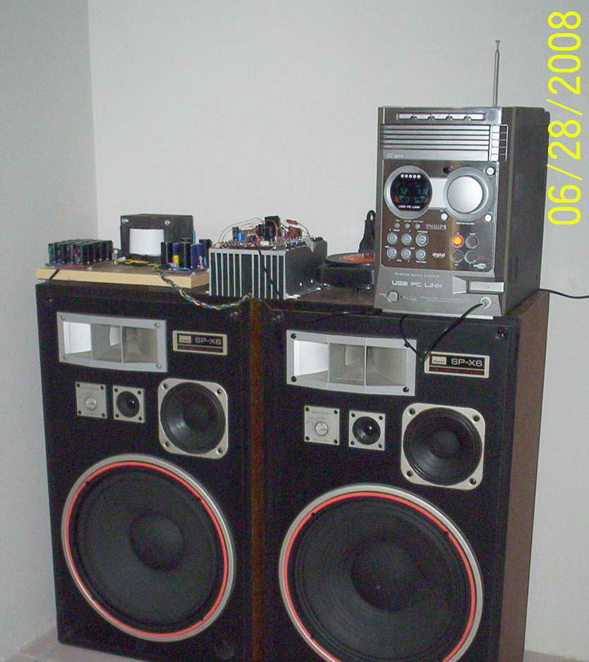

This is the DHR.... Dx High Resolution Turbo
Will keep you informed.... my pleasure...thank you by the kind support
I have to make this one a very huge amplifier....
Brazilians will not buy enormous heatsink...so..they will operate hot.
Brazilians will not use all the transistors i am asking them to use..so i have to put a little bit more than the needed ones.
Working hot, i have the need of optimized thermical sensor..reason why using 4 junctions, all them to sense the heat and reduce the bias.
So..... i am working with those ideas in mind.... have to make it hard to destroy...very huge...and have to test it full power into 1 ohms.... and reactive and inductive loads... and clip it.... using bad condensers in value.... have to put it to work under the worst conditions possible.
You can see the heatsink...small as a toy for this power amplifier.. undersized.... and operating into the wrong position to convection cooling.
If survive.... them will be good enougth
regards,
Carlos

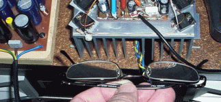

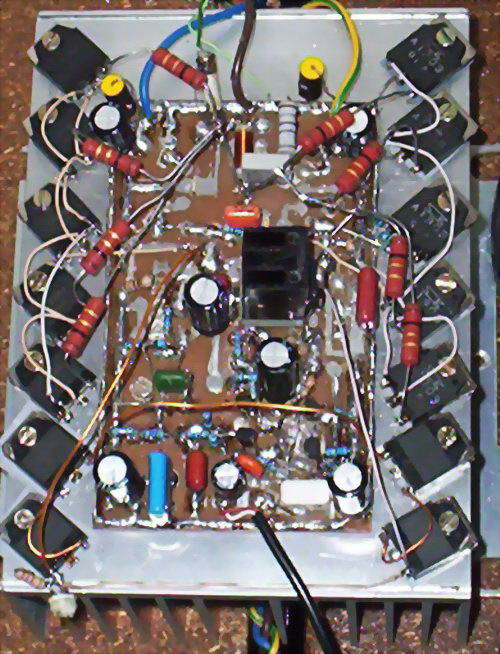

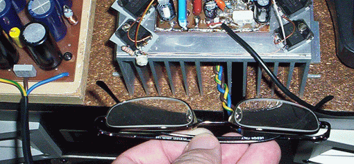

The heatsink i am using is not good enougth
It is good for 160 watts RMS amplifier, and this ones multiply that by 2 and to 3 depending the supply power and voltage.
This heatsink can dissipate around 220 watts ... it measures 15 by 15 (base) and has 12 fins, each one of those fins measure 15 by 8 centimeters.
I found the bias control is working fine... do not let the stand by current increase.... very hot and cold, the diference was lower than 30 percent.
Now i will tweak to obtain better voices.... sounds great, treble (hit hat) is wonderfull, also strings and bell sounds...deep bass is huge and impressive....excelent.... has some loss of control that remembers the Dx Standard.... some mix between Dx Standard and HRII...but i have not the Precision 1 voices... will tweak.
Bias is adjusted very low.... 500 microamperes to each power transistor...to help stability when the heatsink is not good..... of course, this same heatsink used double (I have two), one to PNP and other to NPN will work fine to average power.
regards,
Carlos

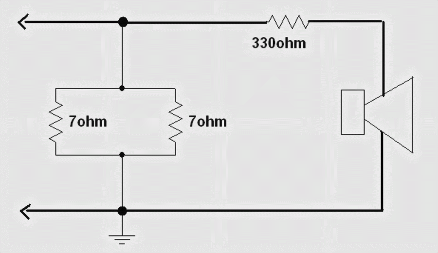

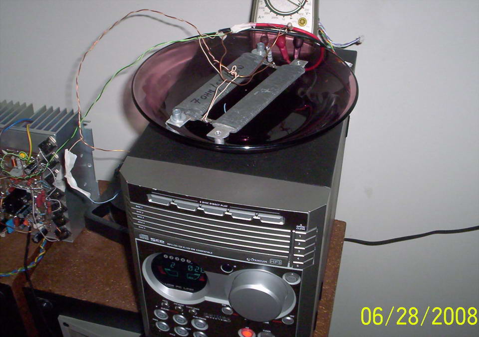

I have tried dummy loads, but smells a lot
I have adjusted to 250 watts RMS...dummy load to 3.5 ohms, as i was using two units of 7 ohms and 70 watts.... so.... 3.5 ohms and 140 watts continuous......hehehehe... started to smell and i have removed, but was helpfull to see how the thermal control was going.
Using electric shower resistance, full power distorted, i felt the amplifier could burn...heatsink too much small to its power.
This amplifier needs huge heatsinks...and giant speakers too.
hehehe
Carlos

I am using the dummy loads connected this way.
The amplifier see 3.5 ohms.... resistive and also inductive...not so different from 4 ohms speakers.... a small sample of the output voltage, already loaded by 3.5 ohms (two 7 ohms in paralel) crosses the series resistance and goes to my speaker...this way i can listen if clips or not.
Left arrows goes to amplifier power output... rigth side you see a speaker monitoring the sound quality.
regards,
Carlos

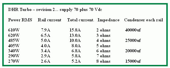

Almost ready...tomorrow last listening tests with some modifications
The simulator data is here...of course, this do not take into account the supply voltage drop.
This was made, using simulator, and voltage was keept stable into 70 volts...of course real life is not this way.
But those informs are good reference:
DHR Turbo – revision 2... supply 70 plus 70 Vdc
Power RMS Rail current Total current. Impedance
610W 7.9A 15.8A 2 ohms
620W 6.5A 13.0A 3 ohms
485W 5.0A 10.0A 4 ohms
405W 4.0A 8.0A 5 ohms
340W 3.4A 6.8A 6 ohms
290W 2.9A 5.8A 7 ohms
270W 2.6A 5.2A 8 ohms
Input signal sinusoidal into 1Khz… continuous power into
The threshold of clipping.
regards,
Carlos

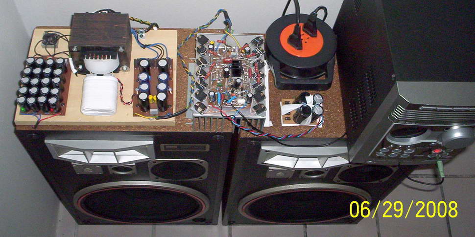

Gotta bend heatsinks and fill the rest of the Hrii boards next couple of days. (picture attached). I'll work hard! It counts for something, Carlos! I believe it counts!
Thanks for being a wonderful inspiration to so many.
Best wishes,
Brian

Here is suggestion of condenser values...to each rail.
regards,
Carlos

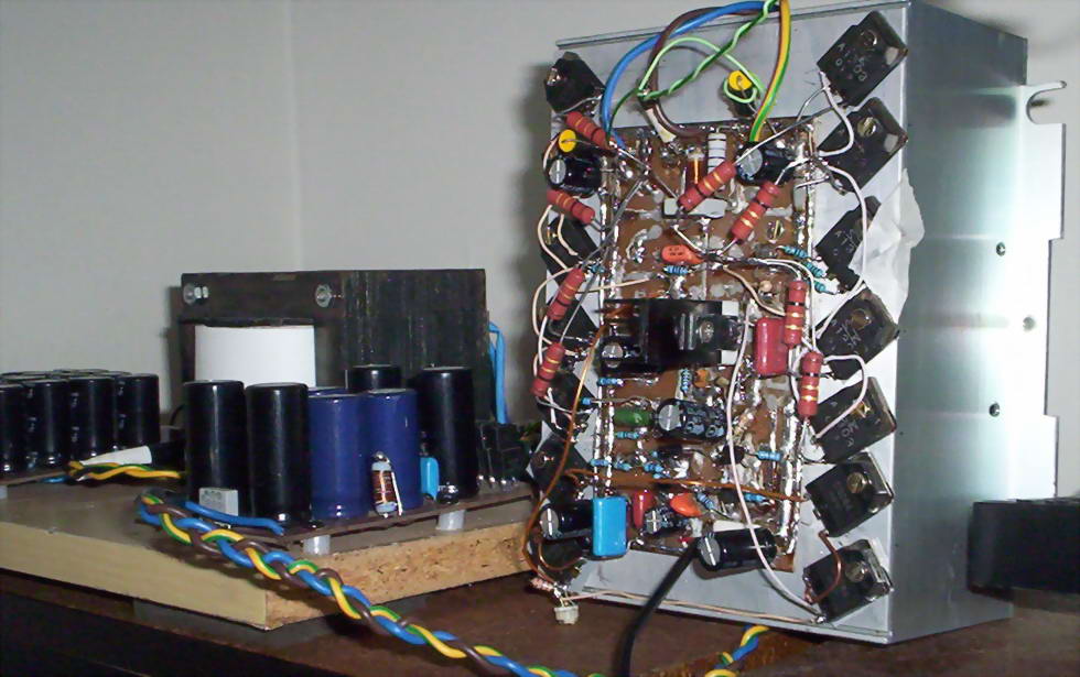

Will give detail latter.
Sensor diodes seems transistors, those plastic ones used to high speed rectification, high voltage and high current..used into Switching power supplies...they are the heat sensors to bias.
More details latter....better amplifier description latter.
