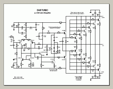

I have found as a very good idea not to place part numbers into the board Alex
I see that you have engaged the brain on that...as the final schematic is beeing produced and may be published today or tomorrow.
the schematic has some part numbers we are discussing about.... and something may change a little...even the presence of part numbers is beeing discussed as this will not be sold as kit...this will be offered to DIY audio community, for free, and they do not need to know (not too much) if 100 ohms into the differential emitter is R2, or R4, or R232.... they need to know it is a 100 ohms 1/4 watts resistance...only this is needed.
Of course... if some problem happens.... to refer to R2 into the place to talk about that resistance alike:
- "that 100 ohms resistance soldered into the emitter of the first transistors into the differential pair"..
Of course...the above information is worse...but the mess into the board, having values and part numbers is terrible too.
I am discussing that with Todd Johnson and i would be happy to know your opinnion about that Alex mm.

As I mentioned in email, I think part numbers are more important for the schematic, for conversations and questions, than they are for PCBs. Values are good for PCBs as long as they don't change, and as long as there are NO mistakes.
Alex's PCB layout uses different parts configurations than the schematic, so I would NOT use part numbers for the PCB. For example, the rail capacitors are split into sub-groups, as are the output emitter resistors. That makes perfect sense for a PCB, but not necessary for a schematic.
..Todd

Please Alex mm, keep your boards without any part number.
This way is better...less confused.
I have never appreciated parts numbers....i think they are an unnecessary step to work.
We have to watch a list to see if R2 is 100 ohms or other value..better to see 100 ohms and install the correct value in place.
Using values into a schematic, and part numbers too...i think is double information, when the value is what matters.

Todd Johnson have finished the schematic and made the special
kindness to remove the part numbers from the schematic...but he has a sample with part numbers if we find it needed to debugging or some easier communication during debbuging of assembling errors.
I will give him time enougth to post by himself.

HOLD ON! the ones are building DHR!
I have found better solutions, also i have found one weekness...so... during hard testings i have made some modifications.... 5 pairs into the output...the same transistor used into the output is used as drivers too..... diodes as heat sensor are now transistor junction or diodes junction.
The amplifer had operated into full power and 1.5 ohms.
Into 4 ohms...clean sound is near 500 watts... and can go much more if you accept some small distortions (the majority do not perceive that small distortion..when start to clip)
Sorry folks.... sorry Alex mm... and sorry Todd Johnson...but i am trying to unstabilize the amplifier.... as i could unstabilize i am tweaking and now it is stable...but hold on for 24 hours please.
Schematic will be different.... alike this one...but this one will be tweaked a little too.
Wonderfull sound...more reliable.... this is what i am achieving.
relax...wait a minute... this beautifull amplifier is cooking and you will be happy with it.

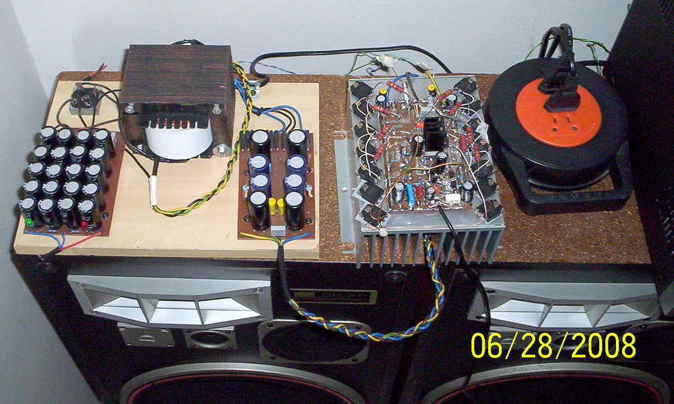

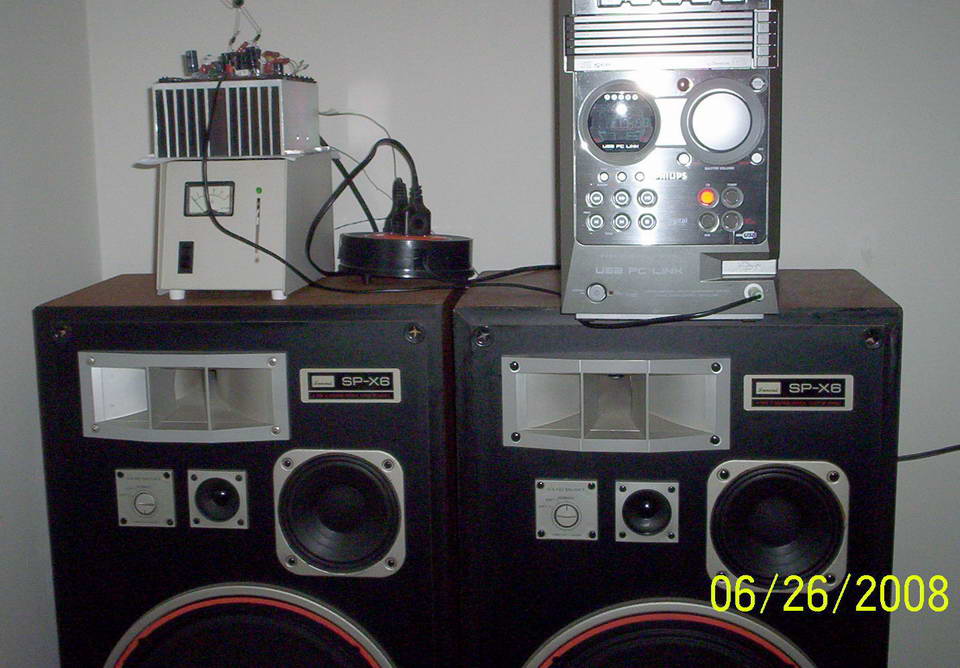

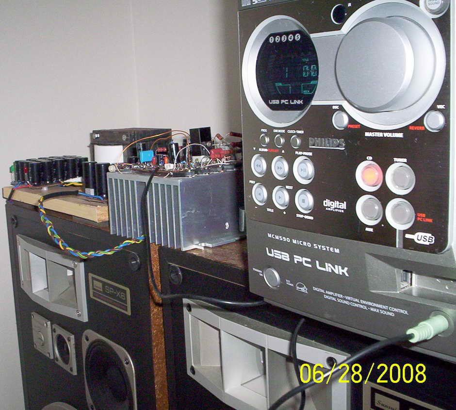

Now i am using resistive load...have tried before several speakers in parallel
A sample of this audio goes to the speaker to monitoring.... load smokes a lot...will not show that dirty thing to you now.
Load is 1.5 ohms...and operation is full undistorted power.... more than 700 watts... electric shower wire resistance used...it turns red, almost melted....1.5 ohms is hot resistance, not cold resistance..... of course.
regards,
Carlos
Huge control of thermal drift is required.
Because of that i am using 4 transistors junction, big ones, attached to the heatsink as heat sensors... as thermal diodes.
Working fine till now.
1 to 3 miliamps stay into the emitter resistances..now 1 ohm each and 5 pairs of transistors into the output.
Huge amplifier..... enormous power... even into 1.5 ohms.....
A Monster!
regards,
Carlos
A Monster!
regards,
Carlos
- This is the DHR.... Dx High Resolution Turbo
