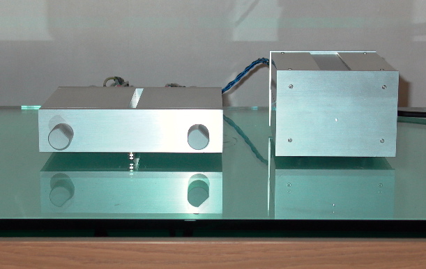

the 2 channels, the toroid and the 2 diode bridges in the same case
dimentions are 43*28*7cm
I'd liked a flatter case (flat case look sweet IMO) but the toroid is huge (so huge for a 225VA!)
Yesterday I tried to connect the - output terminals of my clone to eachother. Sounds better ! My left channel is more stable now I guess. Does anyone have an idea why it works ?
(the earth of my left channel is connected to the case by a parellel cap and resistor, the earths of the channels were not connected before, only by the source).
Is maybe the distance of connection of the channels too large? In both cases I do not have hum.

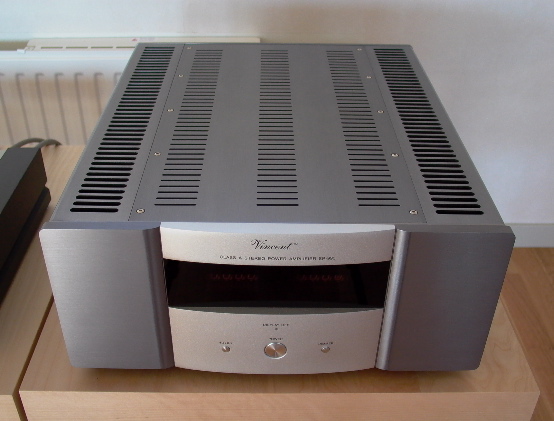

protos said:I have not heard of Vincent amps. Reminds one of M-L.So the gc can drive your speakers well I take it even though they are medium(?) efficient and you seem to prefer big power amps?
Well, I had 1 ohm Apogee Scintillas before the Hales and they demanded big power amps. Actually people from Mark Levinson is said to have designed the Vincent amp. I don't like big amps per se, I just want that kind of see through the music into the structure sound that Peter Daniels GC gives.
I'm happy that you like the amp. This unit will still improve since it's not broken in yet. BTW, this was my second pre-production GC amp and Thomas was actually my first customer. He showed a lot of faith in me, coming up with his request.

These amps should be tuned-up like violins to sound best. I've made several DIY amps before the GC, but I've never seen so parts dependent thing like it so far.
Because of the cable dependence of the circuit I'm not sure it won't perform better when the PSU and the amp are put together in one box. At least one cannot go wrong with the cable choice when makes an all-in-one amp.
PS - BTW my PSU cable is 40 cm. long. Length is crucial. The shorter the better.
