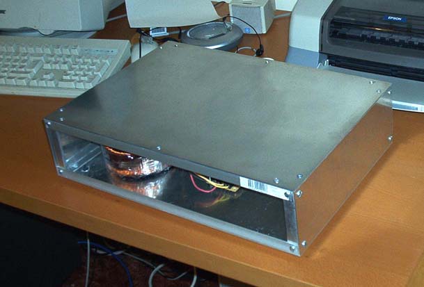

a bit like this:
it is quite sturdy and i am quite proud of it as it is the first case i have made - unfortunatly it has no back and front as they were cut too small.
this was made from 2mm thick aluminum as 3mm is quite rare and thus more expensive
its not done yet - i plan to mount the amplfiers to the back - unfortunatly these were cut 20mm too short so i cannot do anything yet - should all be done by friday though
it should sound good though it uses;
MUR820 Diodes
300va transformer
dual LM3875 amps
Elna RSH 1000uf capacitors
