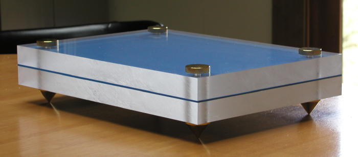

Here's a little stand I made today for my Gainclone. It is made out of two slabs of 1" acrylic with 1/8" thick piece of blown rubber in between (stuff used in shoes and sleepping pads). The size is 12" x 8.5". I just used longer rods between the spikes and top nuts and here we are, a nice little support for an amp.
To say that it improved sonics dramatically, wouldn't be exaggeration. I came across that kind of platform by accident, a friend of mine asked me to do it for his portable Sony CD player. I did a small stand and before giving it to him I tried it with my amp. I noticed it's good, so today I made a bigger version.
There is much bigger depth, and the sound is cleaner and much more solid now. I usually don't listen to classical and jazz, but with this setup I really enjoy that type of music. This is highly recommended project and the cost is around $40 if you know where to shop;)
