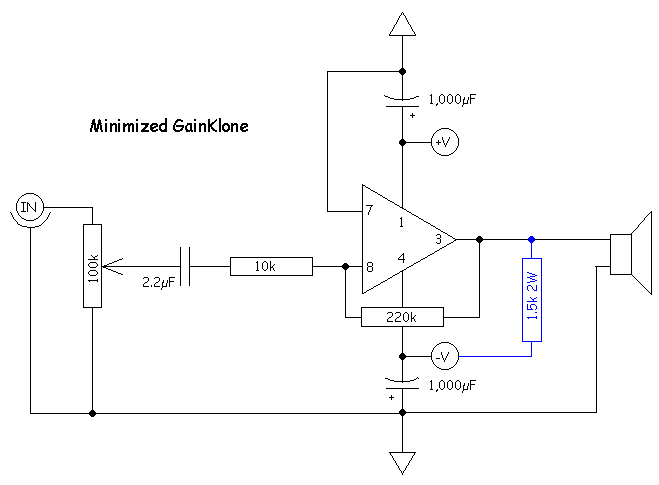

Although i'm a different Peter, the 1.5k resistor is not doing much connected to ground. It should go -Vcc
analog_sa said:Although i'm a different Peter, the 1.5k resistor is not doing much connected to ground. It should go -Vcc
Thanx... i've fixed my ID 10 T error...

Dave: You can switch LM1875 instead of LM3875, but you'll need power xformer with lower sec. voltages (2x18V). Also, I had some difficulties with DC offset (it was 300-400mV) so you'll probably need adj. resistor +cap. at positive input to ground. But it sounds as good as LM3875.

vuki said:You can switch LM1875 instead of LM3875, but you'll need power xformer with lower sec. voltages (2x18V). Also, I had some difficulties with DC offset (it was 300-400mV) so you'll probably need adj. resistor +cap. at positive input to ground. But it sounds as good as LM3875.
Thanks. I have a set of both. I was going to use 18-0-18 on the 3875 anyway -- from the datasheets that is the optimum voltage.

Dave, the schematic you show is the setup I'm using. I didn't try blue resistor yet. I also found that cap is necessary. My DAC has a servo and basically 0V DC at the output, but the amp had 500mV of DC when I wasn't using the cap. The same goes for BOZ with capacitive output. The amp still had some DC offset. When I finally placed BG 4.7u (type N) cap at the input the offset is steady at 20mV at both outputs.

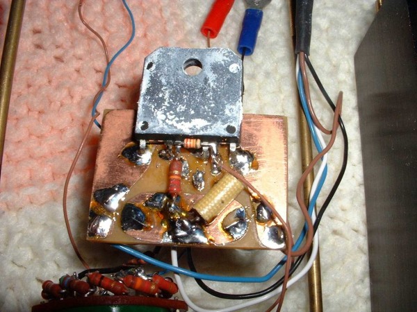

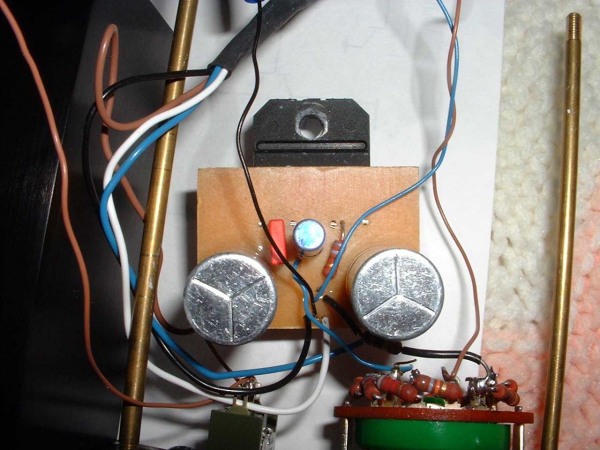

Assembled PCB looks like this:
