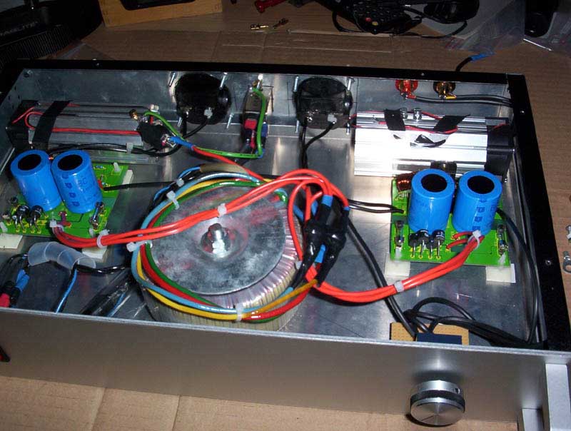

these are mine gainclones. In the picture is one channel three GC for quadriamp system. Thorsten schematic except input cap 0.1 mF because I use them for multiamp from 300 Hz up. Dc offset variyng from 0.8mV to 2.2mV.
I made them with the cheapest component I could find(except transformer) just to see potential.
They work great maybe I 'll go for selected component.
Peter as all your amp those are great too.

is the volume control nessessary?
the pre amplifer usally controls sound so why are you including a volume control in this as well? does it perform worse when running at full power (volume) and will there be any problems if i delete the volume control from the circuit?
I used the volume because this way I don't need a preamp. If you plan to use preamp, you don't need volume in the amp. Unless your preamp has caps at the output, I recommend using them to couple the amp's input.

Hello,
I´m intending to give this amp a try.
Anyone with experience of low supply voltage? Let me say +-12V. I think I have read somewhere that it should improve the sound quality.
The reason for such low voltage is that it make it possible for me to use 16V OSCON which I already have in my boxes.
Carl
Ex-Moderator
Joined 2002
Carl, it is not beneficial to save a little money on the wrong place.
I made the mistake often as well to adapt a design for the parts I had in my drawer. It doesn't work out.
OSCON certainly won't sound as good as BG here and +/- 12 V will give very low output. Too low. Please see the datasheet for the lowest possible power supply voltage.
Just use BG 1000 uF 50 V and experience the same as others do that built the amp. You won't regret it.
