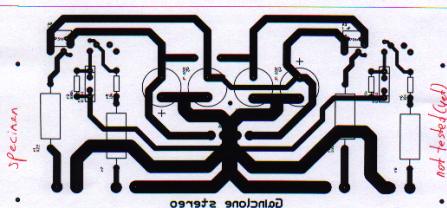

Any comments on my layout are welcome. This is not the final board because sizes of parts are still unknown. Have to buy the BG's. I know the Gainclone is supposed to be hardwired but I simply don't like hardwiring.
I deliberately used a low resolution to prevent anyone from using this unfinished and untested layout. If it has reached the final stage I am willing to publish it here for anyone to use.

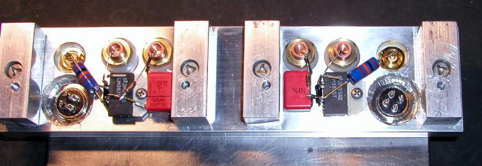

I don't see your feedback resistor, is it soldered directly between the pins (it should be). Also I would try to move PS caps closer to the chip. BG are bigger than the footprint you are using. You might also find that the amp sounds better with positive input connected directly to the ground (in inverting mode).

Sorry, I scanned the layout another time for better viewing.
Feedback resistor is mounted between the pins, Peter. Never mind that I don't like hardwiring. If I could do is as neat as you can I might consider it. Plan is to snip off some of the unused pins for a better layout. Positive input can be shorted to ground by using a jumper wire instead of a resistor. The 1 uF caps have to be mounted at the copperside. Remember this is a first version ! It will be more compact and it will have shorter tracks. Distances of components look greater than they are in reality. Just showing it to you for comment ( and good ideas ). Power caps are moving to the chips as I speak 😀
Footprint is wrong for BG, I know. The ones I have here have the used footprint. I want to use 4 x 1000 uF as you can see. Wires will be connected with those plastic blocks in which you can attach the wire with a screw ( don't know the english name for it ). Although there are very few parts it is not easy making a nice board that's symmetric ( ish ).
Transformer will be a Seidlbauer 2 x 18 V 4,44 A.

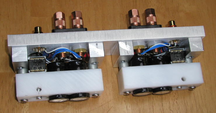

Well, since there is going to be a little delay on the AX boards, I think I am going to build one of these little suckers now. Since, I have the passive components already, I guess I don't have any excuse. I got nearly all the rest of the square tubing for the heatsink project and need to cut it up. I might as well cut out a gainclone chassis.

P.S. Peter I still say you could make a fortune selling gainclone chassis

P.S. Peter I still say you could make a fortune selling gainclone chassis![]()
How about finished gainclone?😉
