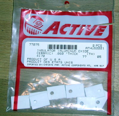

All my European customers please stay assured that I'm not using any toxic susbstances in my amps.😉
