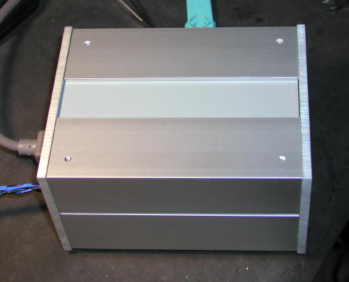

Here's a simple way to build power supply. Front and back are 1/4" aluminum plates. 5/8 bars in 4 corners, with screws attatching plates and 1/8" x 2" angles forming the body of PS. On the bottom there is 3/8" acrylic plate holding 400 VA transformer. I used separate windings (around 10) for blue LED. In the left corner, 8 MUR rectifiers.
