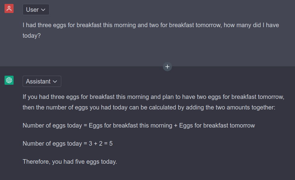

AI has been shown to tell untruths with the appearance of utter confidence. It has been programmed to apologise for doing so when called out, but it will have no compunction about it in the future.
I appreciate that you might try to bridge this three-way conversation to something simpler for us to help with. However to us, the AI might represent a higher order of complication. We may have to be on the alert about everything that comes out of AI on these topics, and quite frankly it can be a chore to have to fact check it when we know there is so little for us to gain from it.
Hoping this helps 🙂 I'll leave you with one of my own experiences with an AI bot..

Another warning. AI suggests to use a LM317HV to regulate the 150VDC down to 24V. The maximum input voltage for a LM317HV is 60VDC. As usual AI blabbers a lot, little of it makes sense.
@TubeHybridMaker I don't want to be rude, but why do you think you can design and build an amplifier like this? I understand you desires, but with zero knowledge and zero experience it seems very hard to achieve this. Normally it takes 5 years university education and then a handful of years of experience to do this.
So what you are doing now is asking AI to think for you. With the result that you post tens of bare nonsense statement from an AI bot and you ask us to correct that on each and every attempt.
Since you are a veteran. How would you assess if your platoon was sent to the battlefield lead by a total rookie carrying an iPad for looking up how to fight in AI?
Another interesting comparison is made to a situation in which there would be mortal terror! Earlier, Nico compared my inexperience and determination to going into surgery with a novice surgeon. I assure you, this is not an occasion for mortal terror. Whatever amp I end up building will never be plugged into a wall until a certified or licensed electrician has studied the schematics, build, done all tests without plugging it in, and has decided it is ready to be tested with power running through it.
