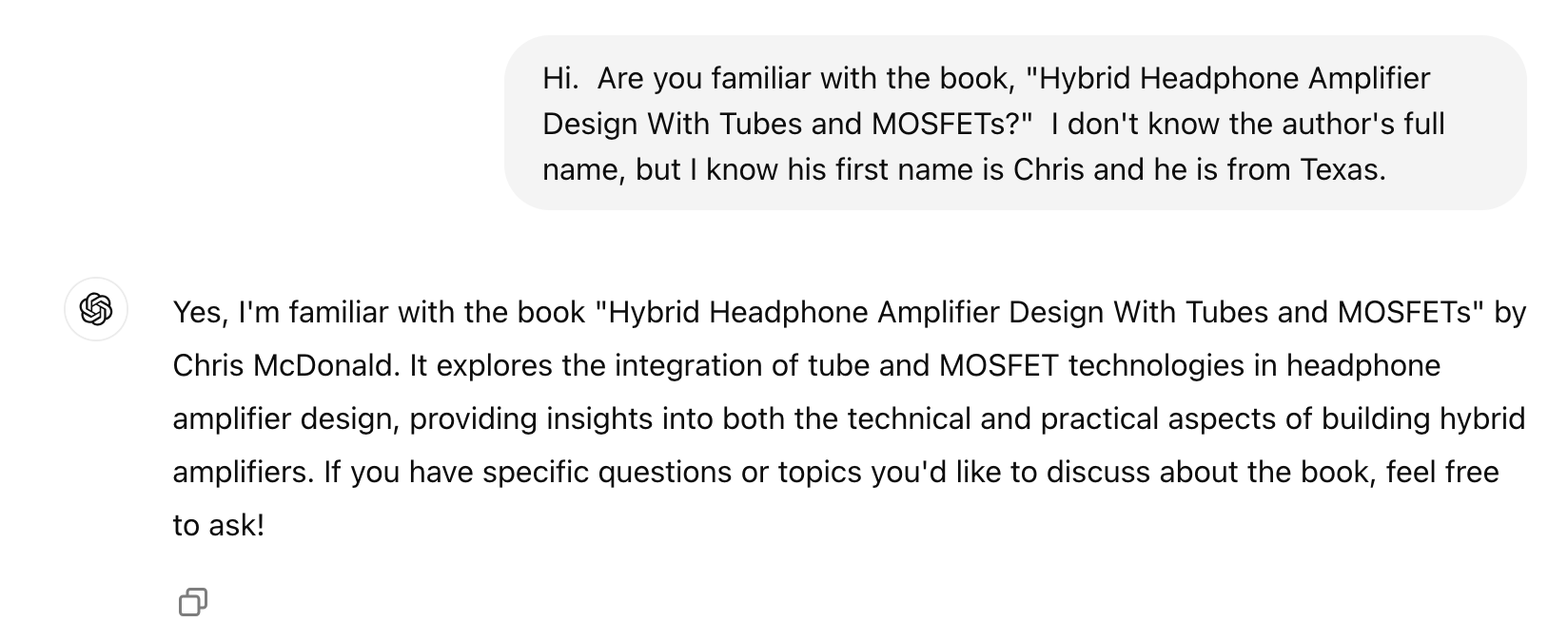

Well, it had been my intention to avoid using op-amps or integrated circuits. I thought that since I am using AI to design it for me, it would be interesting to make as old-school an amp as would properly serve my 32Ohm headphones. I did look, but did not find any hybrid-transistor headphone amp kits or designs. I did not try looking for a speaker amp design or kit that I could adapt for headphones. Why? I'm a dummy often. I'm not always a dummy, though. But you'll catch me slipping often, and I'll try not to vex anyone's patience. I was, in retrospect, quite eager to involve AI in this. But if I had found a tube-transistor hybrid headphones amp kit that puts 1W into 32Ohms, I'd have bought and built that. And again, I have looked.
I rest my case.
