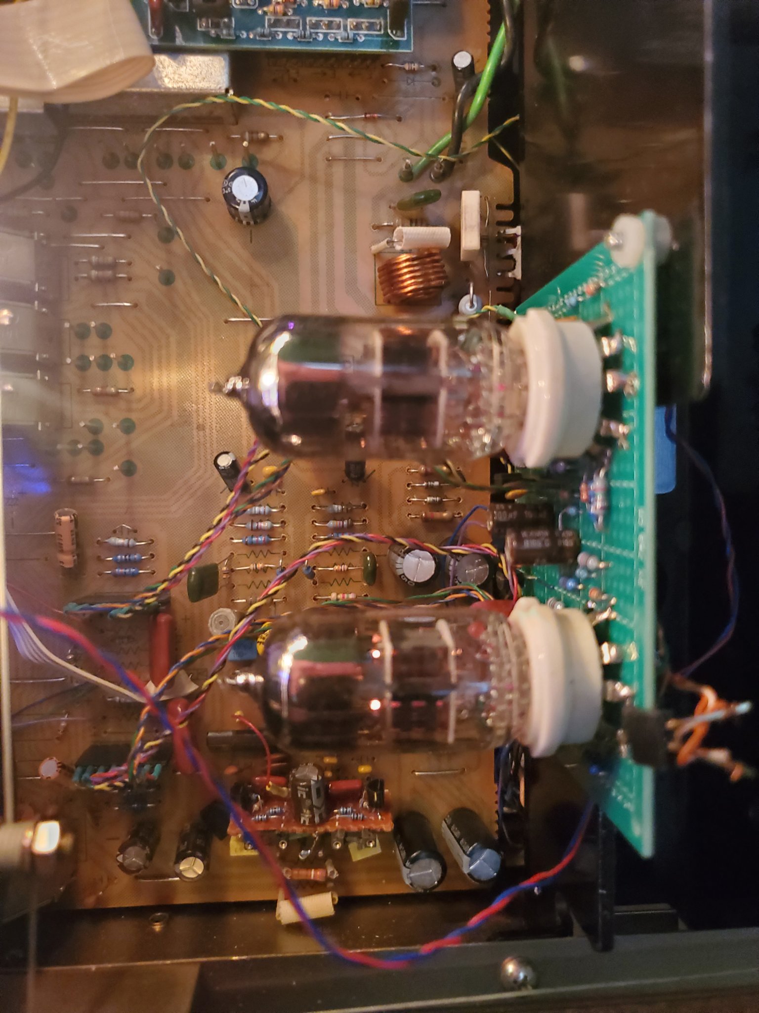

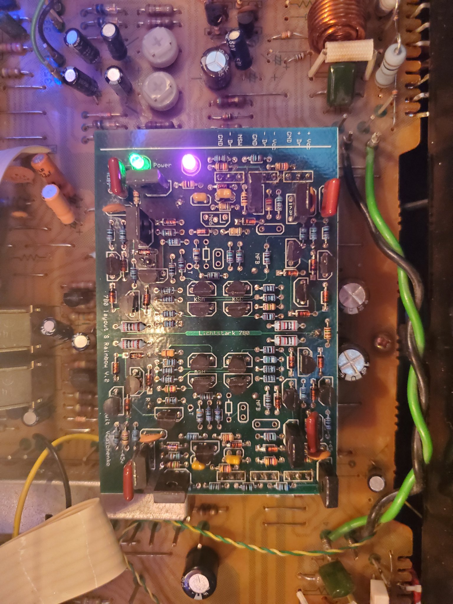

That's amazing! I like the idea of inverting the tubes' pcb. Do you know if that's possible in a whammy chassis? What are your dimensions?
Most importantly, how does it sound? You've done a beautiful job, here, just going by looks!
