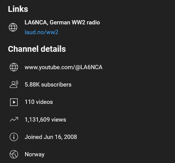

It's Norwegian,-his dialect is from the west side of the capitol of Oslo.Could also be Norwegian but I can't distinguish it from Swedish.
Those large letters on the screen at the beginning of the video are a ham radio call sign. The LA prefix puts him in Norway. Ham call signs are public record in most countries, so much can be learned just by Googling the call sign. He is in Larvik Norway. Google will take you to his web site where he reveals a rather large collection of vintage radio equipment from all over the world.His YouTube profile description says he's from Norway
I just find clicking on his YT info right above the video a bit faster;Those large letters on the screen at the beginning of the video are a ham radio call sign. The LA prefix puts him in Norway. Ham call signs are public record in most countries, so much can be learned just by Googling the call sign. He is in Larvik Norway. Google will take you to his web site where he reveals a rather large collection of vintage radio equipment from all over the world.
