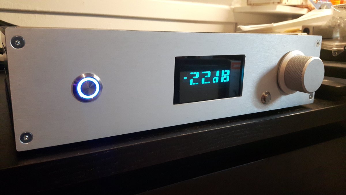

With regard to changing the push buttons.....you show a nice example by Gerben on your twitter account, I assume Gerben used something like a bulgin (SPST-NO) with a ring led for 'on/off'. And another push button without led for 'select'.
One suggestion about the current push buttons. Your standard push button looks to me like it isn't suitable to integrate directly in a front panel. If I am right, your standard push buttons need some kind of 'finishing front/touch part' to have the button integrate nicely with a alu (silver or black) front panel. I wonder if there are any standard 'anodized silver/black alumina button parts' that fit on your push buttons. A reference (mouser digikey etc) to such parts and how to integrate into a front panel design might be helpful for people.
For myself, I will use bulgin buttons anyway as I use these in all my equipment and I want them to look alike.
