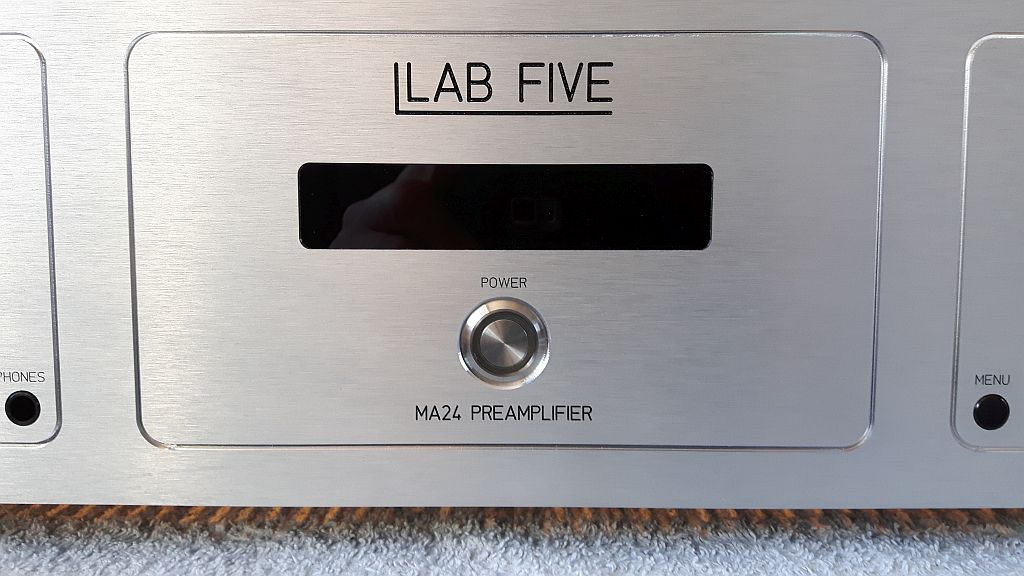

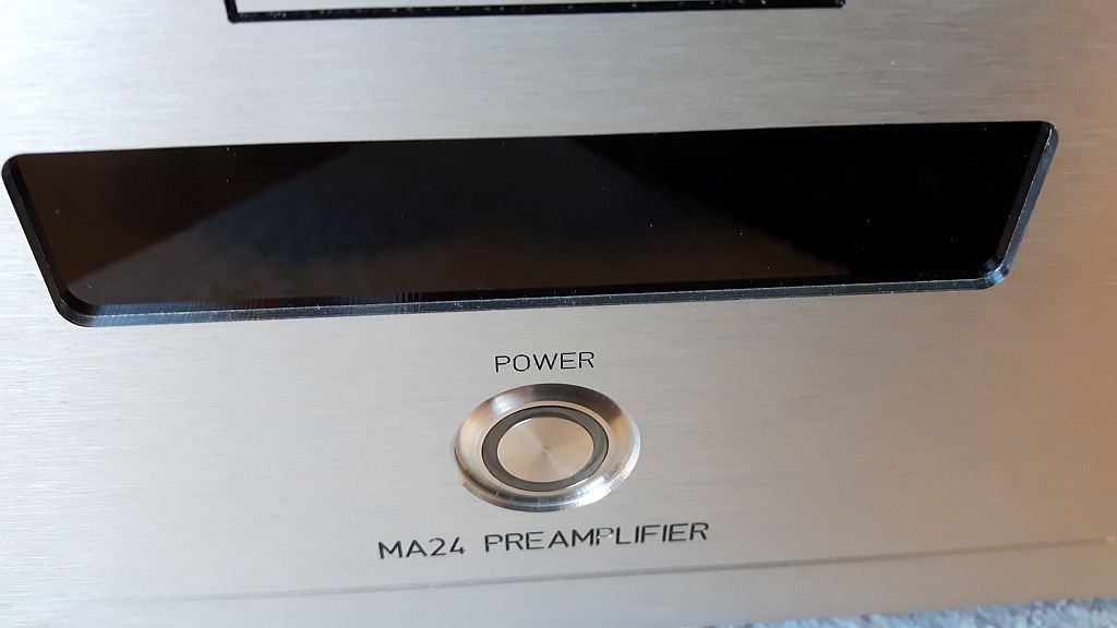

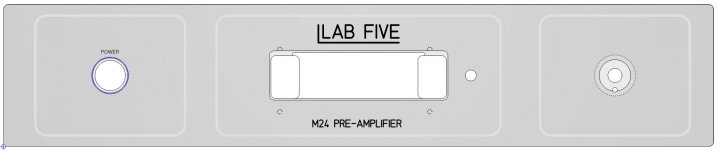

FPE Front panel for MAYA GB3

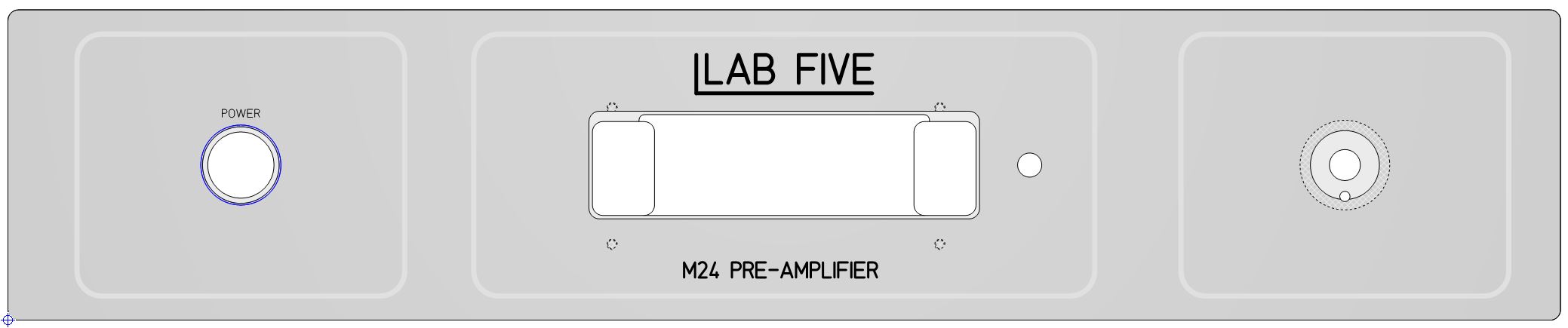

I made a new front panel today in front panel express software, based on the modushop Slim Line 02/350 chassis. The central cavety should fit the OLED display that goes with the third MAYA GB. See PDF and FPE file. You can review it with the free FPE-software from Schaeffer Berlin.
I plan to insert a 3 mm thick plexiglass window at the front side (not from behind!). I have a blue oled screen so I ordered a number of colored transparant pieces of plexiglass 3mm thick: light and dark grey smoked, purple and dark blue (plexiglasstunter.nl). Lets see which one suits best.
The hole on the left is for a Bulgin 22mm button (MPI002/28/d4) as I use these for the power buttons of all my audio equipment. Another hole on the right is for the 'encoder / volume'. I still need to find a place for the select button (SPST-NO). See below.

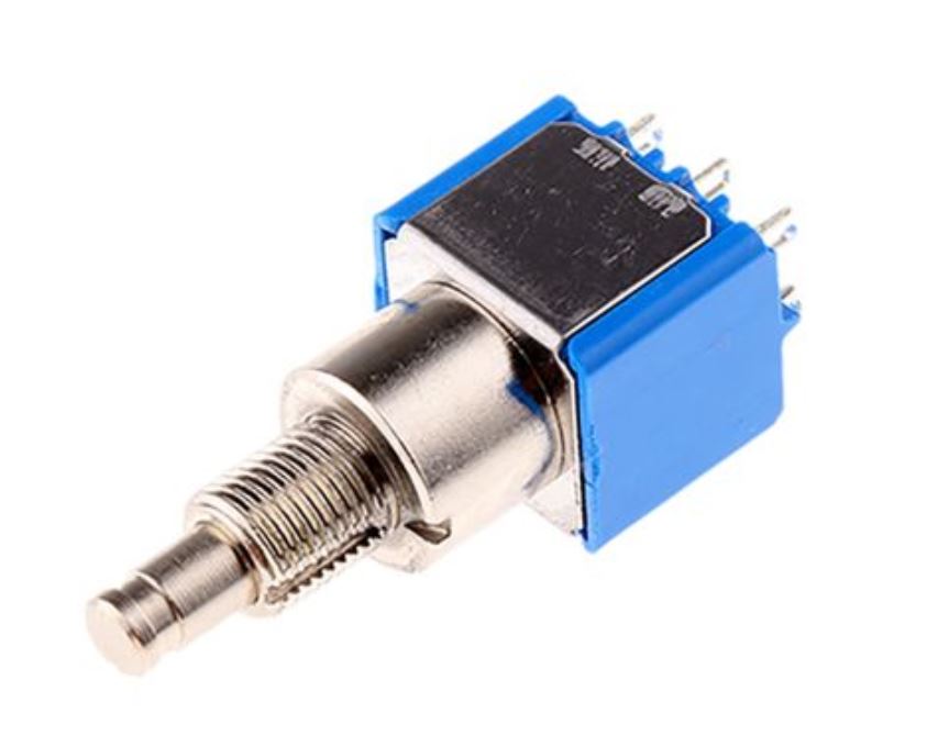

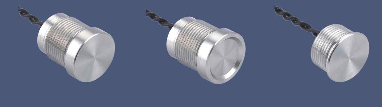

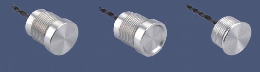

Looking for help! Concerning this select button: I am still looking for a small (6-8mm diameter, max 10mm) steel/aluminum looking push button that integrates well with the anodized aluminum front of modushop? I don't want to use another big Bulgin button. Maybe you have suggestions/tips for me? I want a button that does not stick out of the front panel (or as little as possible) and which can be mounted in/through the front panel. I include two examples of what I found. Can i use this piezo button as such? Anyone experience with these type of button (it should be SPST Momentary and normally open).

It looks like the piezo button link does not open up. It was my dream to do something with piezo buttons similar to the initial PS Audio DACs. If we could do this it it would be a very hi end design 🙂

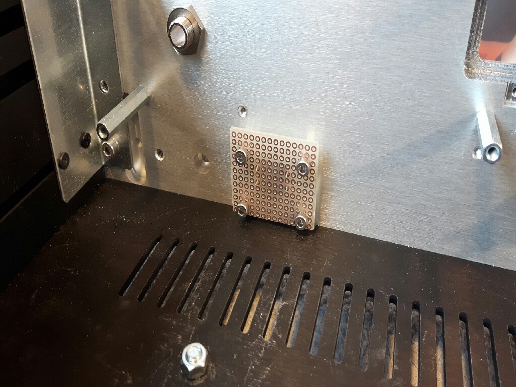

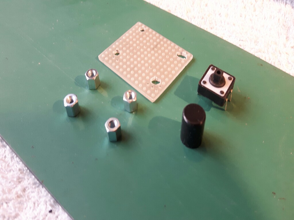

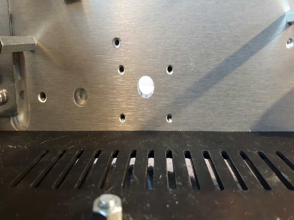

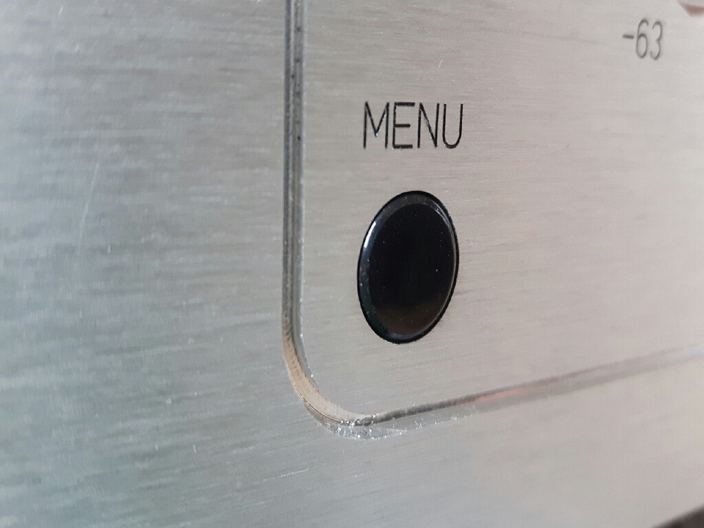

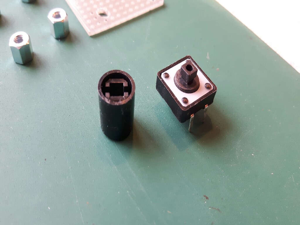

I used another tactile switch than the original Maya switches because you have to find a suitable combination of switch and switch cap. Start your search with the switch cap, then the switch follows.
I ended up with this cap from Digikey: TAGBLK, no. EG109d1-ND, it is 8,80mm dia. x 10,50mm H. So its height is enough to cross the 10 mm modushop front panel. I chose this cap also because it had to look similar to my headphone jack. See my build log on amb audio for more details.
With the cap specifications, I found this matching tactile switch: TL1100F160Q, it is 12mm size and can be bought at digikey (no. EG1821-ND). The construction of the switch on the front panel with a small prototype pcb is straight forward. The standoffs are m3 / 5.0 mm. The pcb has 2.54 mm hole pitch.
