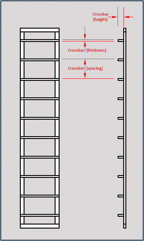

Concerning crossbar spacing:
It is important to consider crossbar spacing when selecting wire size.
The thicker the wire, the further apart you can space the crossbars. Here are some recommendations based on building experience:
22 AWG, Crossbar spacing = 2” max
20 AWG, Crossbar spacing = 3” max
18 AWG, Crossbar spacing = 4” max
These spacing recommendations assume that you stretch the wires to strengthen(cold work) and straighten them,
and then release most of the residual tension before gluing wires to crossbars.

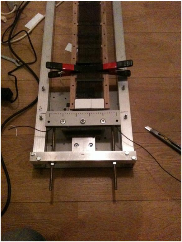

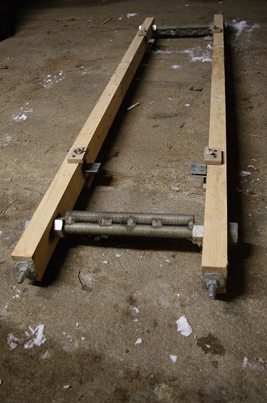

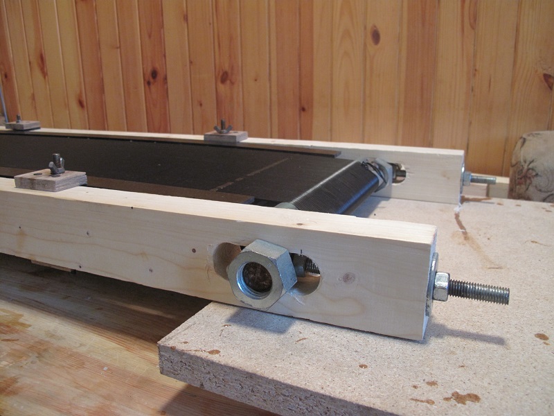

The two most common methods of spacing the wires is with threaded rods, or pins.
Bazukaz has posted a few pictures of his wire stretching jigs using threaded rods. Wire spacing is determined by thread pitch.
Two pics attached below, and a few links with additional jig pics(both rod & pin):
http://www.diyaudio.com/forums/planars-exotics/96020-esl-welding-rod-stators.html#post1134067
http://www.diyaudio.com/forums/plan...vre-panel-solvent-acoustat-2.html#post3722626
http://www.diyaudio.com/forums/plan...nel-efficiency-first-build-4.html#post3403359
http://www.diyaudio.com/forums/plan...stators-plastic-like-esl-57s.html#post3375308
http://www.diyaudio.com/forums/planars-exotics/71171-wire-stator-gluing-method-11.html#post3717541
http://www.diyaudio.com/forums/plan...sl-project-file-translated-5.html#post2249055
I chose to use pins rather than threaded rods so that I can have more control over the layout, adjacent wires are already attached to each other(no tedious soldering required), and I can include longer lead-out wires for connecting the segmentation resistors. Wire spacing is determined by pin spacing and pin diameter. Dowel pins work great for this application as they are strong and come in a range of diameters. Pics attached below show one of my pin stretchers before and after loading, and one from Wrinex.
If I remember correctly, it took about 30 lbs of force to stretch a single 22AWG wire, 50lbs for 20AWG. So, if your panel has 80 wires and you want to stretch them all at once the stretching jig will need to withstand 2,400 lbs of force for 22AWG and 4,000 lbs of force for 20AWG. The end blocks or threaded rods holding the ends of the wire will need to handle the force too. Each pin needs to handle the force for stretching 2 wires.
It takes a bit of time and thought to construct the jig. But once completed, it takes less than 15 minutes to string the wire between pins, stretch them, and have a perfectly insulated wire stator element ready for gluing to the stator frame crossbars.
When purchasing wire, I agree with Bazukaz that single strand (ie solid core) black PVC hookup wire is the way to go. I prefer crosslinked PVC insulation as it is a bit more resistant to physical damage from nicks or abrasions. Also, it doesn’t shrink back much at all when soldering.

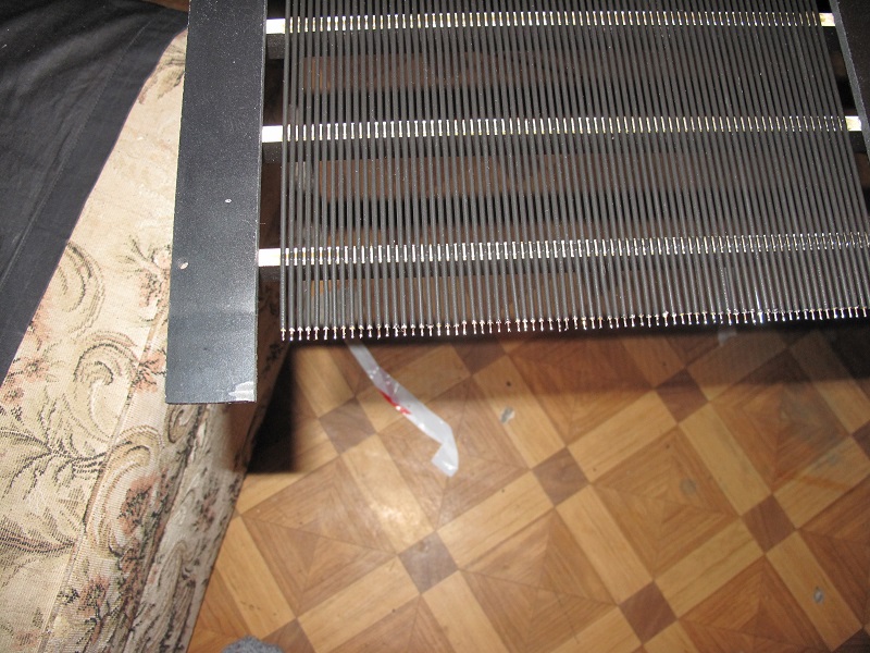

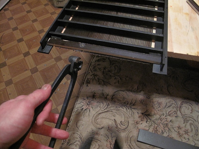

The idea behind using single core wire is to stretch it to plastic deformation zone. It then becomes extremely straight, and, depending on alloy and stresses applied, cold-hardened. Stranded wire is much more flexible , which is not a desirable characteristic at all.
Now if you take a look to photos bolserst have posted, two ways of building a wire streching machine are shown. The first one is by using threaded rods, one type of this kind I can comment in more detail. The operation is as follows :
a) Two stators are placed within wire strethcing jig and fixed there.
b) Wires are wrapped over both stators at once(so you end up with two stators sandwitched between wires). Then stretched to approx 2%.
c) Then wires are released so there is just enough tension to keep them straight
d) Glued or encapsulated to cross bars, depending on materials used. Both stators must be done at this step.

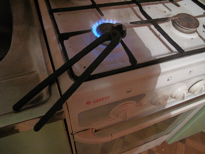

e) Wires are cut, and insulation cleaned from ends. Some pics attached how insulation could be cleaned by using hot pliers from lots of wires with ease. While the method looks crude, results can be surprisingly good.
f) Finally, top/bottom spacers can be fixed to ends of panel
g) Ends of wires are soldered as required by segmentation
Later I have started to use a different type of jig, which uses threaded rods as a guide for wires and special hooks to make zig-zag routing possible. It's somewhat different but also has similarities to both types that were described in previous post by bolserst.
Lukas.

2. With the entire Panel being wired with a single Conductor, are the individual segments created by cutting the wires at appropriate number of turns ?
Yes, that is correct. In the panel I wound in Pic#4 from Post#221 above you can see I positioned the pins further back for the wires I was going to cut for the segments. This made it so I could hook up directly to the ladder resistors without needing to solder in additional wire extensions.

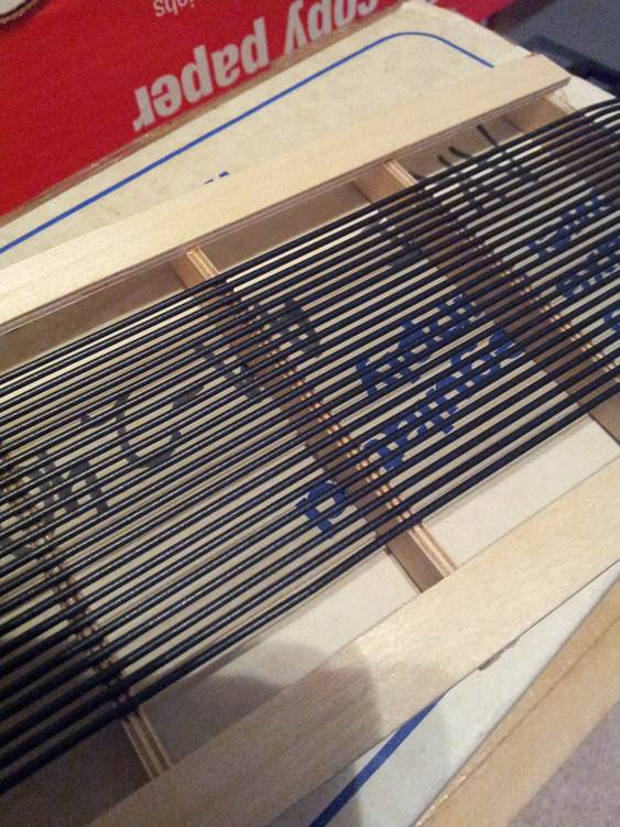

I often build test panels out of 5-layer 1/8"(3mm) birch plywood as it is easy to work with and readily available locally when I need a quick build. The only drawback I have found is that on larger panels, there is noticeable leakage current drawn from the HV supply, especially on humid days. I haven't tested it, but I think if only the crossbars are made from wood, and the spacers/perimeter mounting strips are made from better insulating materials, the leakage issue would go away.

Bolserst, I used plastisized wood for my cross bars, the bars I made were 1/4" sq about 11" long, each bar had 80 holes drilled into it to secure the rods, these were done in a jig. Because of the amount that had to be drilled, I sat them at 16" centre's, but I found that on lower bass they started ringing, I'm in a dry climate, and it seemed to work fine. Also I made the stators removable by clamping the 3 units together, the DS is about .090 which made it easier to work with, I'm thinking about drilling more cross supports to set at 8" centre's, hopefully this will take care of the ringing. Any ideas or thoughts on this?

I used plastisized wood for my cross bars…at 16" centre's, but I found that on lower bass they started ringing, I'm in a dry climate, and it seemed to work fine… I'm thinking about drilling more cross supports to set at 8" centre's, hopefully this will take care of the ringing. Any ideas or thoughts on this?
When you use the word “ringing” I think higher frequency, but you mention the ringing occurs when you play bass.
Do you hear the ringing when you gently strum your thumb nail across the wires?
I think you are on the right track with the idea of adding more supports, 16” between crossbars is unusually large. One other option is to attach a rubber damping strip diagonally (ie top left to lower right) across each section of unsupported wires. This will minimize the ringing by distributing the resonance frequencies so adjacent wires aren’t humming the same tune. The above mentioned thumb nail test will give you a quick feel for how well it works, comparing one section with damping strip .vs. one without. I have seen this technique used on heat sink fins and some ESL stators (Dayton Wright?).
I'm wondering whether the leak path was from off the diaphragm into the crossbars and from there to the perimeter mounting strips-- or from the periphery of the diaphragm into the perimeter mounting strips.
I believe the leakage path is from the perimeter of the diaphragm to the mounting strip. I generally use a copper tape charge ring and mount the diaphragm with a 2 - 5μm thick layer of acrylic adhesive, the same adhesive used on the 3M foam tapes that are commonly used for spacers in ESLs built with perforated sheet metal stators.
From the standpoint of bias leakage currents, you could consider the PVC wire/wood crossbar stators to be fairly conductive, like a perforated sheet metal stator. So, the only insulation between the charge ring and the stators is the spacer and the adhesive. 3M Foam tapes are excellent insulators, wood and acrylic adhesive not so much. One idea I had to disrupt the leakage path to the wood perimeter strips and spacers was to simply put down a thin insulation layer on them(ie Mylar transformer tape) before attaching the diaphragm/charge ring and assembling the halves together…just never got around to trying it.
One other concern with wood is dimensional stability during changing humidity, which directly affects your diaphragm tension.
