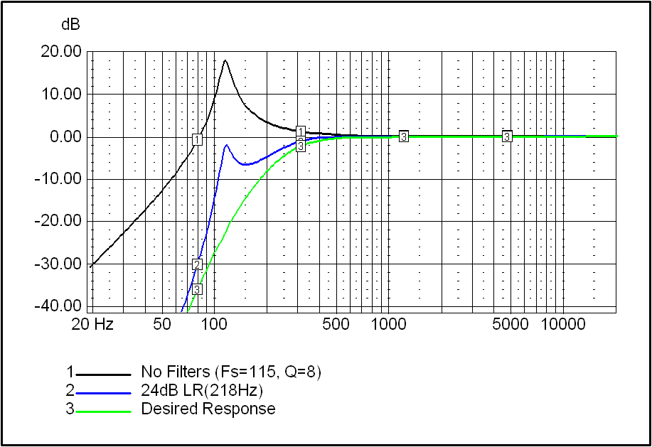

Have you determined the resonance frequency?The problem now is that I hear the diaphragm resonance, which is quite bothersome. Tomorrow I will try increasing the crossover filter slope from 24db to 48db/octave and, if need be, raise the x-over frequency from 218 to 250Hz to mitigate exciting the resonance.
BTW Congrats on completing another very nice build 🙂
That is certainly one advantage of using the active EQ, you can more easily fix any response slopes or dips with a few button clicks rather than having to modify some of the resistor values.
The diaphragm is tensioned pretty high. To find the resonance I downloaded a tone generator App to my iPad and used its tiny speaker to excite the diaphragm while I listened with my ear on the panel. The Ipad's speaker is so small I couldn't even hear it until the tone sweep got above 80 Hz and it rapidly got louder going up. This made the task a bit difficulty buy I'm pretty sure I heard the diaphragm's resonance peaking around 115 Hz.
...I'm pretty sure I heard the diaphragm's resonance peaking around 115 Hz.
Did you have the bias supply powered up at the time you performed the test? Remember Fs (resonance frequency) will be reduced as bias voltage is increased. To make it easier to hear, you could run a patch cord from your iPad headphone output to the the input of the amplifier driving the panels. Just be sure you have the volume on the iPad turned down before you start the test. I often do this with my cell phone.
If your diaphragm resonance is 115Hz, that is just an octave away from your crossover point and my guestimation is that it would have a Q of about 8.
Attachment #1: shows the response without and without your 24dB LR(Linkwitz-Riley) HPfilter set at 218Hz. You can see that the diaphragm resonance puts 20dB more output at resonance than the target filter response.
Attachment #1: One way to fix this is to add a notch filter to the signal path in your active crossover. You have the DCX-2496, so you should be able to add a 115Hz EQ filter with Gain = -20dB and Q=8. This will cancel out the primary diaphragm resonance and leave you with the desired response. I plotted a couple other curves to show that even if you miss the exact frequency by +/-10Hz you should still have a very workable crossover response.
NOTE: You should probably test each panel as they may have slightly different Fs. Also, as Bazukas mentioned, since you used mechanical tension method with no heat annealing the Fs will likely decrease over the course of 6 months as you play the speakers. You may want to check the Fs later in the year to see if they have drifted.
Alternatively, you could attack the problem acoustically by adding some damping fabric to the rear stator as golfnut suggested. In your case, I would think a layer of thin crafting felt would work great. You can get it cheaply at most fabric stores. You might consider leaving a 2" gap running down the middle to leave the segment handling the higher frequencies free from potential filtering affects. One nice thing about acoustic damping is that it does not require tuning for a particular frequency. It works just the same even if Fs drifts.

Glad to see I was kinda on the same page with you on a fix.... last night I upped the X-over frequency and slope to 250Hz/48db and then applied a narrow -12db parametric EQ at 112 Hz and it tamped down the resonance quite nicely.
And this morning I did a time alignment with the DCX and some fine tuning with the DEQ and now these panels are sounding exquisitely good.
