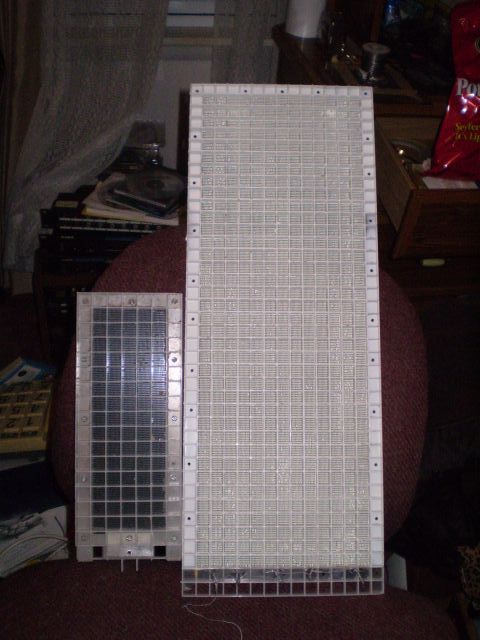

Here is a picture of the two different sized panels I was referring to in my descriptions and my new segmented design that is the same size as my smaller original panel.
jer 🙂

…When the resistor network delay networks are switched in, the egg crate panels project a much wider sweet spot and their sound, as heard from the focus, seems to emanate a bit less from the space between the speakers and a bit more from the speakers themselves.
Interesting to hear your subjective comparison between the two. I wondered how it would compare with mine, but hadn’t shared because I didn’t want to provide any preconceived notions of what you might hear.
1) Did you feel the specificity of the image was different? (ie how pin-point was the image)
I recall that when listening to un-segmented panels, some pan-potted vocals/instruments could sound distractingly pin-point rather than of realistic size. In general the segmented panels provided more natural imaging like what I hear if I closed my eyes and listening to someone talking to me while walking back and forth between the speakers. A friend of mine likened the un-segmented imaging to turning on the “vivid” mode on some plasma TVs, making things look “realer” than real. Impressive in the short run, but unnatural and tiring to the senses after a while. Definitely open to personal preference though, as many people enjoy “vivid” mode.
2) Did you feel the depth of the image was different?
3) You mentioned sound coming from the speakers more…do you think that was the case?
Is it possible you were hearing more sound coming from the sides of the room(not the panels themselves) than you were used to after a few years of listening to highly directional panels? Or, perhaps a slight difference in the overall EQd sound?
In any case, this is definitely a difference between your experience and mine. I found the exact opposite to be the case. Often high frequency transients would seem to cling to the un-segmented panels while floating free from the segmented ones. Overall though they both did an amazing disappearing act, giving you the impression you could get up and walk around the stage with the performers. Speakers? what speakers. 😉
… Very similar except the treble end doesn't need as much boost in the narrow mode (as it beams at you). Both modes need some boost to offset the dipole roll-off-- down to where the woofers kick in
Is the EQ shown just for the ESL panels? Or is this for the overall speaker placed in line upstream of the electronic crossover. Oh, that looks to be a DEQ2496…I thought you used the DCX2496. Or are you using both?

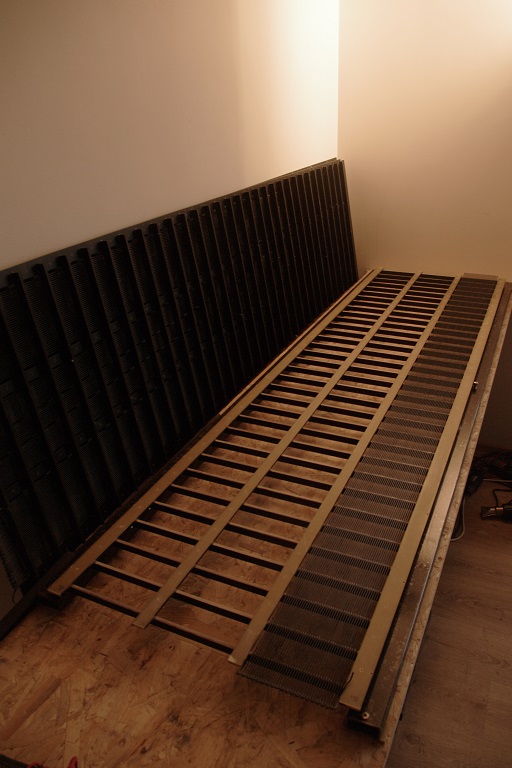

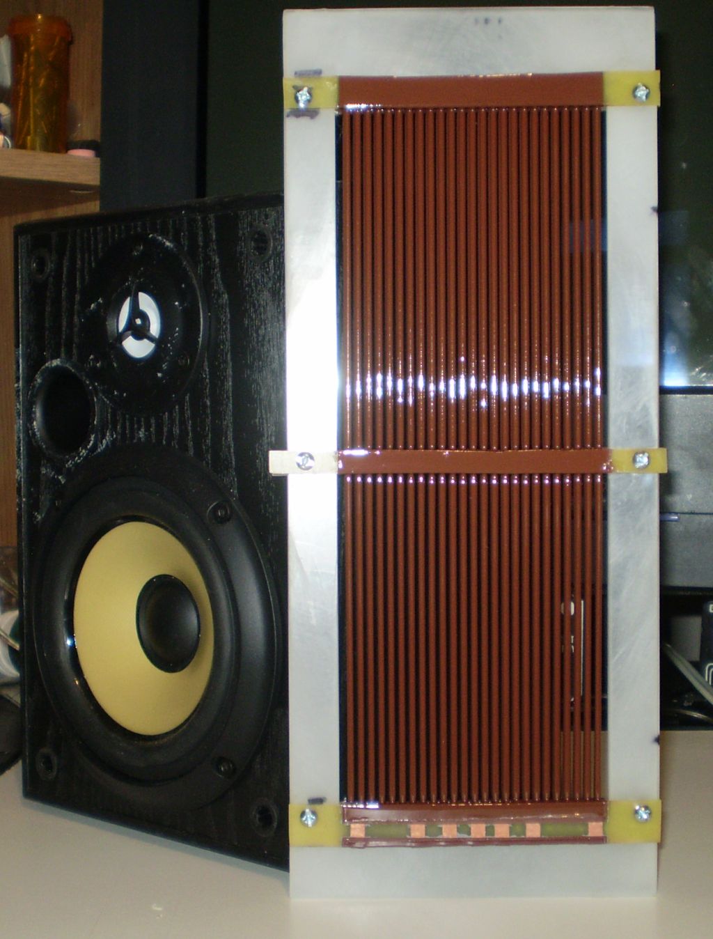

Personally I prefer ladder-like structure. Of course it's only viable if one could order pre-cut horizontal supports or there is a simple way to machine them with high precision.
In my opinion MDF is not optimal choice due to it's water absorption and mediocre dimensional stability. Acrylic, in turn, could develop micro cracks after machine cutting which could spread during time. But this has to be experimented with, as there are many materials which look very similar but have very different resistance to cracking.
Lukas.
Lukas.
Hi Lukas,
I agree with you on both the counts reg. MDF & Stress Crazing of Acrylic and other Glassy Polymers. One may be able to mitigate the former with PU and other Coatings and later with properly stress relieved stock and careful post machining annealing. I have some experience with it.
However I wonder if it is possible to use Ladder Structure with TIG Welding Rods as I find it easier in my mind.
Jayant
I prefer the ladder type construction when using TIG rod.
Using .062 dia rod has much rigidity hardly any frame support is needed at all!!!
I am sure that it will be less using a smaller diameter such as .045 and even less with .032, but, it will not be so bad compared to older methods using pure copper wire.
This is the reason I had started using it in the first place back 2005.
There are several pictures of the TIG stator's to my unfinished set in these threads only they are not segmented.
The TIG rod supplies nearly all of the rigidity and support for my desktop model and my three pairs of 11" x 36" pieces using .062 rod.
1 to 3 center supports is all that is needed for the 36' length.
The last set I made only has 3 supports at a 9" spacing and it is way more than enough rigidity.
I am thinking only 1 or 2 center supports would be sufficient considering I soldered the whole thing together and burned up a soldering gun by the time I got as far as I did.
I would have built a jig and used some real heat had I known what I was doing at the time.
Back then the segmented design was in my head but I didn't quite understand the theory yet and was why they ended up as whole large panels instead.
Being that the rod diameter increased by some .015" to .025" when it is coated .045" diameter rod seems to be the best compromise with a smaller size and decreasing rigidity.
Although I have not tried any smaller diameter rod I plan to do so once I use up my .062 stock.
I am thinking of new larger build now to use up the two sheets of lighting crate that i have.
It will be of a frame style, cutting out large center area's and the frame will be as one whole piece.
Then I will box the framing using some super glue and some thin .020" flexible plastic strips (Mylar, Acetate) that I have a lot of that I got just for that purpose.
I used this method on my First designs that I have shown from 2003 and it works great!!
I did this becuase it was by far the cheapest method i could come up with at the time being a newbie and all, not to mention I used Alum. window screen for my stator material as well.
Much to my surprise they still turned out great!!
Using anything with more rigidity is always a big plus but there is also the effectiveness vs cost factor and was why I decided to use TIG rod vs Perforated Metal in my First large panel design.
I spent a bit over $200 in trying different materials and designs back in 2003 only to find the actual cost of good working panels were only $5 to $20 per pair depending on their size!!! He,he,he,he,he
And then........I was hooked for life...........!!! 😀
As far as the cracking issue is concerned maybe Lexan would be a better alternative.
I have a 3" x 1/4" x 48" piece of acrylic that I have been saving for a nice set of small clear panels and after sitting in the garage the last 10 years it is all cracked up too, and looks very ugly now!! :/
FWIW
jer 🙂

I see there lots of people started using TIG welding rods. Perhaps this is mainly driven by cost and assumptions that building process is easier(at least initially). This may be true for smaller panels, or if you don't mind that stators are not insulated. For a large panel insulating those TIG rods may become a major and significant problem, both in time and cost. The insulation must be defect free, resistant to cracking and should not sustain fire by itself. Therefore PVC insulated wire seems to be a better approach overall, both in terms of reliability and safety. Of course, the decision is yours.
Lukas.
Lukas,
Your comments appreciated and looking at Charlie's log you can see the TIG rod construction was a real pain. Spraying anything may work but is clearly not an "engineered" approach with predictable results and consistency.
Can you or other members offer a documented solution giving wire guage, covering and spacing to achieve same equivalent open area. This would be a real help to those of us with lesser skills.
I use H05 single core, black wire that is used for common installations. It's rated at 300/500V but practice shows this seems to be enough. I have never had any instance of arching of any wire panel I have built, even under relatively harsh conditions.
When choosing wire, I buy some samples from different manufacturers and use one which appears to have stronger and better quality insulation.
H05 is good for D/S spacing in the range like 1.5 mm and up. This works best with larger panels.
For smaller stator to diaphragm spacing you may want to use thinner wire, say outer diameter in the order like 1-1.2 mm. My proposal for open area is in the order of 30 to 40%.
In any way the core should be solid(with exception being light louvers with small holes), and insulation PVC.
Also keep in mind that panel size has a very significant influence on SPL. Double area and you gain at least 6dB, assuming conditions like D/S spacing, voltages etc. are kept the same
So first you have to decide panel size, D/S spacing and other factors. Then choose wire.
Edit : when using wires you will not get away without building a stretching tool to get them really straight. Threaded rods are very useful in building such a tool.
Lukas.
