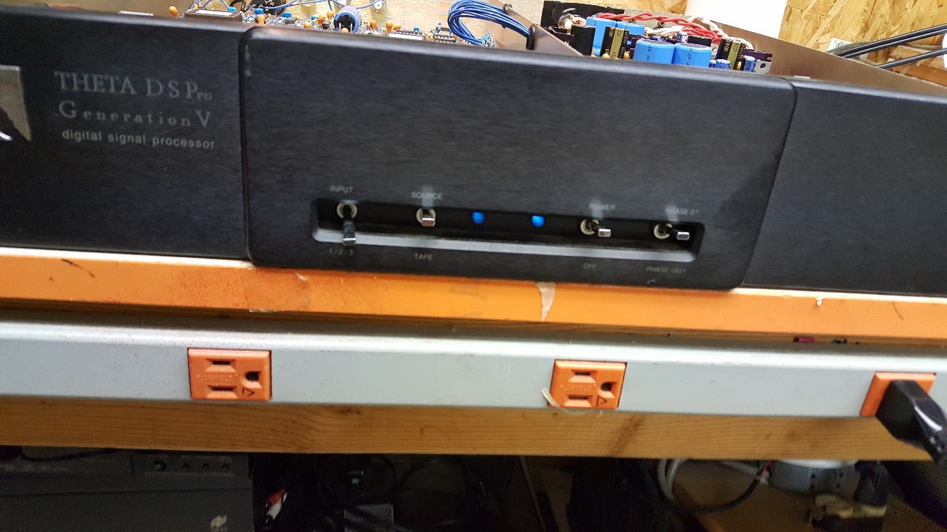

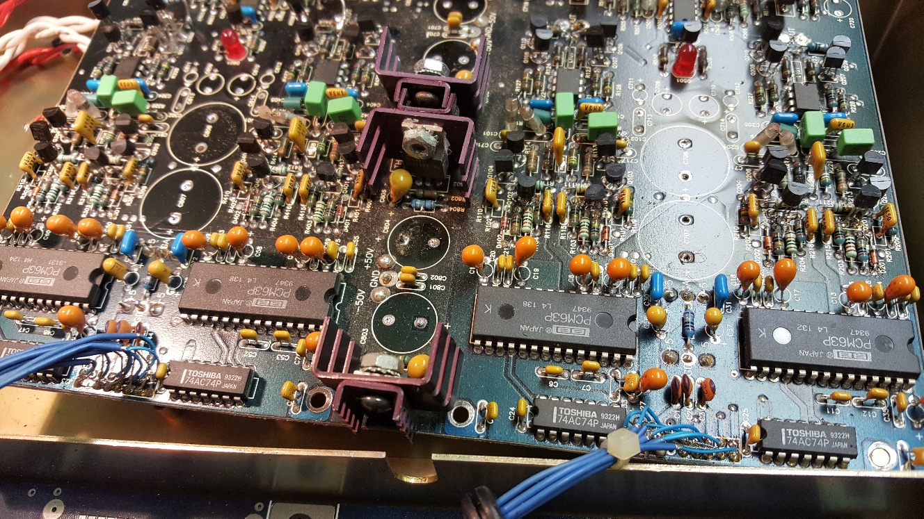

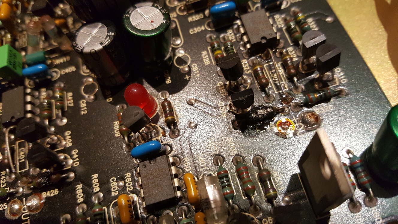

I picked up a Theta Gen Va DAC today and once I turned it on it failed on the left analog output stage. I pulled the plug and opened it up and noticed Q309 (MPS8099) has failed & adjacent resistor R325 burned up (+ Side of Differential Left Output). I also noticed R426 (still measures 10 ohms lol ) which is associated with the - (Negative) Side also burned up & the associated transistor Q410 (MPS8099) looks physically good but measures off spec.

Someone plugged in a fast IC
The in-series coil was also removed -> bridged-out (to "improve" the sound)
The IC was oscillating wildly while the transistors were open (stop mode), large hi freq current ran from Vcc/Vee, through the IC's and then through the second muting transistors CE, and the resistor, to the ground, resulting in burnt-out components. This is at least what I think had happened... a MOD gone wrong...???
Just replace the IC's, use 100-ohm resistors instead of the coils that were removed, and replace the muting transistors/resistors. Transistors could be any... (you could even use a single Darlington type with a bit of re-wiring underneath...)
If you remove the socketed IC's, burnt transistors and resistors, you will be able to confirm the Vcc/Vee
If you just replace the IC's and install the 100-ohm resistors in place of coils, the thing will work even without shorting (muting) transistors/resistors - the muting circuit can be added later, once you start hearing the sound again

It looks like almost every capacitor on the Analog board is shorted or opened up. 13 of 16 caps have totally failed (dried up/overheated) or are so far out of tolerance (ie 135uF vs 470uF rated capacitance for example) are non-functional as designed.

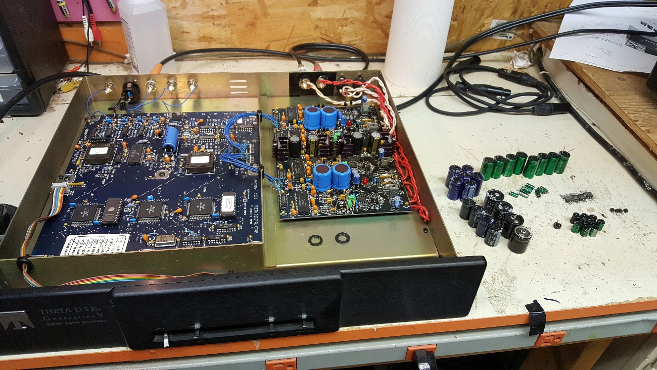

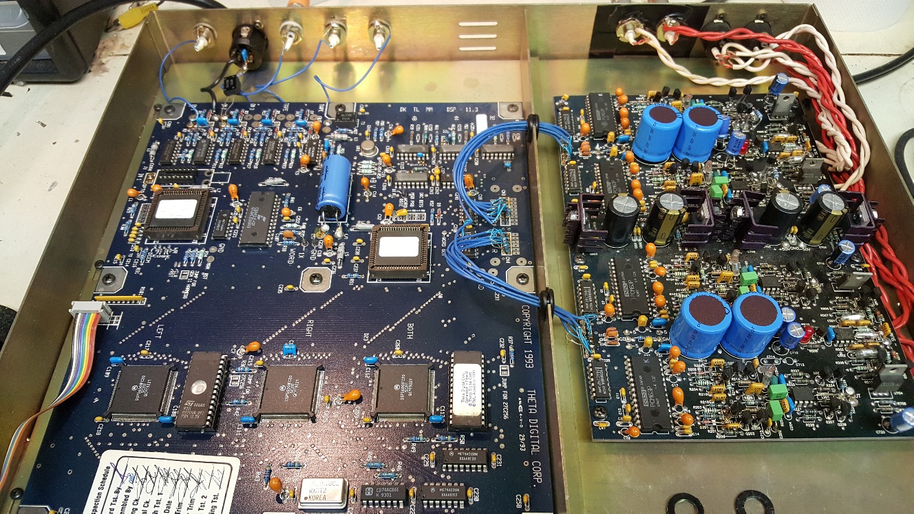

I recapped all of the electro caps as there were many failures on the Analog Board and some out of spec caps (smaller units) on Power Supply board.
It looks like the -30VDC & +30V (both regulated power supplies for the MPS8099/8599) had failed on one channel. One 1000uF 50V shorted and the other one opened up (lead separated from rest of body). This stressed one of the Negative regulator that measured really bad (120ohm from adjustable to output (after removed from PCB).
So I have a functioning Gen V Version A ( I thought I had bought a Gen V) but with the Green Wima caps/removed inductors at output & it looked like all the transistors were updated and matched. I assume I have the additional dither function that began with the Version A.
It has been running for an hour with no problems. Look at the attached photos that show the updated DAC and all the removed parts (mostly caps).

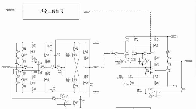

This is my physical drawing Theta Gen V output stage circuit diagram, I don't know if
Theta Gen V output stage circuit diagram, I don't know if it will help you.
