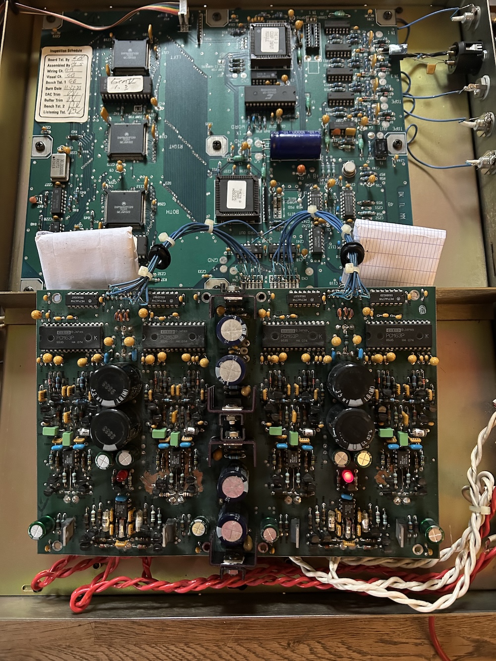

I've just bought a non-working Theta DSP GenV (symmetrical version, end of 1995). The only thing I knew before I bought it was that one channel was sizzling (not working) and one channel ok. I never had the opportunity to listen to a Theta product and I get tempted to have one along my ML36, Wadia X32, 16 and Krell KAV 300CD. To be able to compare, I needed one.
But before that, I've got to fix it!
Here's a picture of the Digital Input and DA conversion boards showing that only the left channel seems to be working (red led lit). The right channel isn't operational since the led is unlit.
We can see that there has been already some "work" done on this board. I guess someone had problems unsoldering and/or soldering components, particularly on the right channel (left side of the picture...). I've made some quick measurements on different places on this specific part of the board, just with the Fluke. No or almost no power near or around the - side of differential right output. The LM337 neg regulator is at 0V on pin 2 (I out), so are the AD707 AOP and the R203 10k resistor as shown below (part of a drawing I made to remember where all wires go - before unsoldering - and to make measurement easier):
I also checked some capacitors in circuit (before I can take that board out and free) and one of the 470µF/16V (C719) is notably out of specs with an ESR > 40 Ohm, couldn't check properly the other ones I prefer to take them out (and anyway I'll replace them all since this DAC is 30 years old and it's probably useful to have this done preventively). But before anything, I'll have to replace that capacitor and similars.

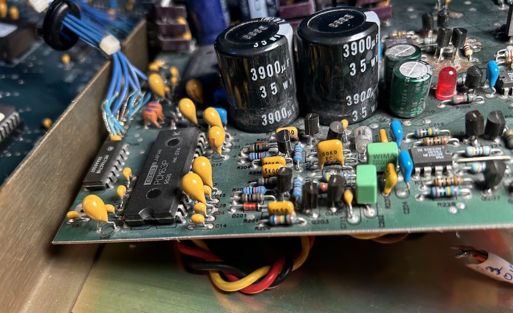

Could they be resistors? Do you have a close-up high-res pic? From the schematic it might make more sense.Some MLCC caps are written 10K0 or 5K00...
This is exactly the reason why i asked to measure these elements....Could they be resistors?
look at this:
photo posted by dtm1962 in post#18
I have marked in red the elements that raise our doubts
On the PCB they are marked as R, which means resistance!
Easy to check by DMM !
I think these are precision resistors, which explains their unusual values.

You're all so right! And I'm so confused to have missed that!
I never saw such resistors before and they looked so much like MLCC capacitors (small yellow drop cases) that I didn't even measure them. So I did 10' ago, and they are resistors, right!
So now my schematic is (nearly) completely wrong and I apologize sincerely to all for that stupid mistake!

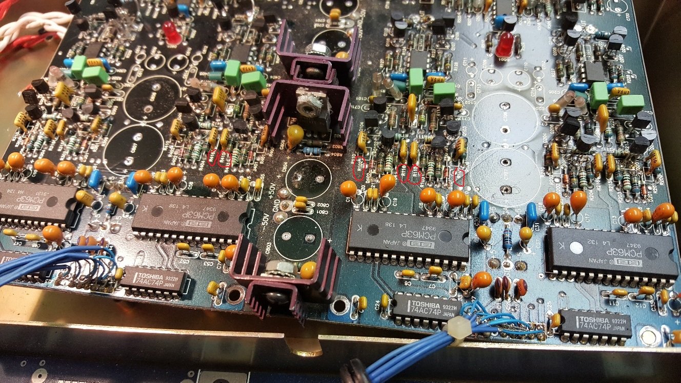

I add that I started to desolder the caps (1000, 470, 220µF...) and the 4 I took out were totally out of original values and ESR sometimes > to 40 ohm... So all of them has to be replaced, for sure.
I asked if the board was a teflon one because 1) it's much thinner and less rigid than the classical FR4 boards 2) the green mask is very fragile to heat. Not easy to take out components properly I must say, even with a Metcal desoldering gun. And the vias come out easily. Too easily ;(

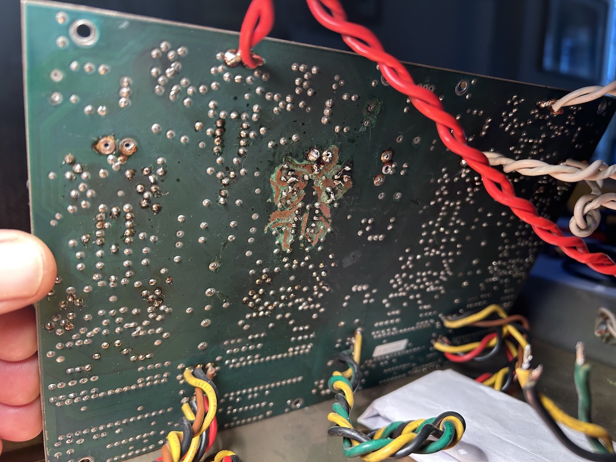

If you have a moment, could you take a picture of the PCB - the bottom side ?

Here is it Zoltan (and thanks for your thoughts, I appreciate):
You can see it has been already worked... I hope I can do no more harm to it.
