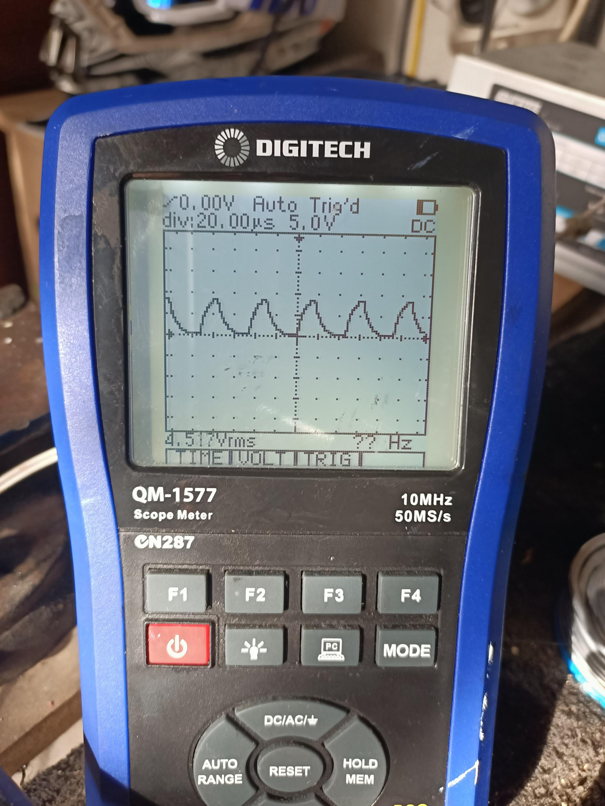

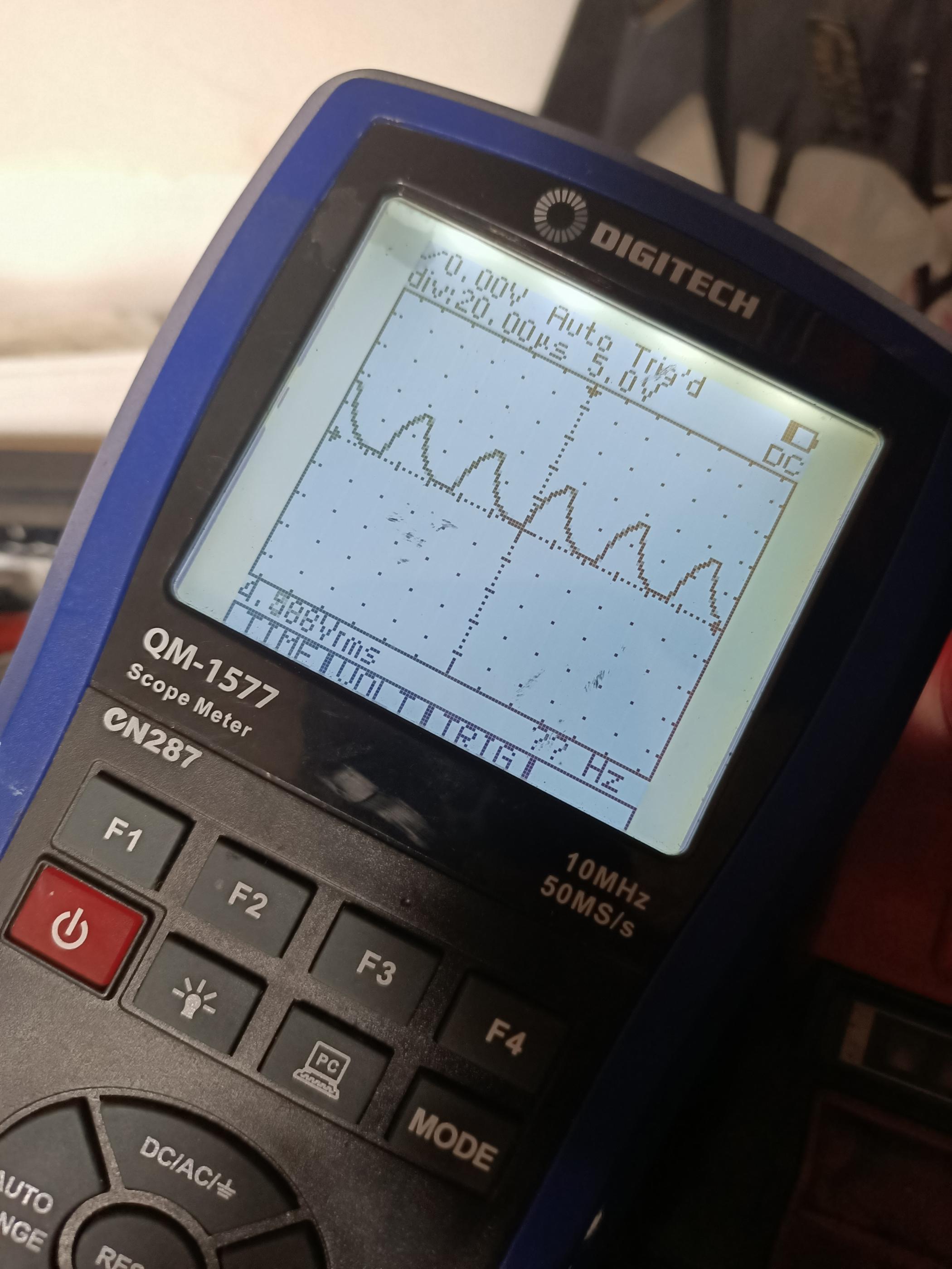

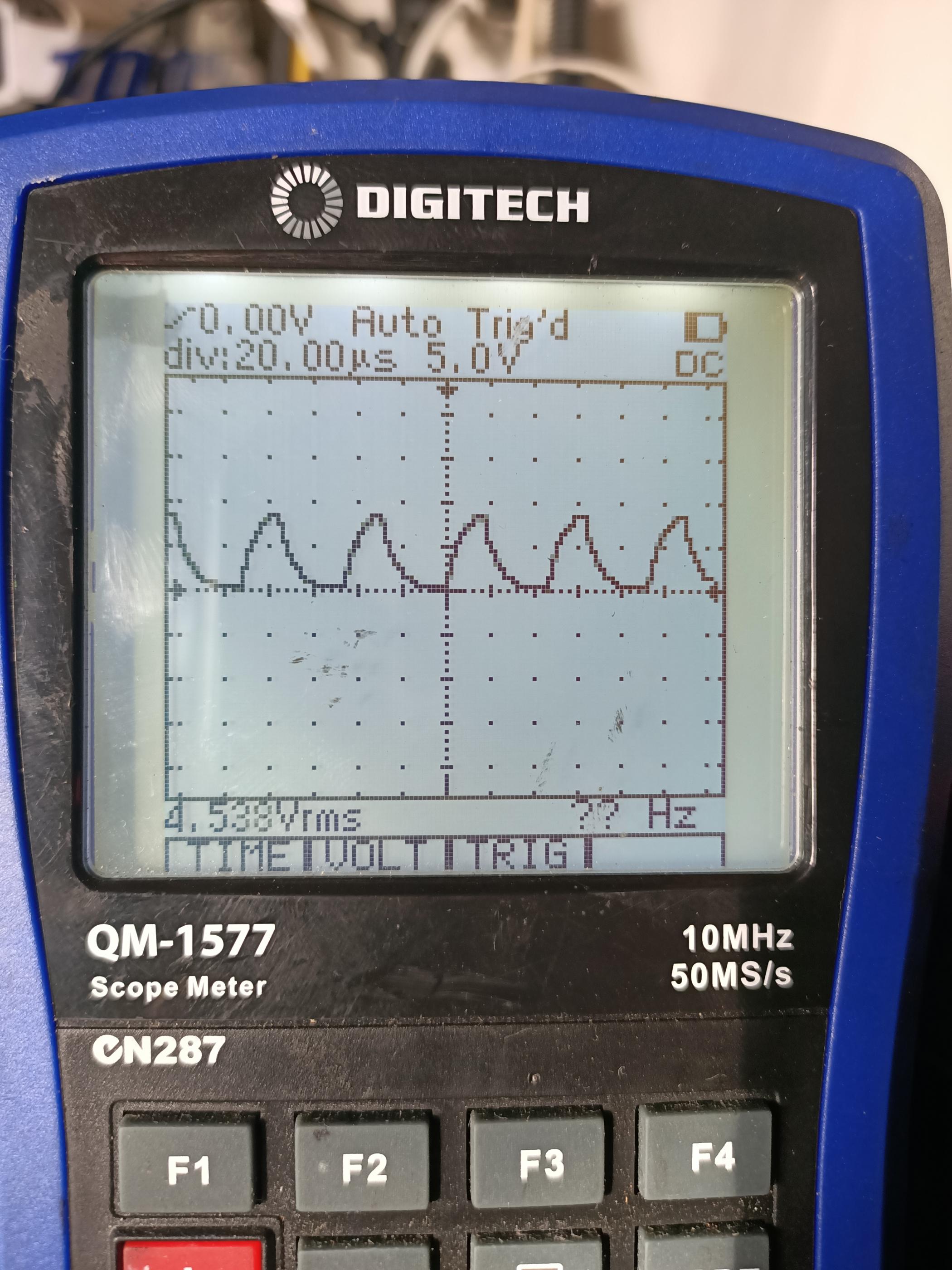

These class D drive waves look normal??

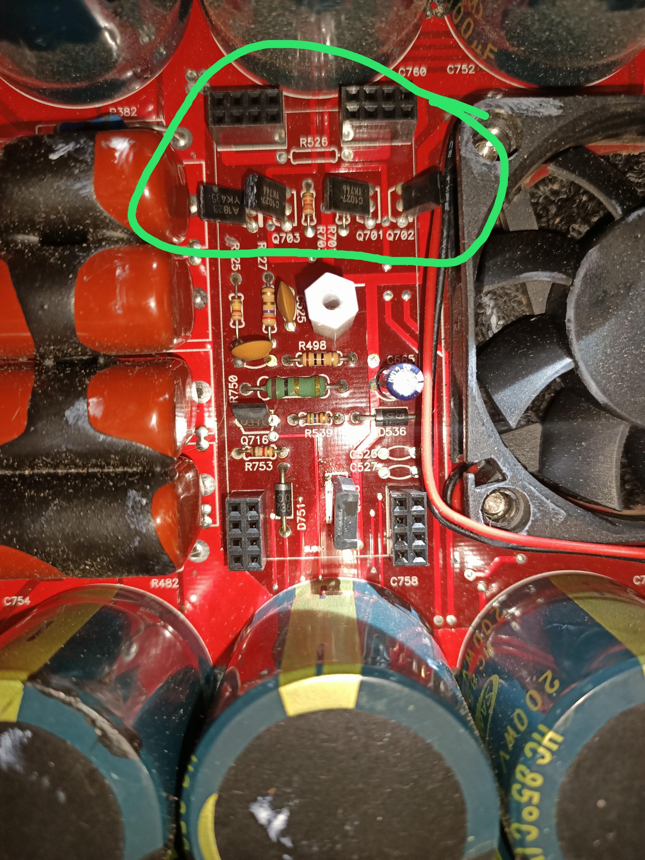

The center image appears that there is a diode in parallel with the gate resistor. That would be an odd configuration.
At this point, I'll say that it appears that there is a problem. Testing in this way generally causes all waveforms to look like the one on the left.

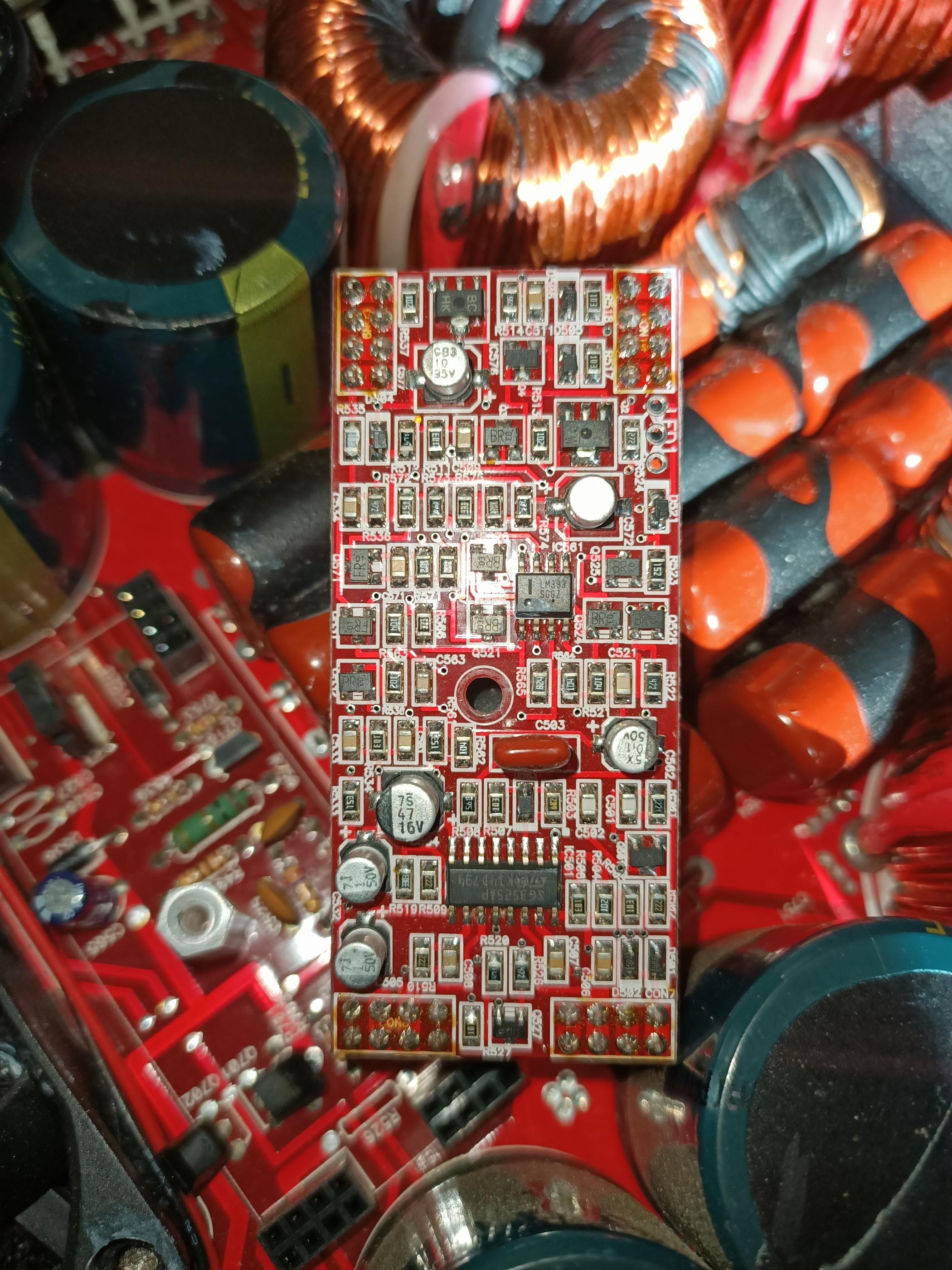

Without more information on the amp and the drive circuit, it's going to be difficult to offer any more suggestions.
What make/model amp?
HAve you tried to get the schematic diagram from the manufacturer?
For higher speed circuits like the output stage, yes. For the low-frequencies used in switching power supplies, they're not as common. I didn't see any in parallel with the resistors in the photo but mentioned them because it's possible they exist elsewhere.
The thing is, is that the two drive waveforms are different.

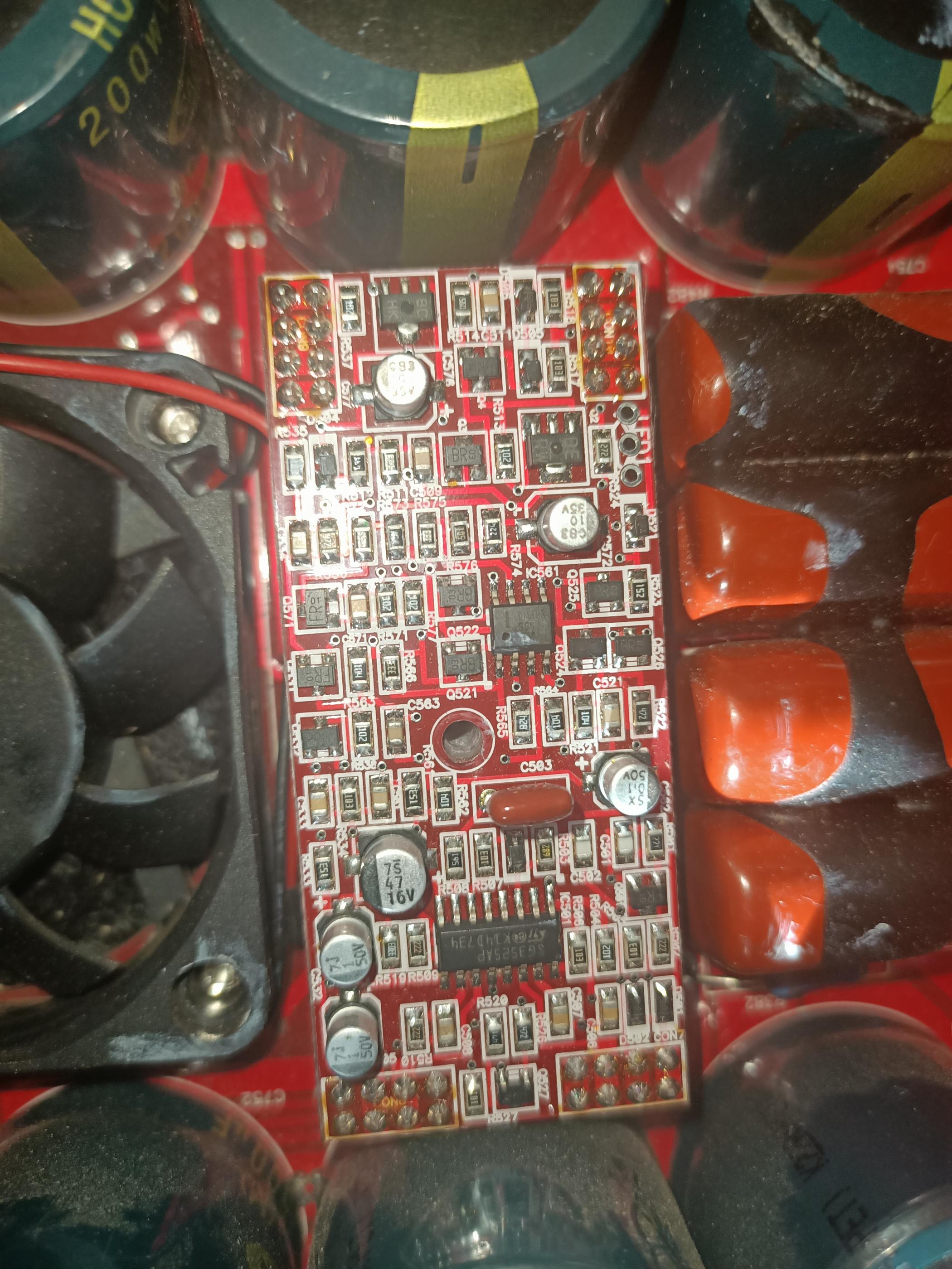

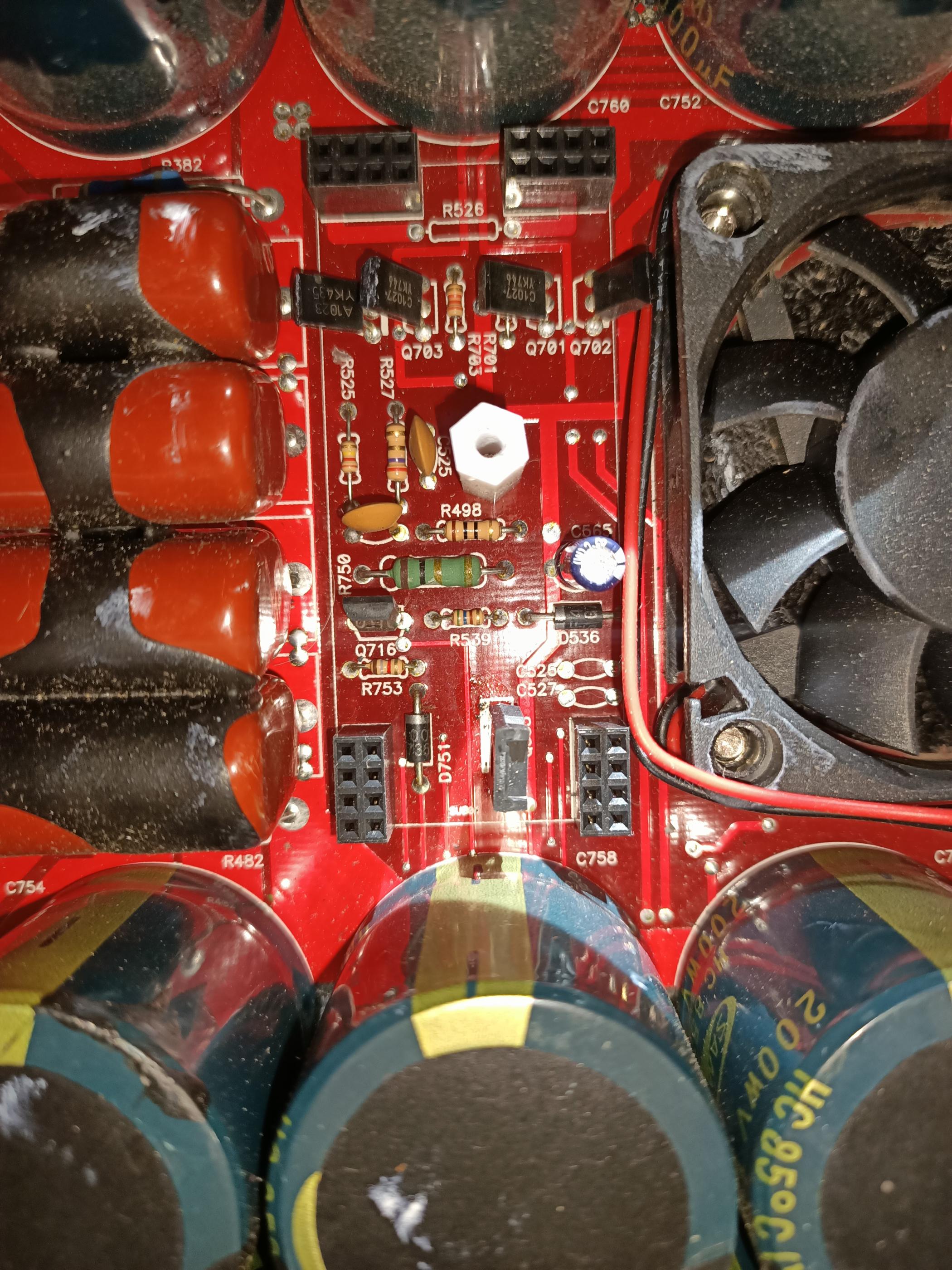

This is the driver
There are some NPN and PNPs under the board. But they check out are not shorted and visually look fibe

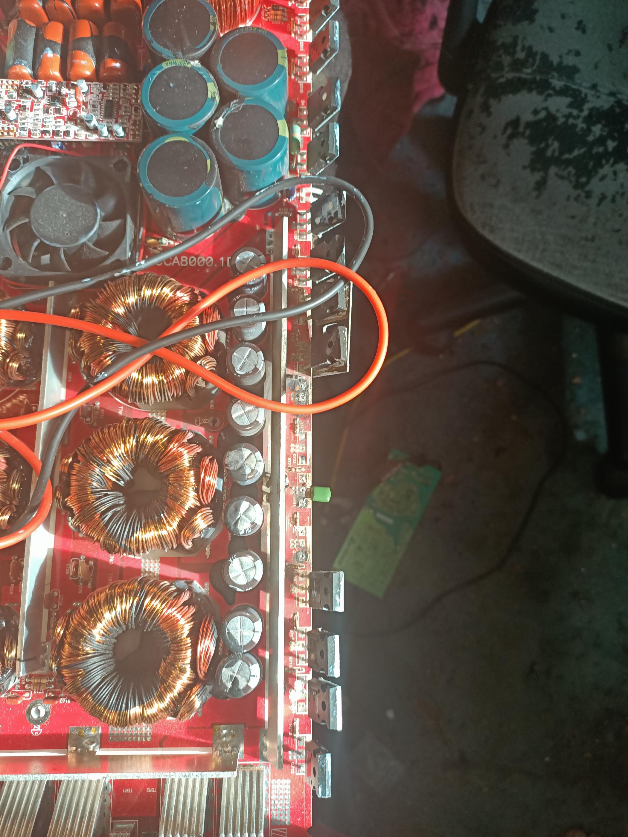

No the locations that still have fets are left as is. I only loaded the spots that are missing the fets with the cap
Q703. 701 702 704 are the buffers
I only have 1 cap so can only test 1 at a time and as 8 fets came out thats 2 banks of high and low
That's all locations missing fets with cap in. Same across the board. I just gotta go help a mate with a flat battery I'll check those other things u asked when I get back in like 15 mins

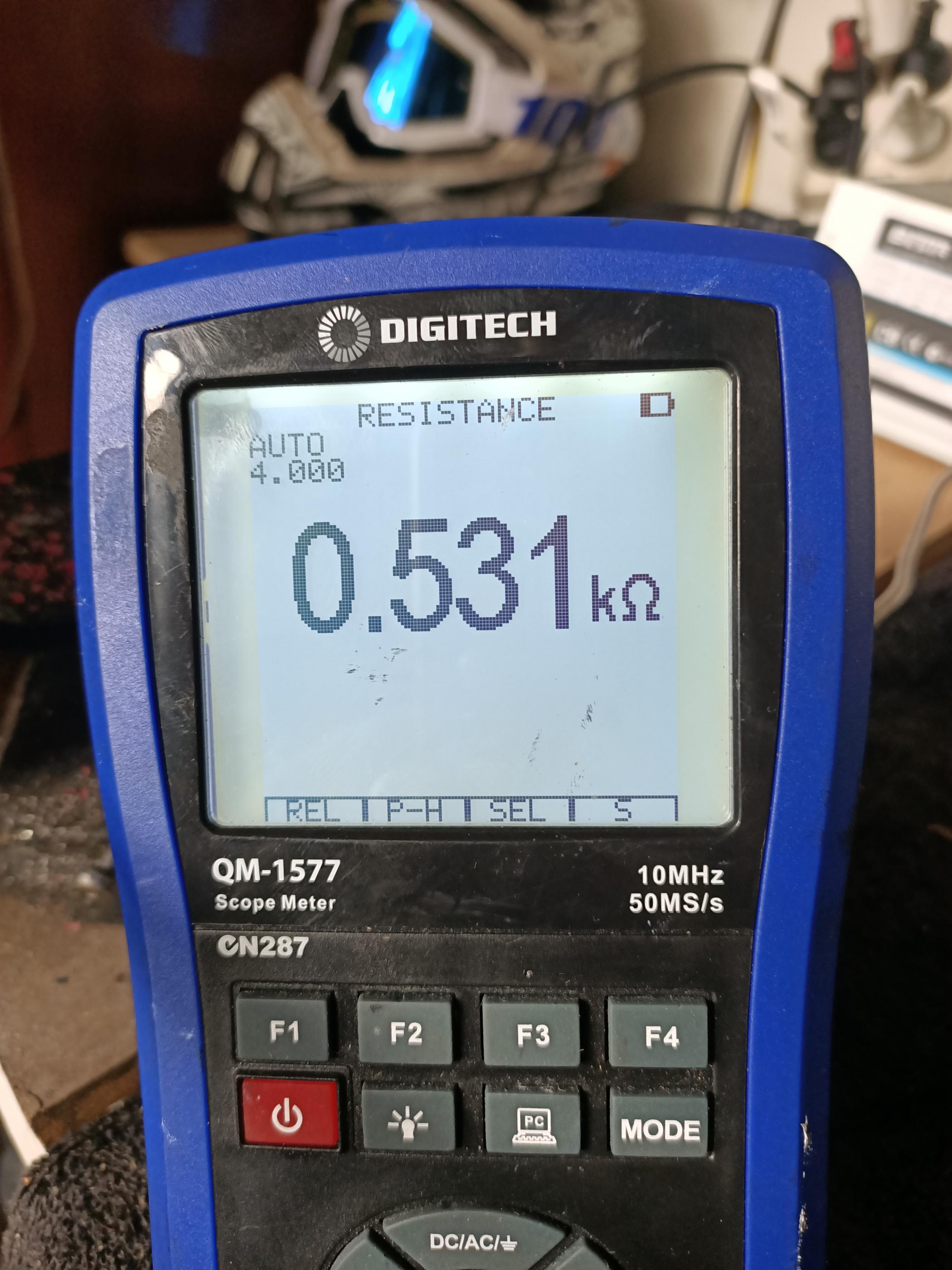

That's the wave on q273 with cap in. Also resistance between gates of q273 and q274
Like mentioned the gate resistors although they check fine at 265ohm have taken quiet a hit so will be swapping them when they arrive
