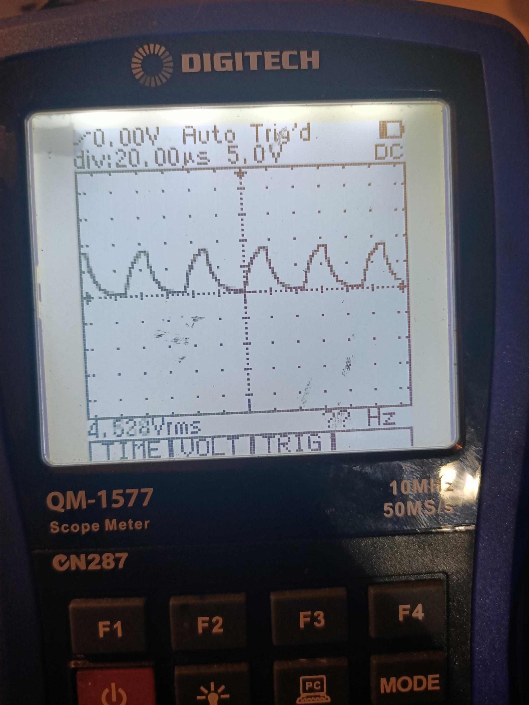

These class D drive waves look normal??
Hold up just found this. Will this be ok?

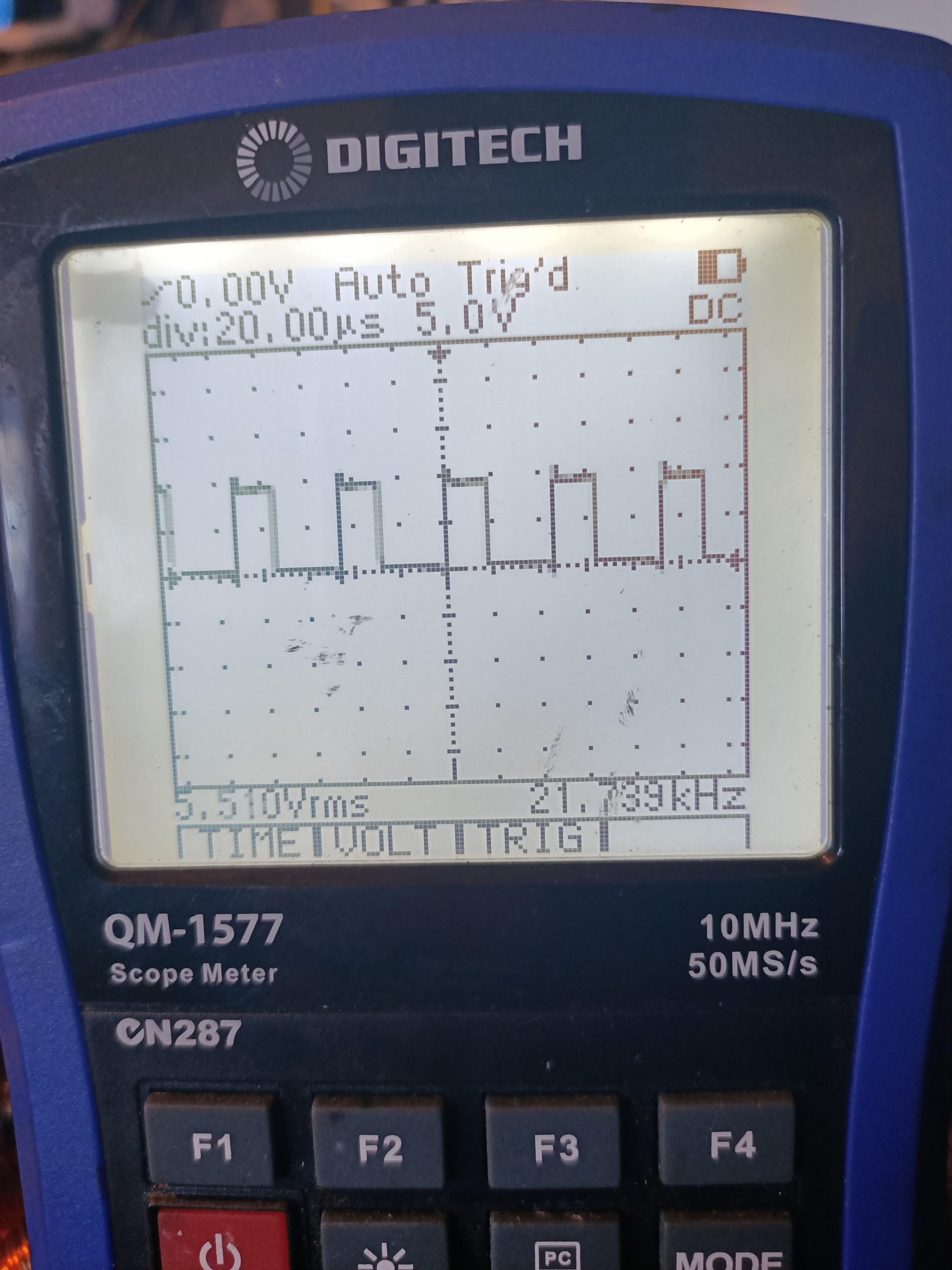

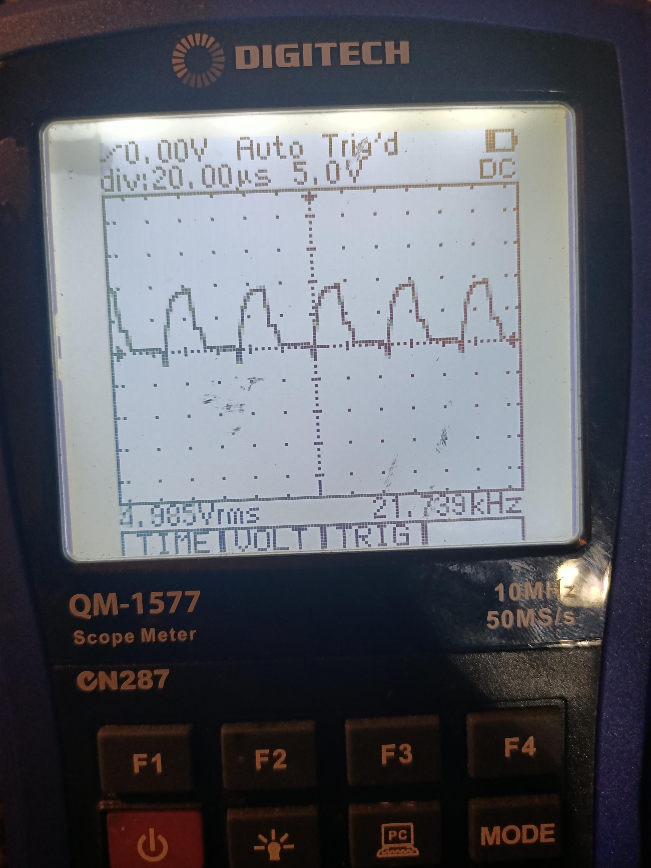

That's the drive waves now bank that's fine vs bank that was fryed. This is with the cap across GS. So I would think the driver is ok... The gate resistors took a hit but still read ok and same wave both sides of the gate resistors .
So now my thinking is change gate resistors and install new fets... Drive should then be perfect?
