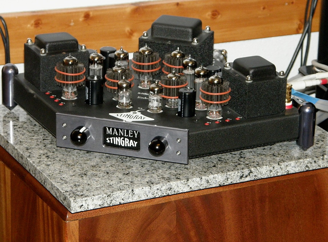

Yup, Got ahold of EveAnna Manley per email, and she said this was completely normal. just didn't want a surprise with these expensive Mullards. I know, I am still in the honeymoon phase, but the sound is to die for. I missed this sort of sound more than I even remember.

Thanks, one consideration might be to have one made out of the Manley in a separate chassis. Is that even a consideration?
Sometimes it is just the heater wire sticks out the top of the cathode and you see the turn-on surge more with these. There is a surge as the filament heats up and the resistance rises to it's proper level.
Inrush current limiting isn't a bad idea. Several 1960's era amplifiers commonly had inrush limiting. WHat it will do is long term extend capacitor life, along with heater life (but you normally drop in emmision before that is an issue).

I've seen toroidal power transformers fail from the mechanical stresses created by the inrush current. It takes a decade or two, but the insulation will wear through eventually.

I haven't seen that yet, but I'm not surprised at all. I strongly prefer E-I core transformers.
Actually, what you said about surge resistors is not true at all. It isn't uncommon for thermistors to burn out, they've been doing that for 5 decades or more! lol!
Size the fixed surge resistor correctly and they do not burn out, very rare event. If the relay fails to close they will. That can be an advantage as it limits other, more expensive damage.
