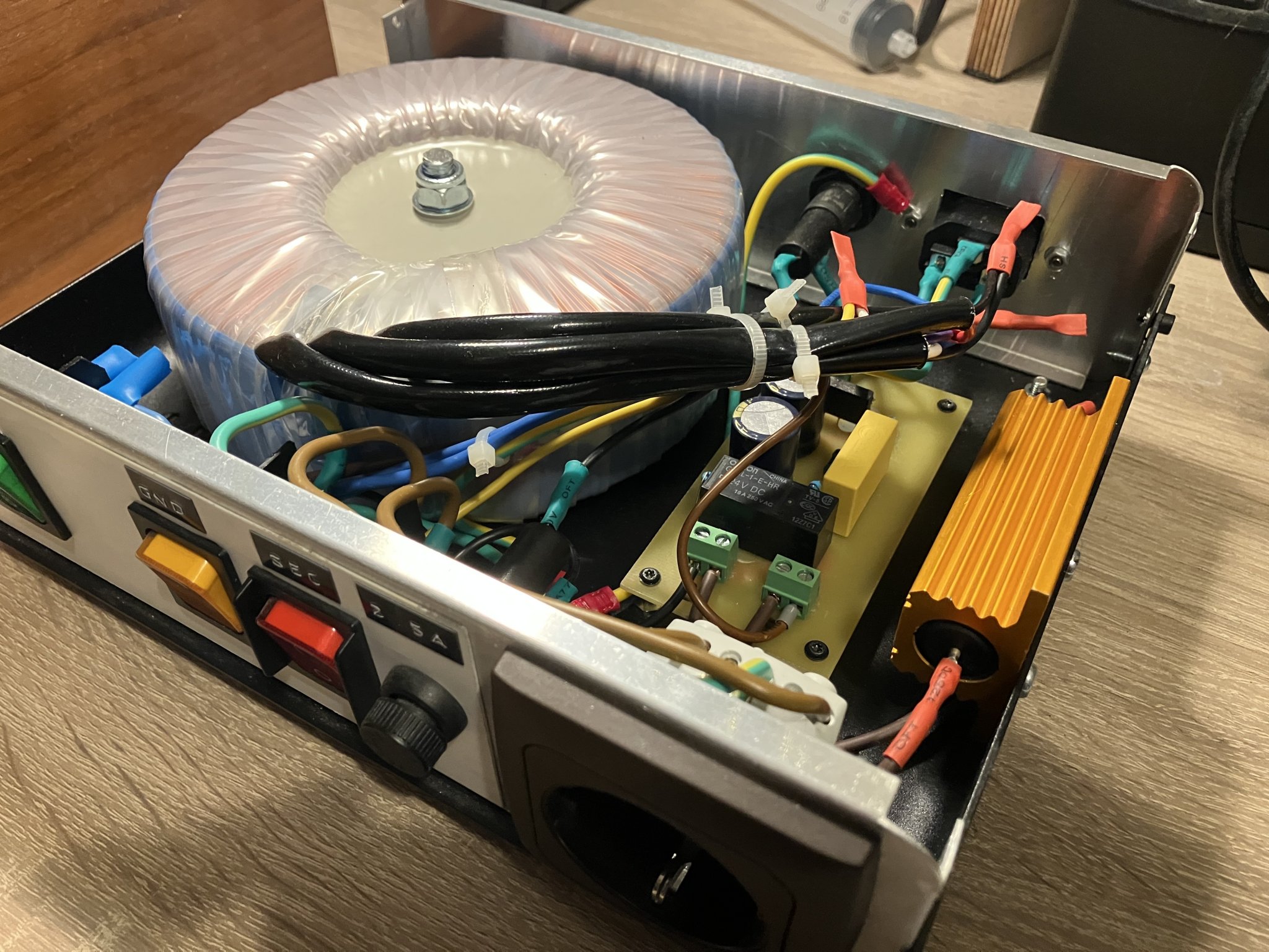

Couple of years back I've made a simple circuit board as soft starter that also shorts out a big resistor. Found this idea somewhere on the internet. It sits in a big isolation transformer thingy that I use to make my lab a little safer. Probably not even needed (its 500VA I think and that doesn't trip the breakers anyway). But still nice 🙂
Its not the prettiest but a very simple solution. It works with a capacitive dropper taken directly from mains and builds up a small charge across a couple of big caps. That prevents the relay from being activated straight away. When voltage reaches about 10VDC, the relay latches and switches on. I guess it has a delay of about 1 second or so.
I'm not too worried about arching of the contacts (because of the parallel big resistor) but I did use a DPDT relay and combined the contacts as a precaution.
- Relay is a 24V omron G5RL-1-E relay.
- electrolytics are both 470 uF
- MF cap is 0.33 uF, 275V. Be sure to use X2 and have a fuse in line (always good practice ti fuse these sort of things anyway)
- I used an oversized power resistor of 47 ohm (it can handle some power in case the relay fails).
- Don't mind the rest of the diagram, that's simply how i did the wiring inside this thing.
- There's some space to add a resistor in parallel over the coil of the relay so you have some control over the voltage across it. I forgot to put that in the circuit diagram.

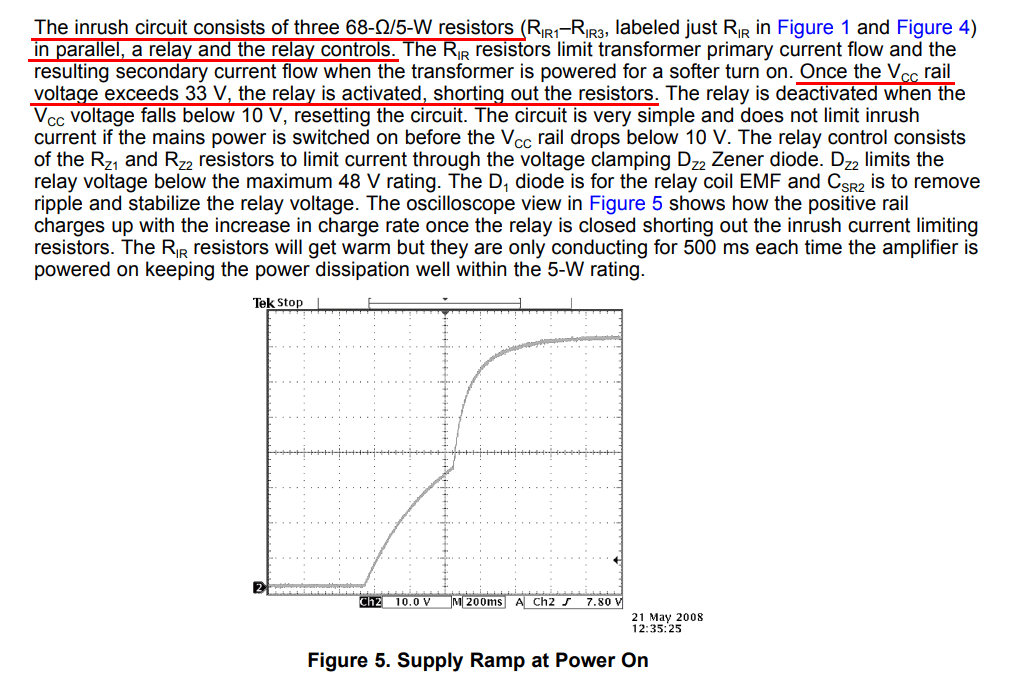

... a board called H9KPXG which includes both soft start, and also on/off control using a low voltage, low current switch. Schematics and PCB Gerbers are here on the Forum, just search for the board name.
tick the box which asks: search thread-titles only?
That part.NTC thermistors are better suited to tube amplifiers that have a higher steady state current as opposed to most AB transistor amplifiers that can draw very little current until you start delivering a lot of power (crank it!).
Thermistors need to get hot to have low resistance. In a class AB amp that doesn't get the thermistor hot enough, you'll have this series resistance that varies with how loud you crank the amp. Like a very long time-constant dynamic range expander, as the amp will be able to deliver slightly higher power as the more you crank it.
In my experience, NTC thermistors are less reliable than wirewound power resistors used in soft-starts.
Many soft start PCBs short out the inrush current limiter when the inrush event is complete. Series resistance drops to zero ohms whether the amp is drawing big currents from its power supply, or small currents. Here's how Texas Instruments describes it in their application note AN-1849 (image below). Both Douglas Self's power amp textbook and Bob Cordell's power amp textbook, recommend this short-it-out procedure. The H9KPXG design includes the idea, giving it the name "bypassing" the inrush current limiting resistor.
